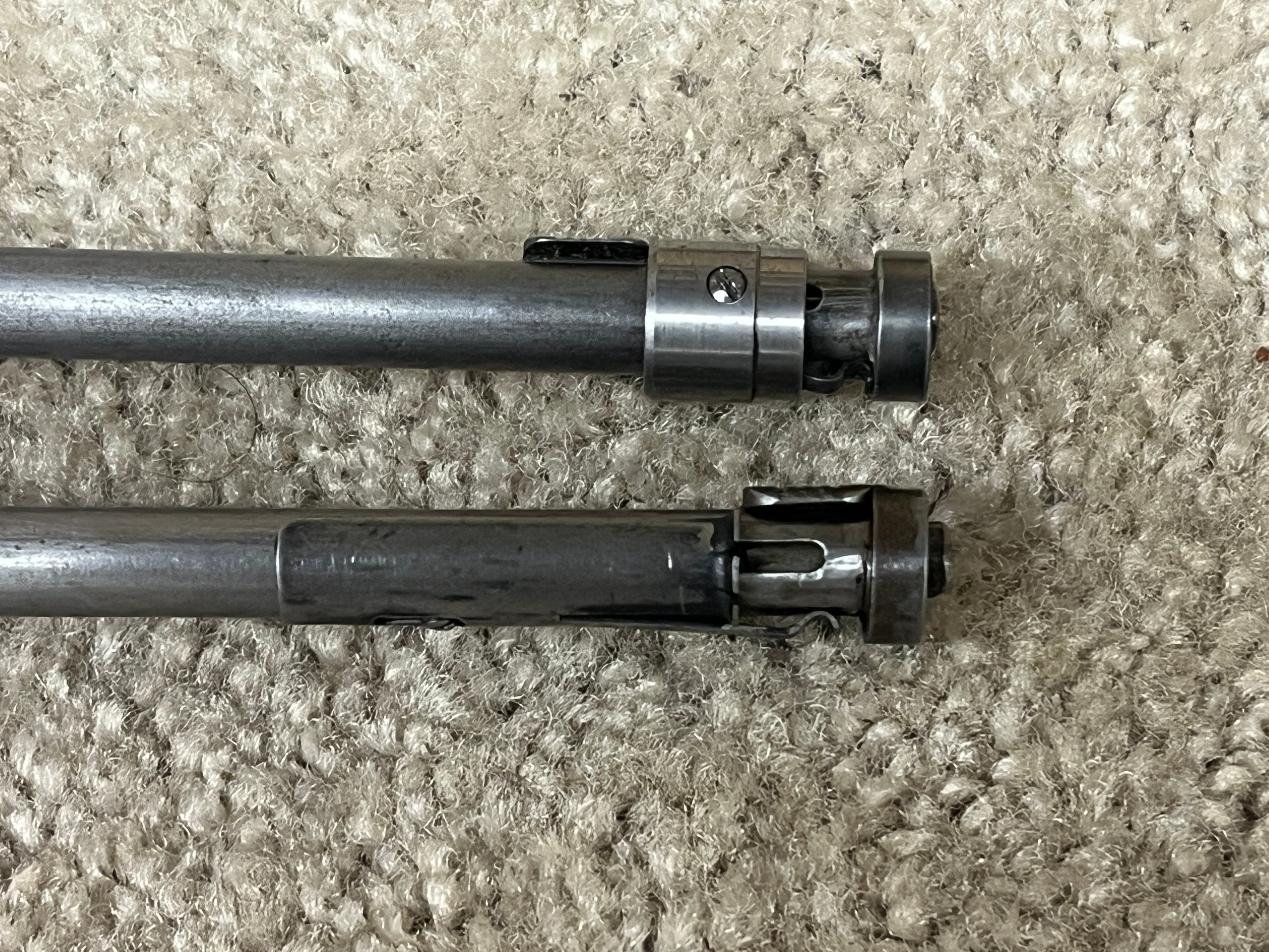

Gordon has the two reversed. If you look at the 1884 catalog page in his book you can see its the early style. Here is a picture of the two. The upper one is the early one  and the bottom is the later style that was introduced in March of 1898

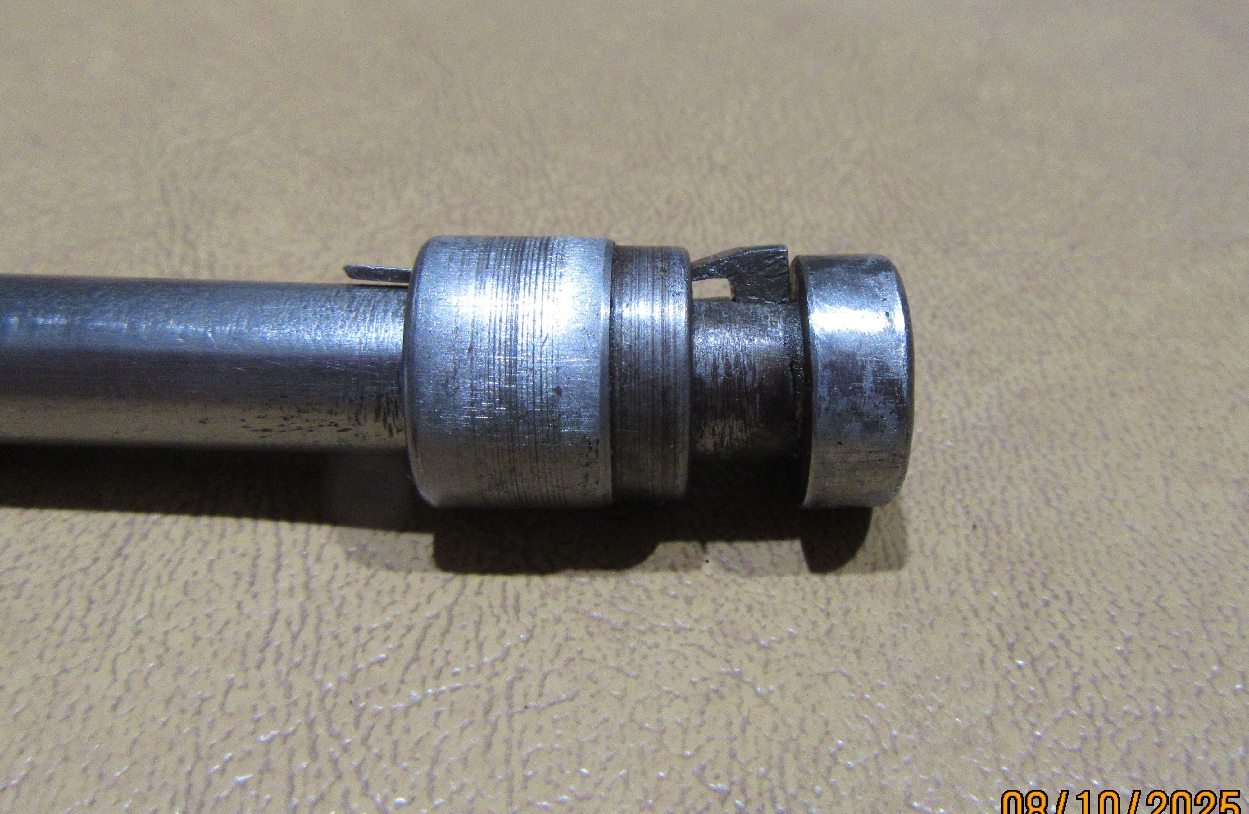

I agree, the early one had two catches one like a bent hair pin the other made out of solid metal. When I got my gun with the early style magazine it didn’t have the catch. I found guns with both style catches. I tried making the bent hair pin one & had no luck, so I made the solid style & it works fine.   Gail

I made one of those but I had one to copy.

Looks fine Bob.

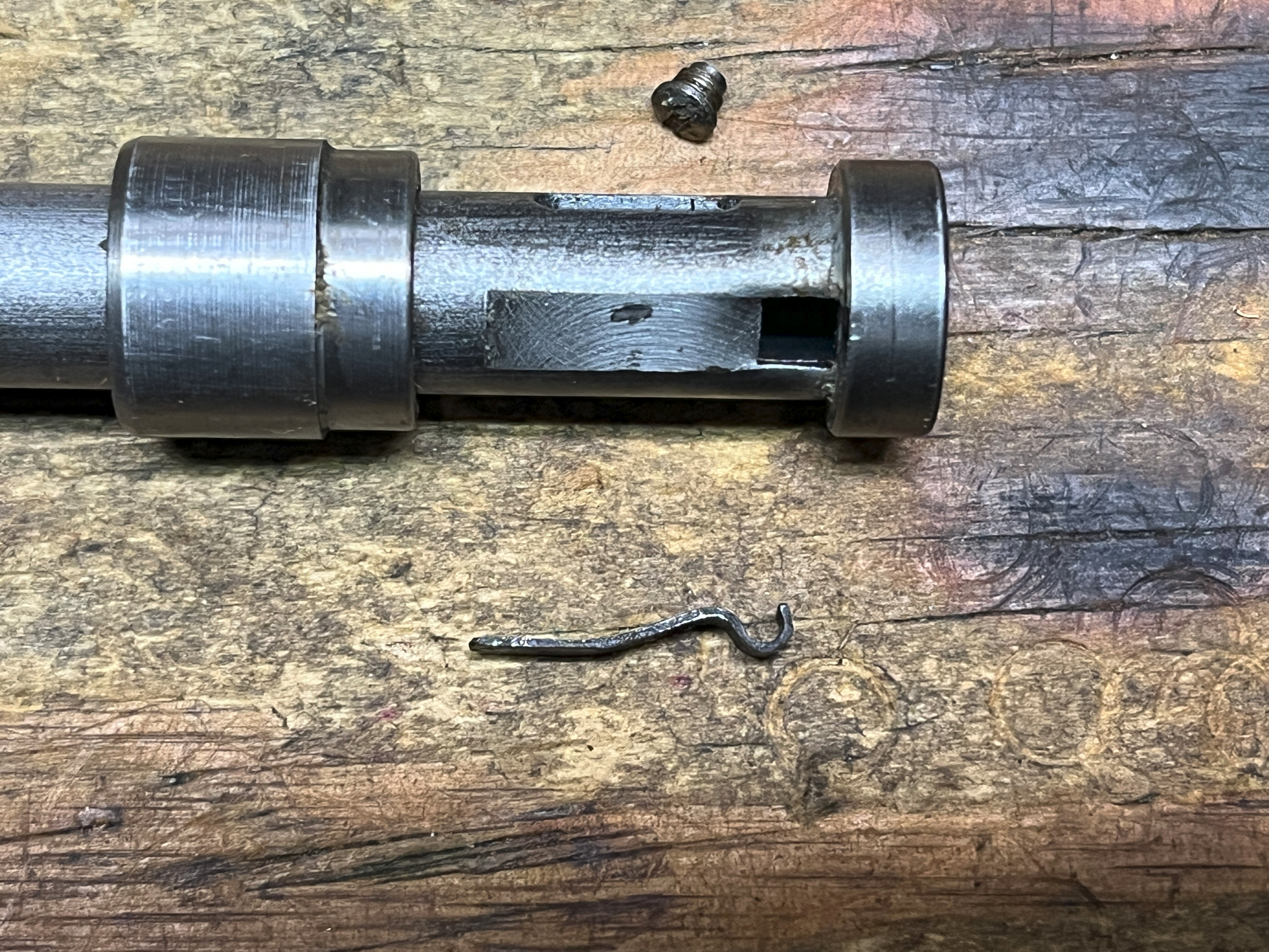

559430 I saw that one in Tulsa at the November 2022 show. I don’t have 200156. Is that a 24″ octagon plain trigger as well?
Is the solid one look like the bottom one pictured in this photo? That spring is formed from flat steel.

The 200156 is octagon barrel 24″ plain trigger. the magazine is just like the magazine that uses the cartridge stop you made but is made out of solid metal.

I got a picture from a gun that Ray House had I tried to get the serial number, but he sold the gun. I think the the stop you made is the early one & the solid one is a little later.

The picture you posted is the early style with a homemade spring in it. It should have the little spring like this one.

Bob I took pictures of a cartridge stop from a 1873 22 short rifle it was like the picture I sent you. I made the one in the picture from that pattern. I bereave there were both styles made I wish I had got the serial number of that gun. I am looking for another 1873 gun with that style stop.
