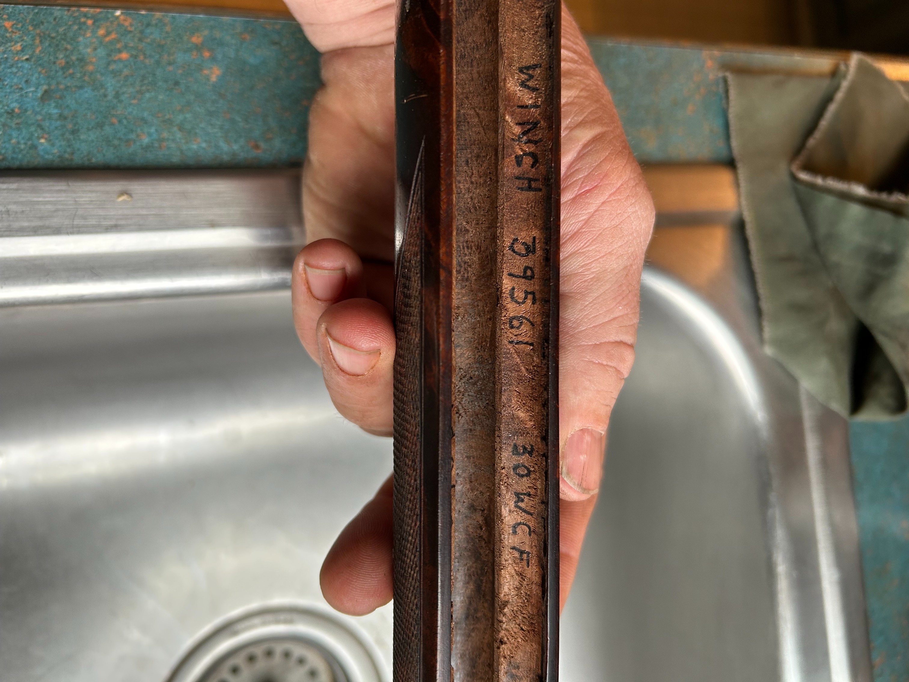

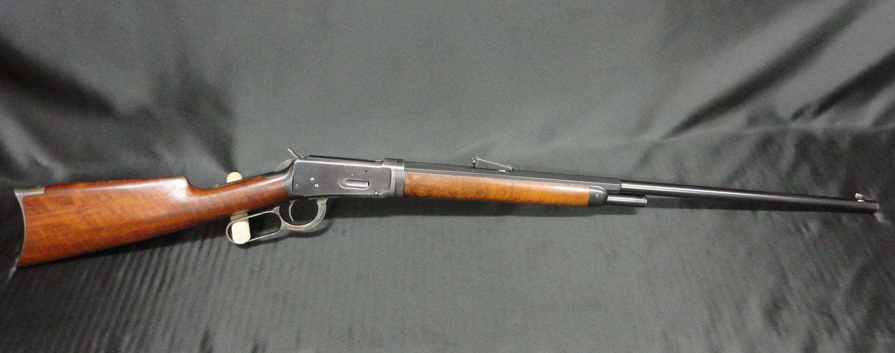

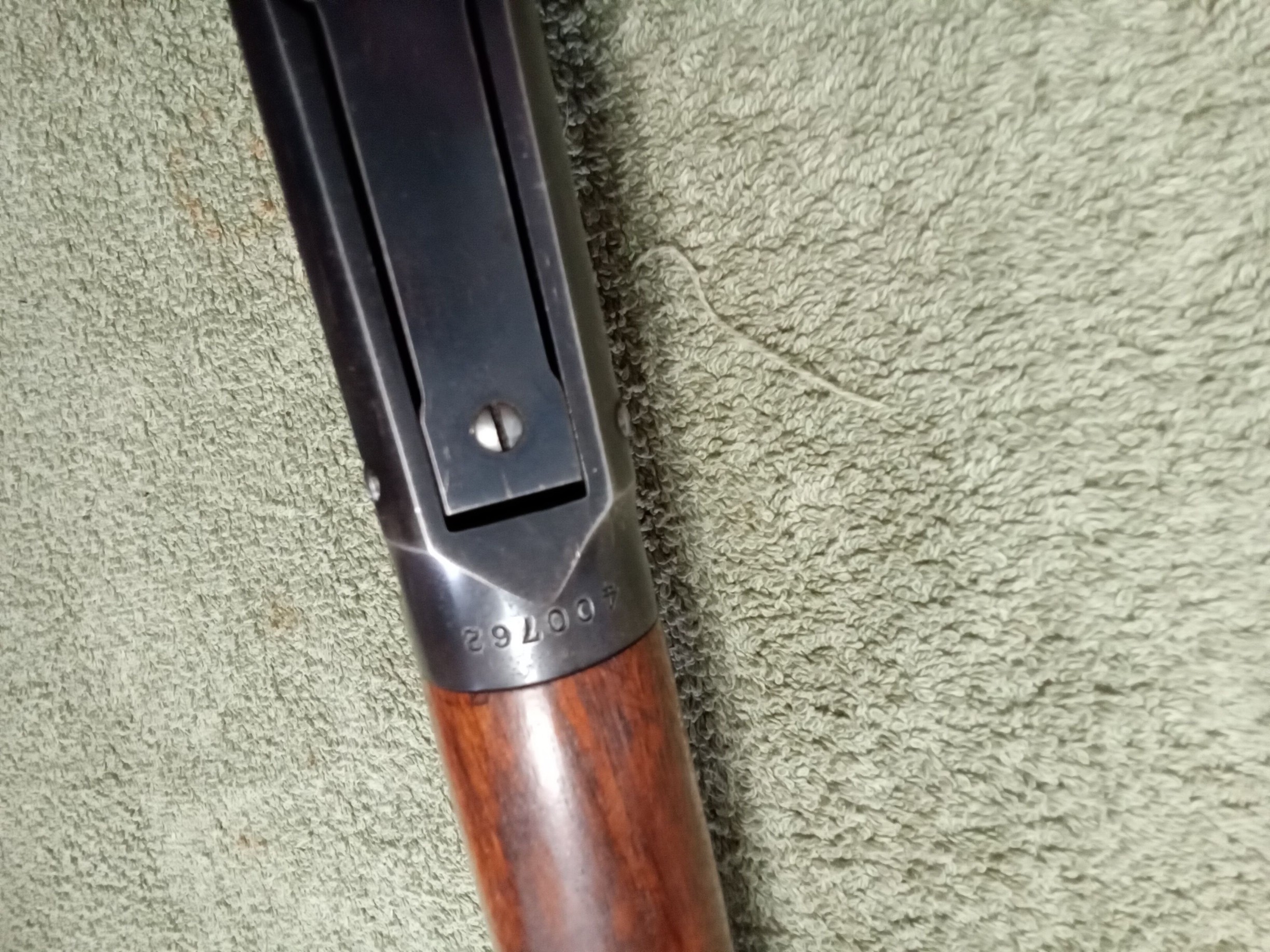

Morning all. So it looks like Ian is the winner of “Guess The Problem” today. So it looks like the wood on the deluxe 30wcf has been replaced. I had clear understanding when I bid on it that the checkering had been recut, not a big deal for me. But when I removed the fore stock to investigate the slight amount of wiggle it had, thinking I knew the problem, I discovered this.IMG_1114-1.JPG

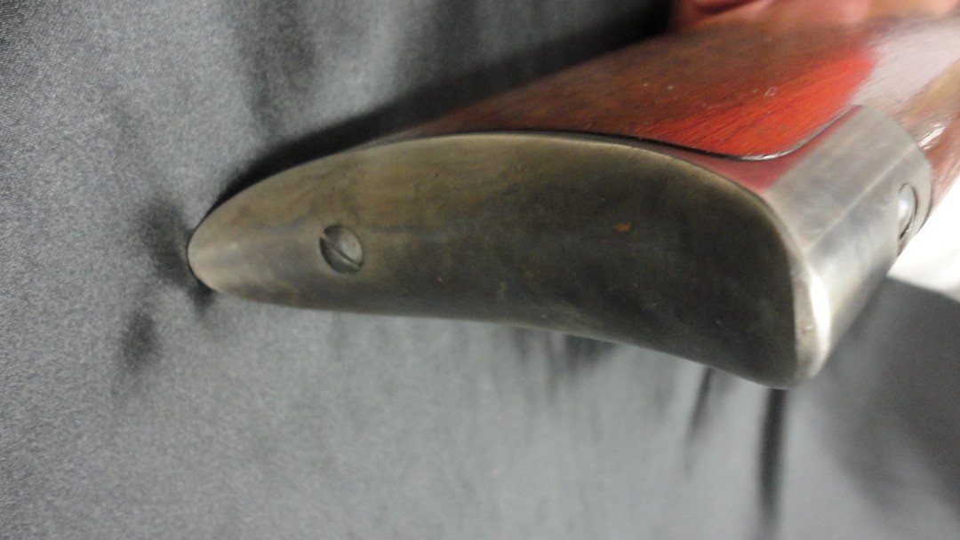

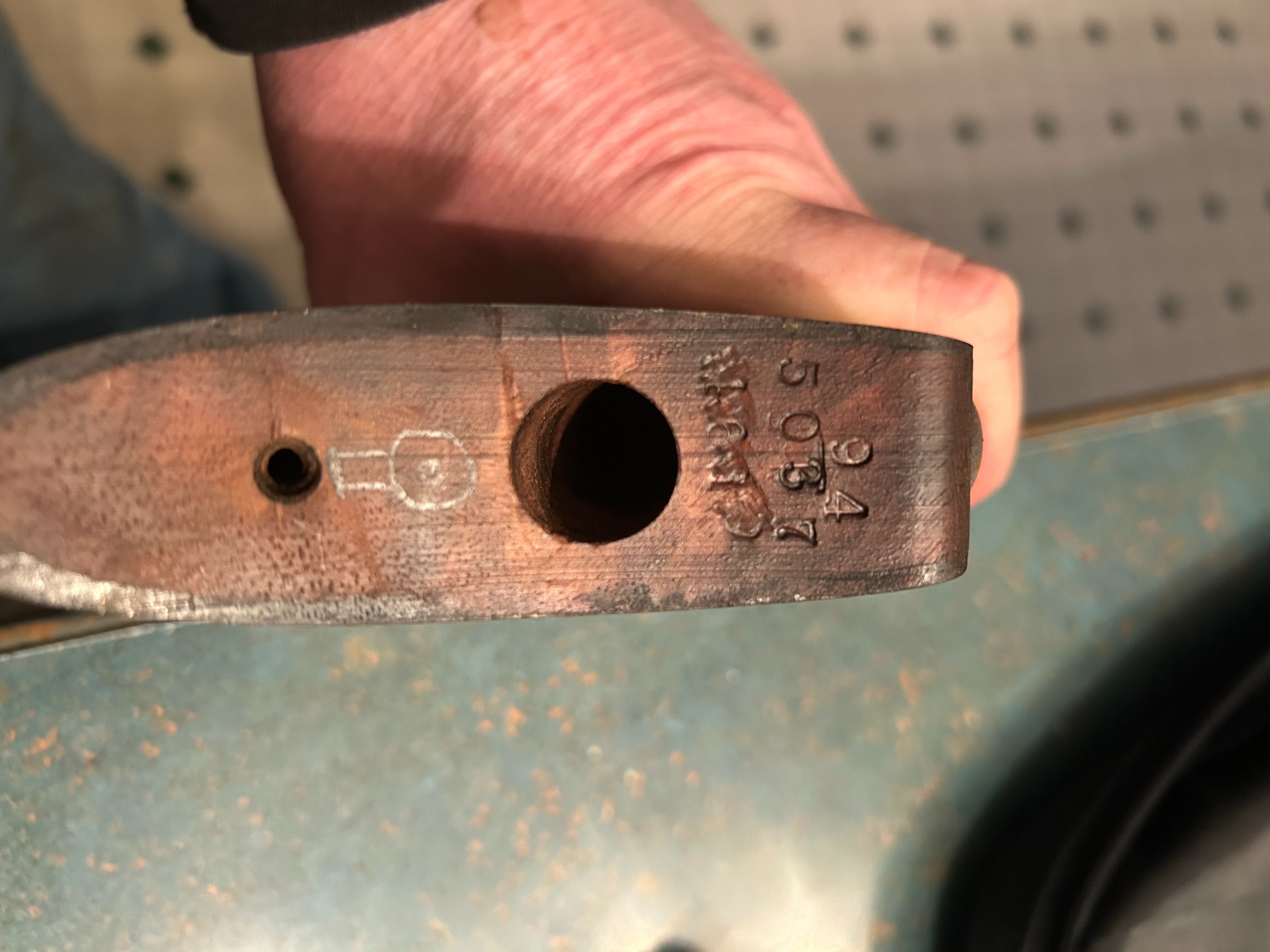

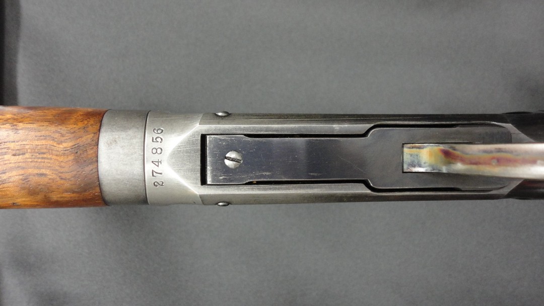

Then I decided to remove the butt to verify the assembly number in the tang, which was listed in the description as 5541 xxx. But there wasn’t anything in the inlet of stock. So to keep digging I removed the butt plate to find thisIMG_1123.JPG
So as you can see these numbers don’t match and there is a set that it tamped out. So it appears to me this wood is replaced and not original to this gun. I will take any of your opinions on this.
I agree, it isn’t factory original.
what does it look like the outcome will be?  Some auction houses will work with you or even refund your money, others have the policy that you bid on it an win it, it’s yours, irrespective of what you might discover later.

Tom-
I suppose the question is whether or not it was misrepresented. It certainly isn’t what it appeared to be. I reasoned the poor fit of the fore end could have been due to careless re-assembly but Ian’s more critical assessment proved to be accurate. Won’t hurt to voice your concerns with the auction house if you haven’t already. Good luck!

Just an observation, the forearm looks like its been recently milled judging by the cuts made for the barrel and magazine tube.  You normally dont see “rough” wood that should otherwise be fairly smooth, and the lack of oil staining, had it been an advanced age, or even dirt/grime discoloration.  The crossed out stamping on the butt, with new stamp placed over the “T” below the “94” is also rather odd.  And since both numbers appear to not match the lower tang, would guess one or both were switched out.

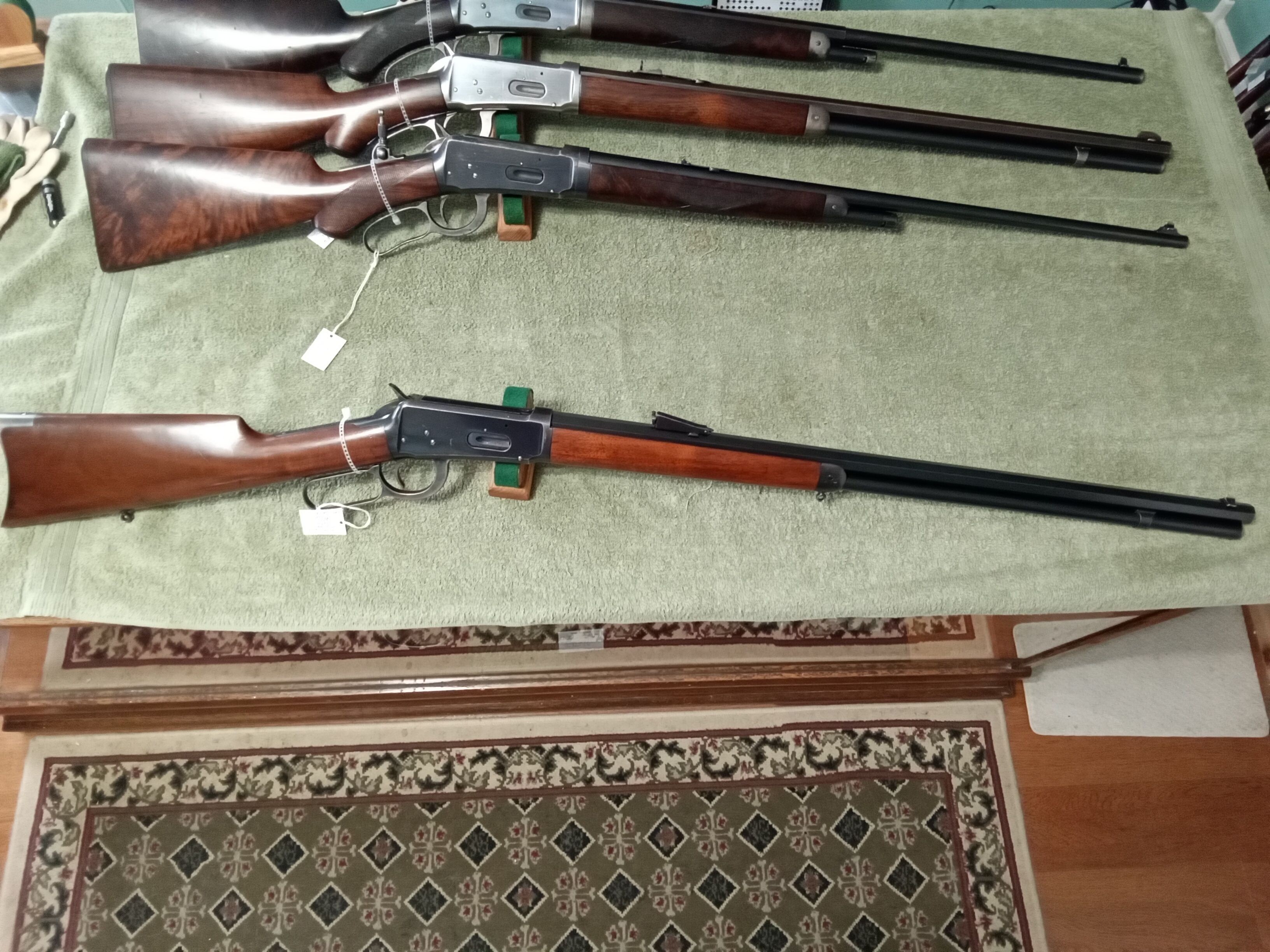

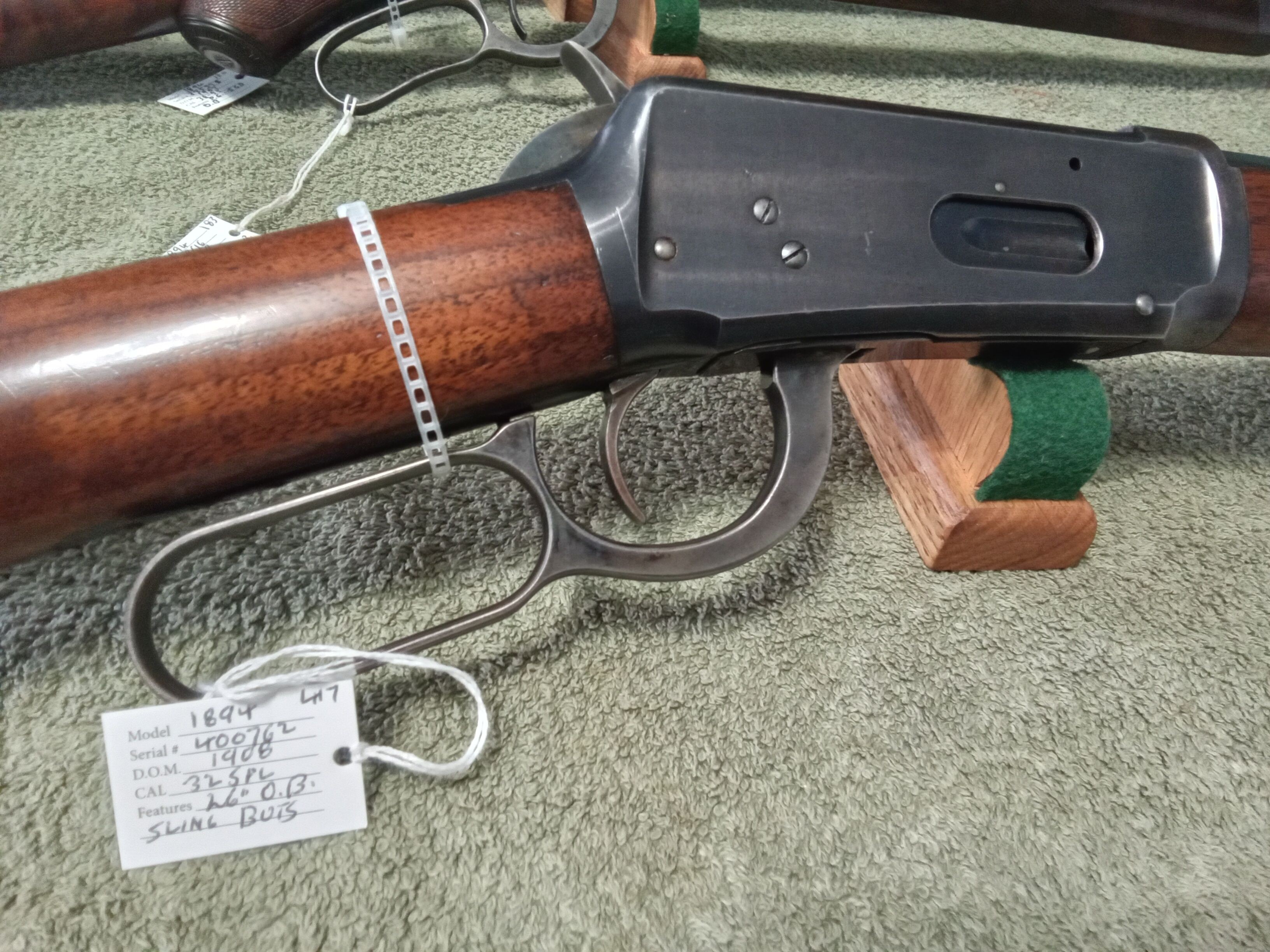

Since we have some 32ws fans here, thought I’d share one of mine.
12-1.jpg15.jpgIMG_6997.JPGIMG_7004.JPGIMG_6993.JPGIMG_6994.JPGIMG_6995.JPGIMG_6999.JPGIMG_6998.JPG9.jpg
Forum Posts: 2102
March 17, 2026 - 7:21 pm
Al,
That’s beautiful. I’m never surprised when I see one of you’re high condition examples! You have a great eye for a nice Winchester rifle. Smile
Thanks for sharing!

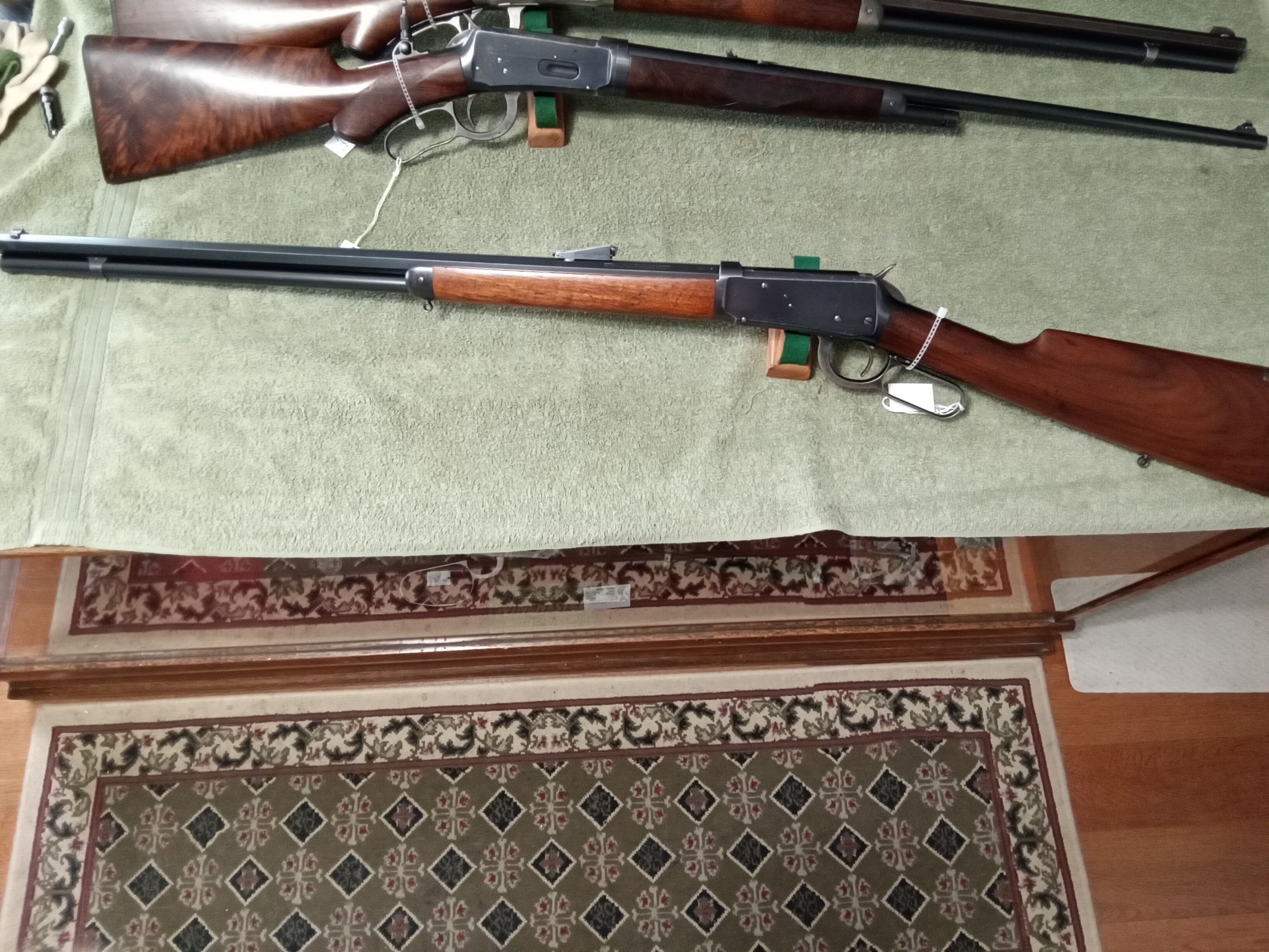

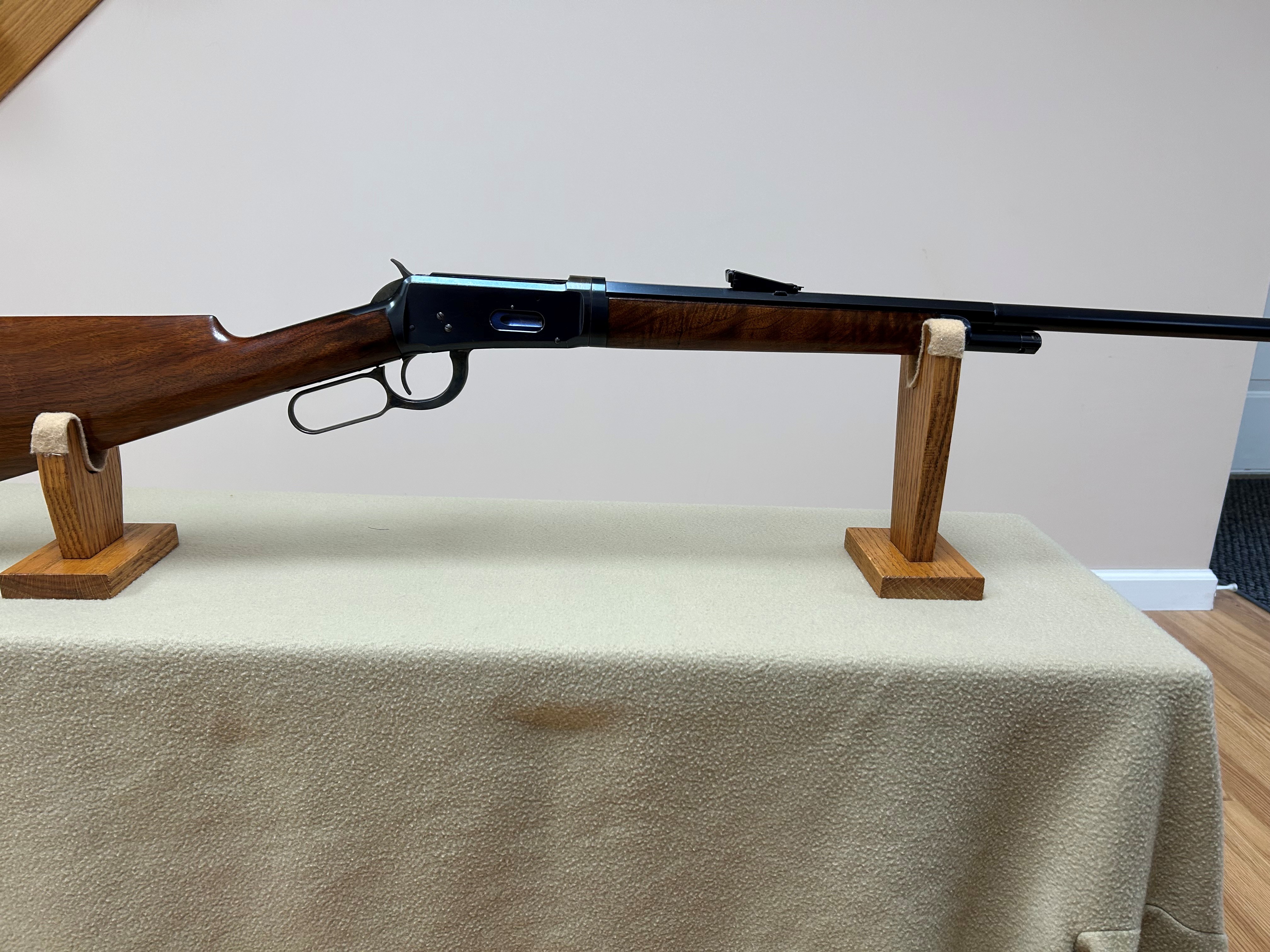

Very Nice Al, here’s his younger brother;20260317_152530.jpg20260317_152548.jpg20260317_152606.jpg20260317_152646.jpg20260317_152720.jpg20260317_152739.jpg20260317_152802.jpg
Forum Posts: 1657
March 17, 2026 - 9:03 pm
Thanks Tony,
Henry that is a real beauty ya got some nice stuff.
