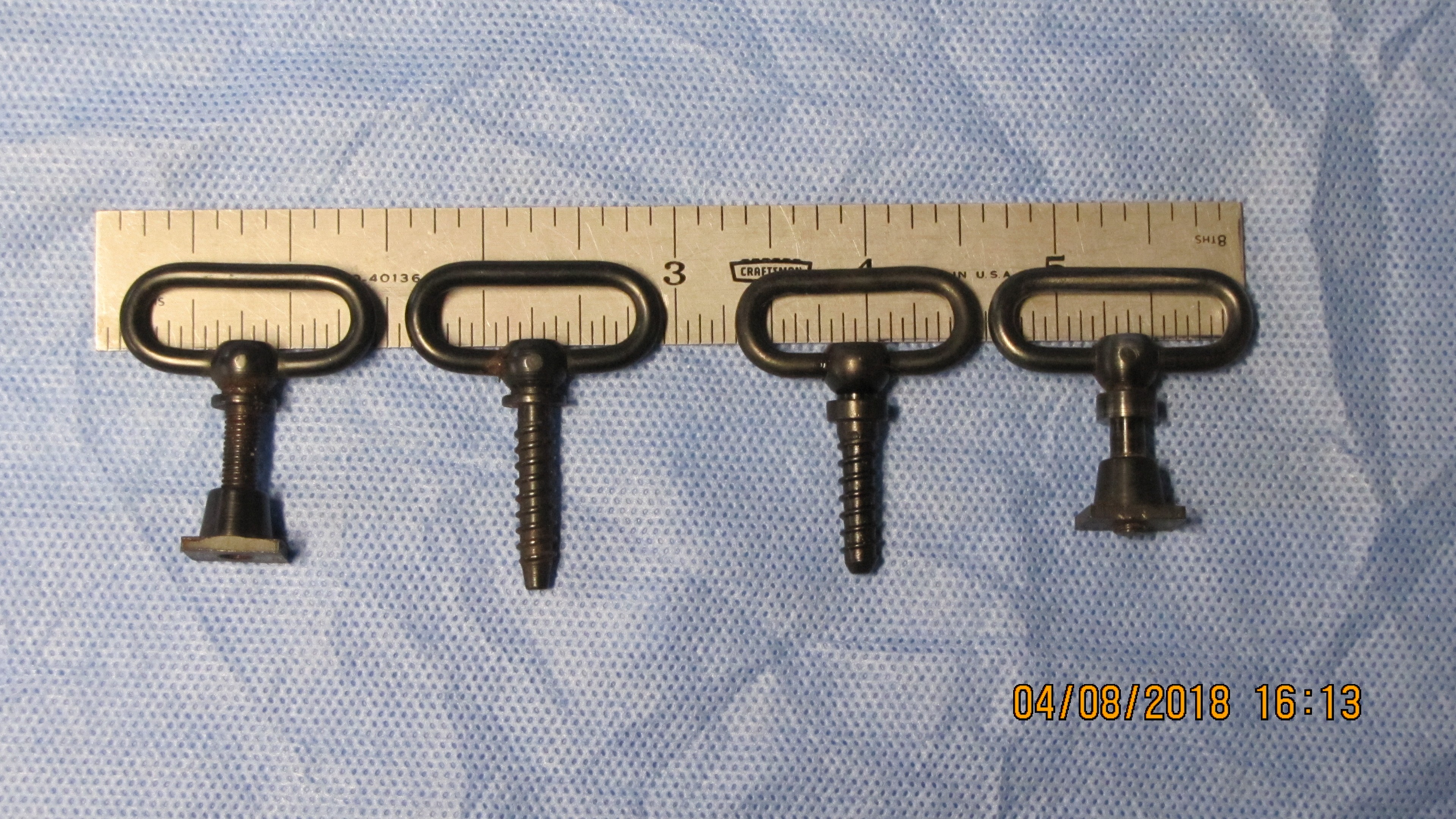

Thanks for your input.  Which swivels are correct for the late model 70?
The left pair has a flat shoulder that meets the wood and the right pair has raised shoulder.
The “Rule Book” shows both, but not a definitive answer.
Thanks,  RDB

I think you will find that the rear screw uses the narrow shoulder (.036″) thick, and the front screw uses the thick shoulder (.135″) thick.
Steve

You are right, of course.  I misunderstood the question, as I thought Roger was talking about a difference in the front swivel escutcheon (my bad eyes combined with my small laptop computer screen)!!!  Embarassed
Best,  Lou

Thanks Guys.  The confusing thing is that you would think that the swivles would come in a pair.  Matching front to rear.  The wood screws or rear swivels, I pictured, each have a different base that meets the wood and the same with the front swivels with the escutcheon.  The pairs in the “rule Book” don’t match either.  That is what I am trying to determine.
RDB

Received the model 70 today.  Of course I immediately checked the bore and then proceeded to look for any irregularities that might be a problem.  Found nothing that a little TLC wouldn’t fix.  The sling swivels were the first concern.  Both the front and rear Uncle Mike’s swivels had the shoulder that actually goes into a relief or counter sink in the stock  The front swivel has the same thread as the factory Winchester swivel, so I didn’t have to remove the stock to switch it.  Cleaned the bore and chamber and found no crud or residue or traces of copper.  The bolt face still has most of the bluing present, so it wasn’t fired much.  Used some lemon oil to clean the stock off and it even cleaned the dirt off the pad.  The scope is extremely clear and functions perfectly.  The only problem encountered was the sticking of the floor plate release button.  Carefully Kroiled it and used a tooth brush handle to work it loose.  The stock looks a lot better and overall I think I have a real good gun.  One thing I did notice, the receiver finish differs from the barrel finish, not as black and not as finely polished.  I believe this to be correct, let me know if am I misinformed on this?   I do appreciate your help, thanks to all.  RDB
