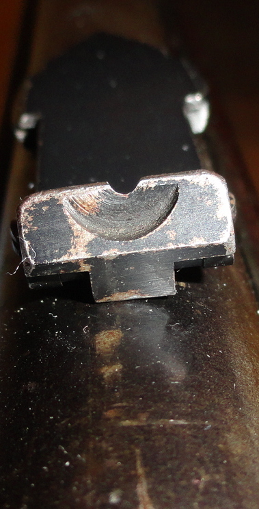

Thanks Bert.  I discovered that after I found the booklets on sights.  Unfortunately, with that discovery it seems apparent (to me- a novice) the rear sight is a replacement as it isn’t marked with distance, is a u notch and not v, and the first blade is recessed.  It’s also askew upon closer examination:

You are correct,  the rear sight is not original… it is a cheaply made reproduction. More than likely it originally had the No. 44A sight on it, and that is what I would look for to replace the sight on it now.

Thanks Bert, that was my conclusion as well- first look for a 44A, alternatively look for a 34C.  I appreciate the feedback.  Regards, Ron
