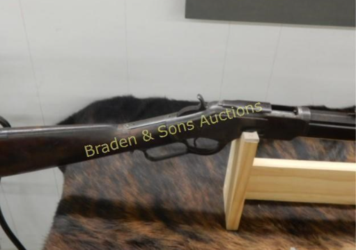

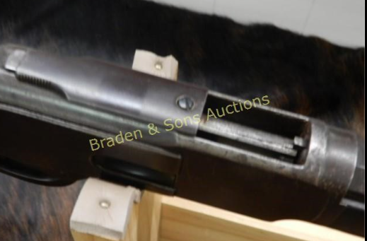

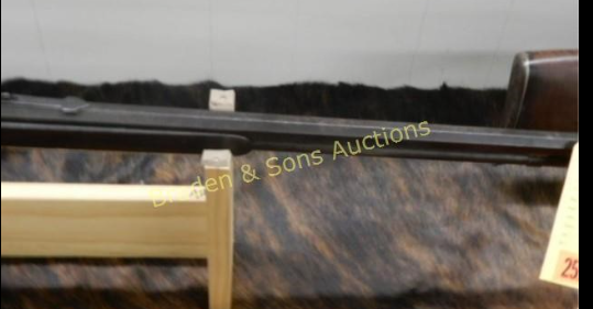

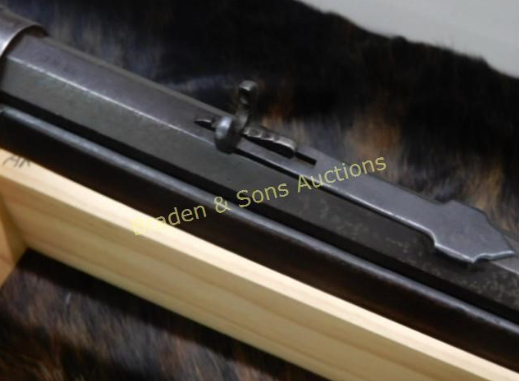

I am going to look at an “1873 LEVER ACTION CARBINE MANUFACTURED IN 1889, SERIAL #3140XXB” which is being offered at a local auction. I can’t tell much from the photos other than it has an octagonal bbl don’t know the bbl length. I’ll attach a couple of pictures. When I go look at it later today, what should I look for?
Not great pictures but I’ll do better when I go to see it.
Bill Brown
Forum Posts: 2008
March 8, 2019 - 3:48 pm
 Bill, It is a rifle, Oct, full mag, rifle butt, third model. T/R

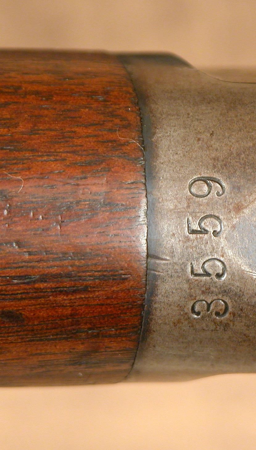

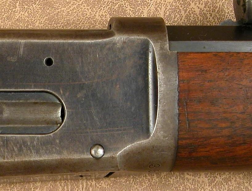

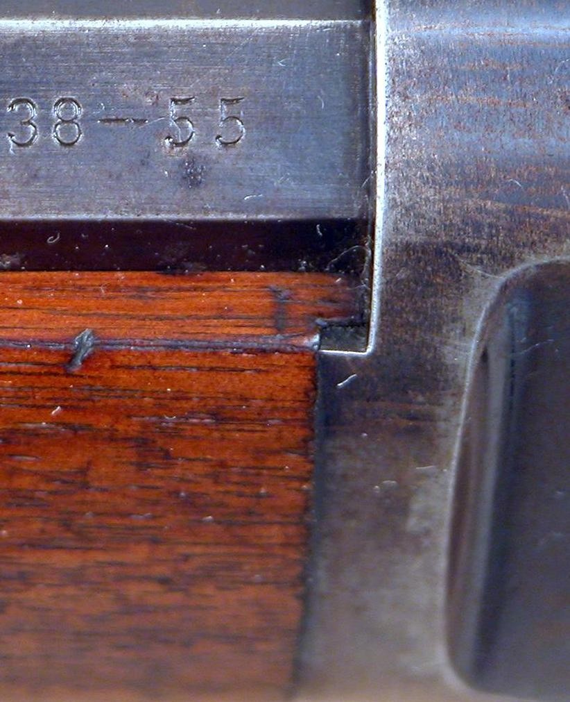

You will want to check the wood fit around the upper and lower tang of the receiver and where the fore end wood joins the receiver face.  IT should fit nice and tight as in the attached photos.  Get as many photos of the rifle and the areas of stamped writing on it as you can.

TR is right.  It appears to be a standard octagon barreled sporting rifle, not a carbine.  The receiver ring would indicate that it is either a .32-20 or .38-40 caliber, but it is hard to tell from the photos if the mag tube is for large or small caliber.
Forum Posts: 4995
March 8, 2019 - 4:38 pm
What you are looking at is lot 251 a 32 caliber 1873 rifle serial number 314078 with poor wood fit at the wrist and little finish left as I can tell from the poor pictures on the site. I would guess a value at between $1200 to $1400. If its got some good blue left it will increase value. 32 caliber is the least desirable caliber in the 73’s.

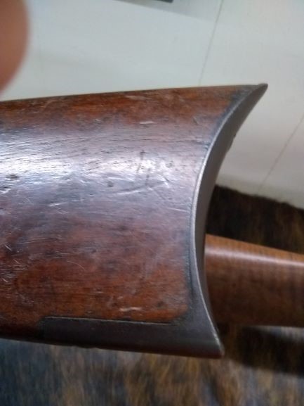

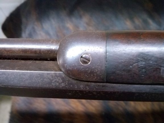

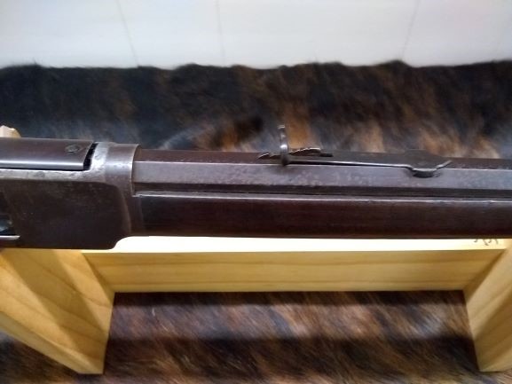

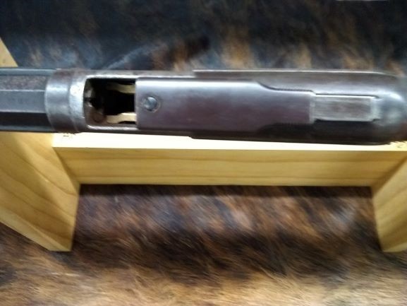

Well I looked at it and was not very impressed. The wood fit was good except for one repaired area. 1873-12.jpg

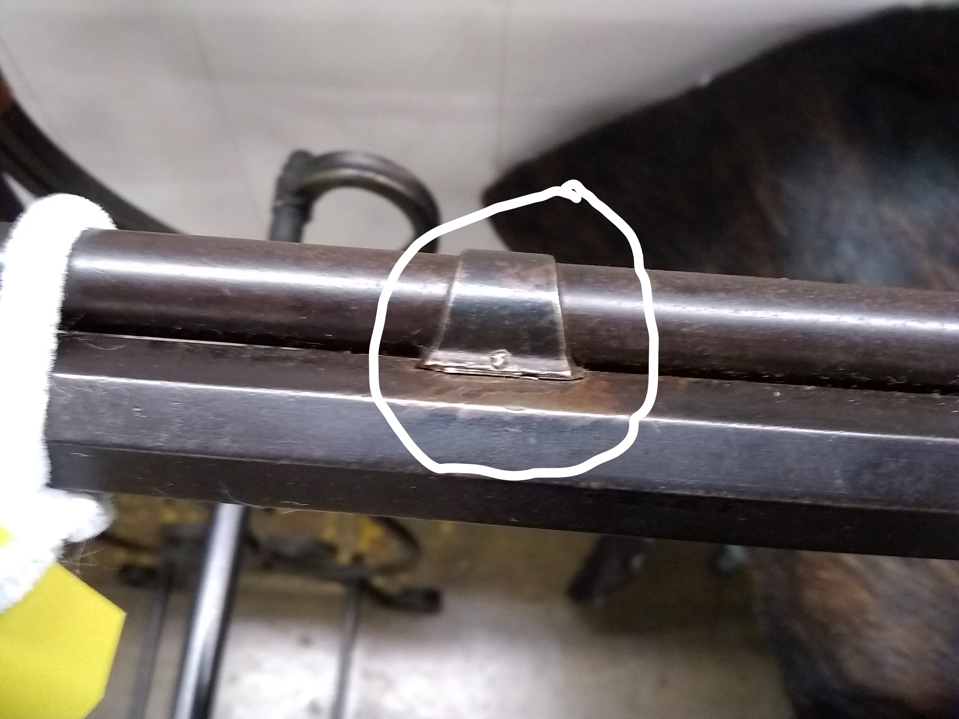

Maximum bid $850??
Don’t do good photos with my phone, old and shaky.
Thanks, Bill Brown
Forum Posts: 4995
March 8, 2019 - 7:12 pm
Magazine band looks like it was glued or soldiered. The gun looks to be original except for the repairs. As to what to spend on it, it depends what your plans for it is. Is it going to be a wall hanger or a shooter gun? I would guess the bore is not good enough for a shooter based on the muzzle picture so its a wall hanger. As a wall hanger $850 is about all its worth but with it being one of a few guns at an auction there will be at least 2 idiots that think its priceless.

The shot of the muzzle face and the “repaired” butt stock would be enough to keep me from it!  The wood has definitely been sanded at some point.   Here is unmolested wood on one over here in Houston.  http://www.collectorsfirearms.com/winchester-model-1873-32-20-w9293/
