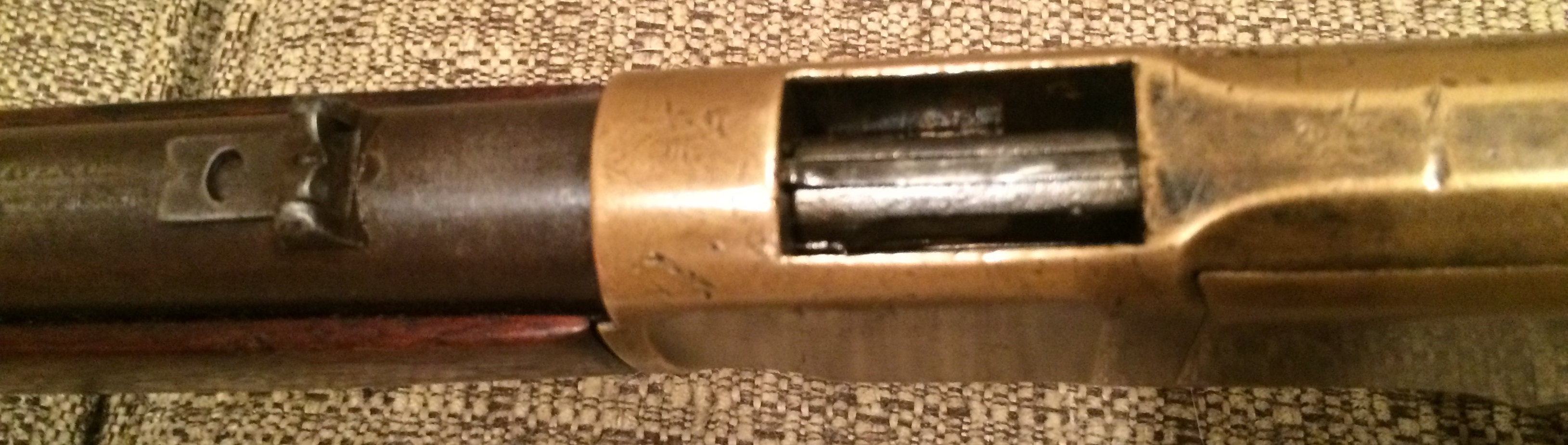

I got bit last year and have been suffering ever since with this winchester virus. Went to an auction this week to see if I could find a cure and it only got worse. I started out last year looking for a few good lever guns for my wall, but the list keeps getting longer. This gun was in an estate auction and was out of place compared to the other guns there. With my limited experience it appeared to be original except for maybe a screw or two being replaced. I am interested to get opinions whether it is original condition or not. I also was impressed with the condition of the rifling. Some light pitting but seemed sharp to me. Any ideas on value. There are not many examples of 66’s on the internet to compare to. S/N 3972X Circa 1870. Makes it a 3rd edition I believe.

Kevin,
The pictures are too small to see any detail.

An even rarer find in that it has a crescent buttplate on a carbine.  Nice acqusition.
Forum Posts: 4995
October 11, 2015 - 2:46 am
Kevin,
The gun had some rust on it and has been cleaned up including the brass. I don’t see any sign of original finish. I see a problem with the stock, it does not match the guns condition or fit. I would then question the butt plate.

Kevin,
I tend to agree with Bob. In my opinion, the front sight has been added do to the serial number. The sight should be part of the front barrel band. A neat old gal.

The rifle butt plate would be correct for a carbine  at that time. The stock is new to the gun, the metal to wood fit is too good for the condition of the rest of the gun. Someone tried to artificially age it by denting the wood with something but there is no age to the dents. Then you have the wrong front sight as Walter pointed out. I don’t know if someone put on a later barrel or milled the barrel. The gun is worth $4500-$5000 in its current condition

Thanks everyone for your observations. I have been taking a closer look at the stock. At first I didn’t agree about it being replaced. Its kinda funny the pictures make the metal look worse but the wood look better. I do believe it is possible the stock was replaced but the forearm seems original. If it was replaced it looks to have been from another winchester of similar or at least very old vintage.

Just received the Fall edition of the Winchester Collector magazine today and was reading an article by David Tawney about his quest for information on an 1860 Henry. Inspired me to do some investigating on my 1866. I had already pulled the stock and could not locate any numbers but the article showed numbers on the butt plate of the Henry, so I checked mine. Happy to report the numbers matched the frame numbers. This does not mean the wood has not been replaced but makes it less likely. At least the stock was not pulled from another gun and fitted to this one. Most likely would have transferred the butt plate too if the stock had been changed in this manner. I was going to get a letter on this gun but it appears that the information is not available for this particular serial number.
