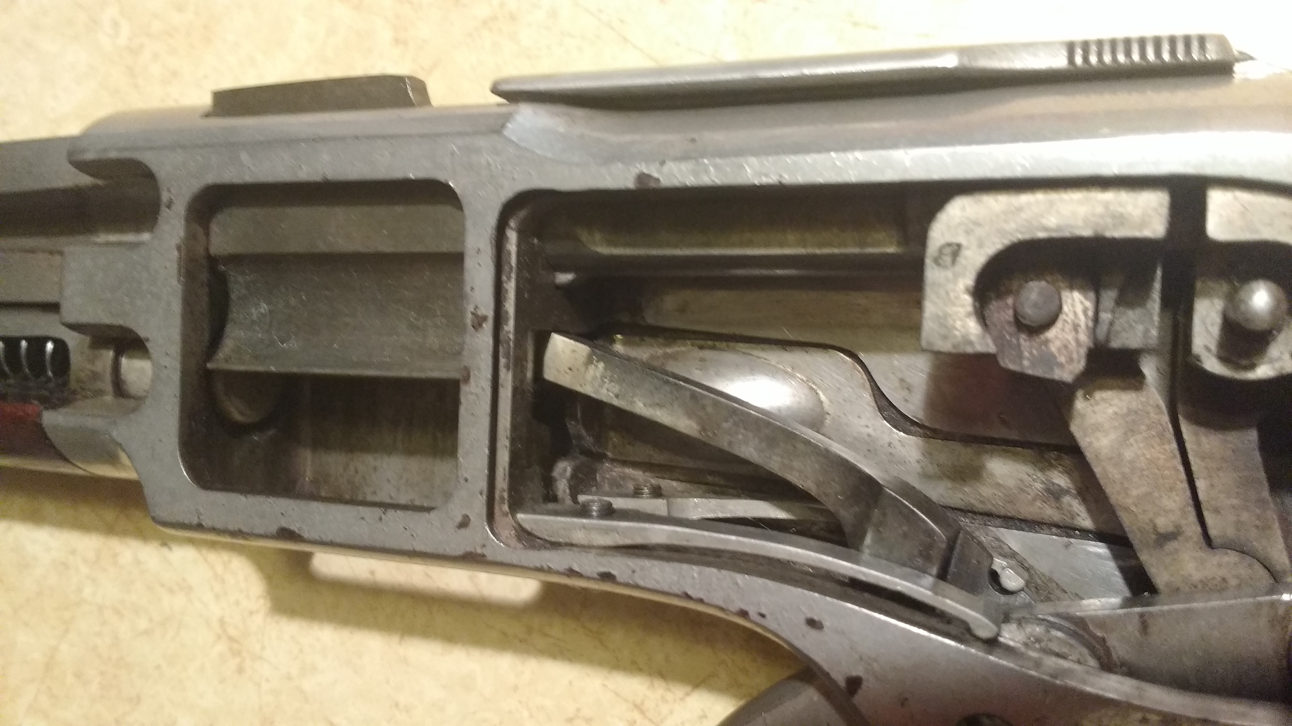

You can remove the stock and the left sideplate and watch it as you cycle the lever. You just leave the right sideplate on and lay the gun on that side so the toggles don’t fall out. You will be able to see why its not going in to full cock.

Yes I have done that and it almost travels far enough looking at it from inside the receiver. I have a couple other 73’s and comparing the  cycling the only difference is bolt position that I can see. The hammer is in good condition and the bolt fave is not overly worn

Check the retractor, long side points up and short end down with the longer part towards the back. Excessive play in the toggle pins and hinges could cause the bolt to go back far enough but it worked before you took it apart. This would be odd but other thing that might of happened is when cleaned it up you removed a build up of grime at the end of the firing pin where it bottoms out in the bolt that now the firing pin goes in farther causing the firing pin to not go back far enough.

  Nice picture Bob but you didn’t have to cut up a good gun to take it. That going the extra mile. Tom
Forum Posts: 6902
July 19, 2026 - 7:10 pm
Ah, brotherly loveLaugh

Nice picture indeed. I have the retractor in correctly but I noticed the firing is sticking out and hard to move. It should be free floating right? So maybe I found the issue?
