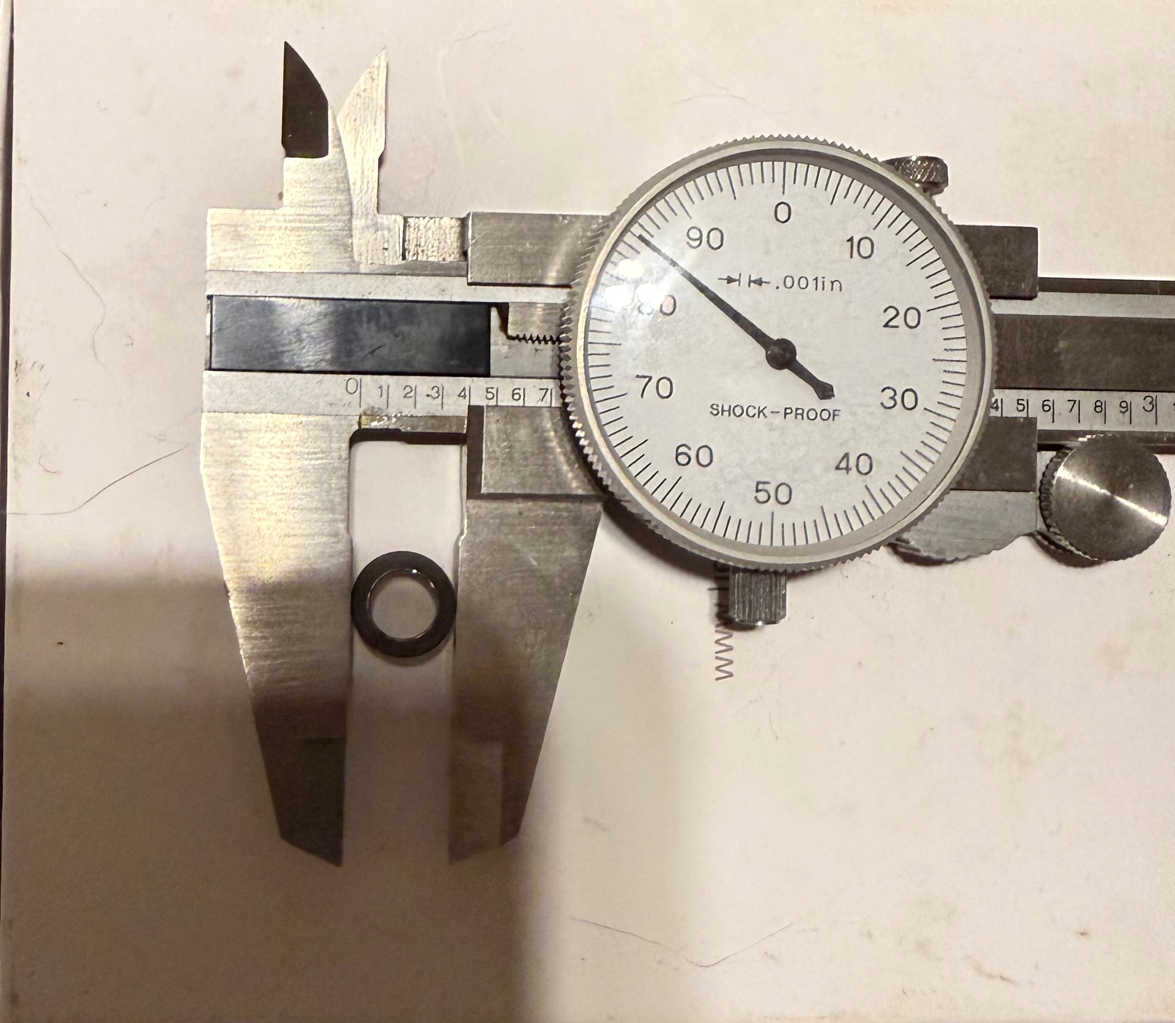

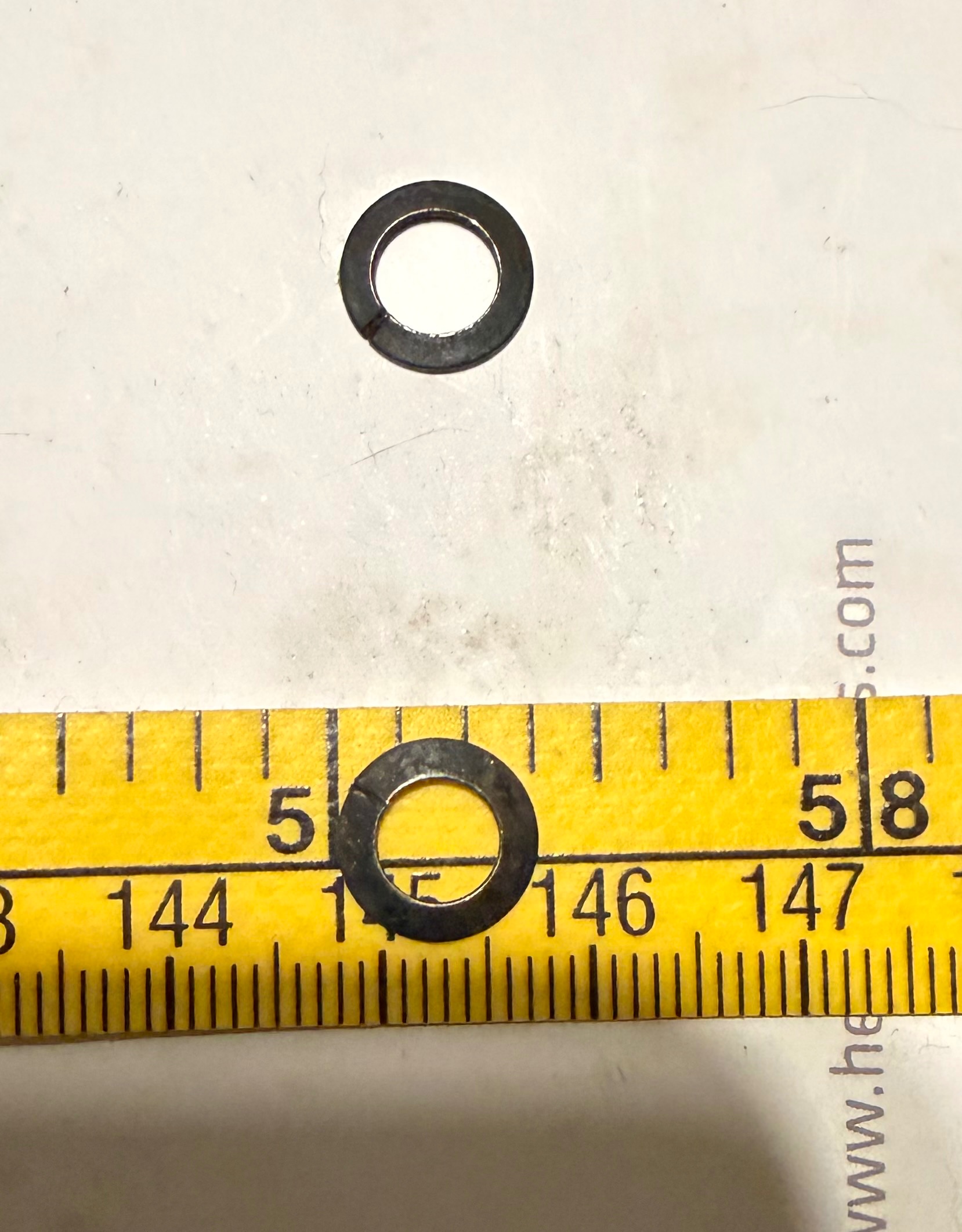

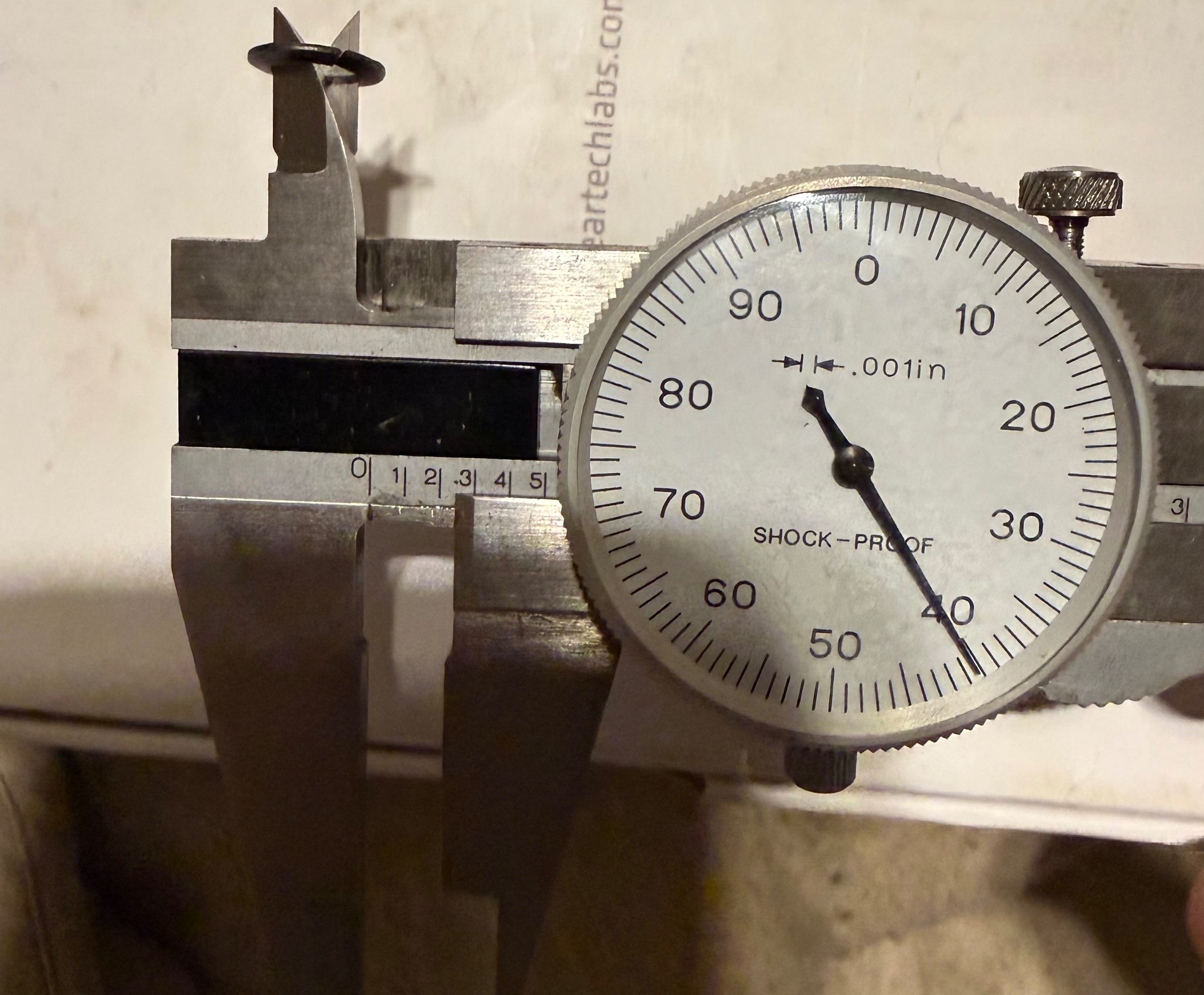

I have located the eyes , and hooks . If I can get the dimension of the leather sling, I will make it for my use on this project until I can find an authentic Winchester sling. Would anyone know the dimensions of the front screw washer for a Lyman 21 sight ? I can’t find a clear picture, or description of what type washer it is. Thank you.

February 2, 2026 - 1:00 am
The washer is concave spring steel, Winchester Bob make all the parts for the model 21, but you may find it in a good hardware store

cj57 Thanks for your reply, I will check out the hardware stores to see if they have a suitable washer with the dimensions from your photo.

February 2, 2026 - 2:38 am
Winchester Bob lists it for 5.00, but min. order is 30.00

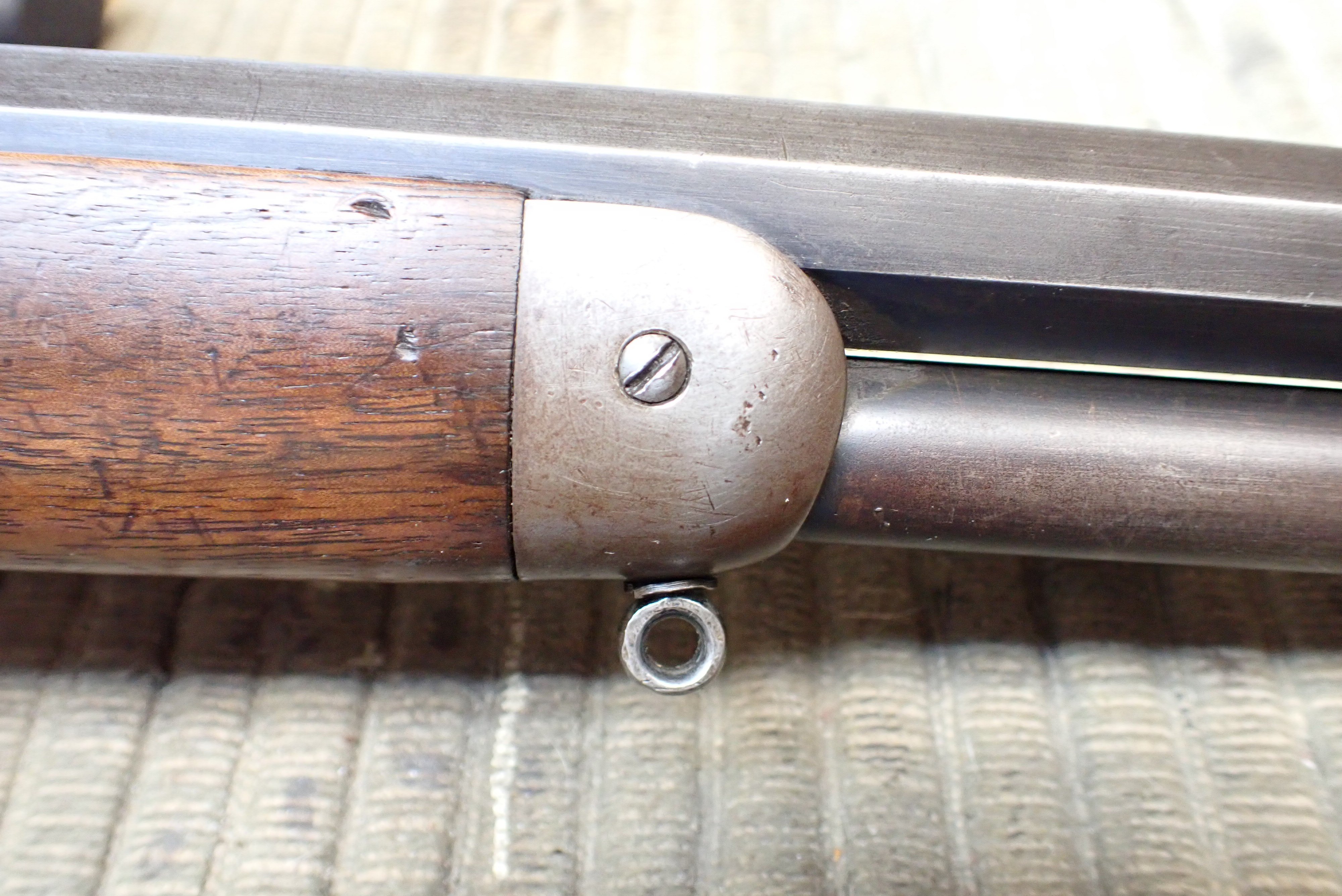

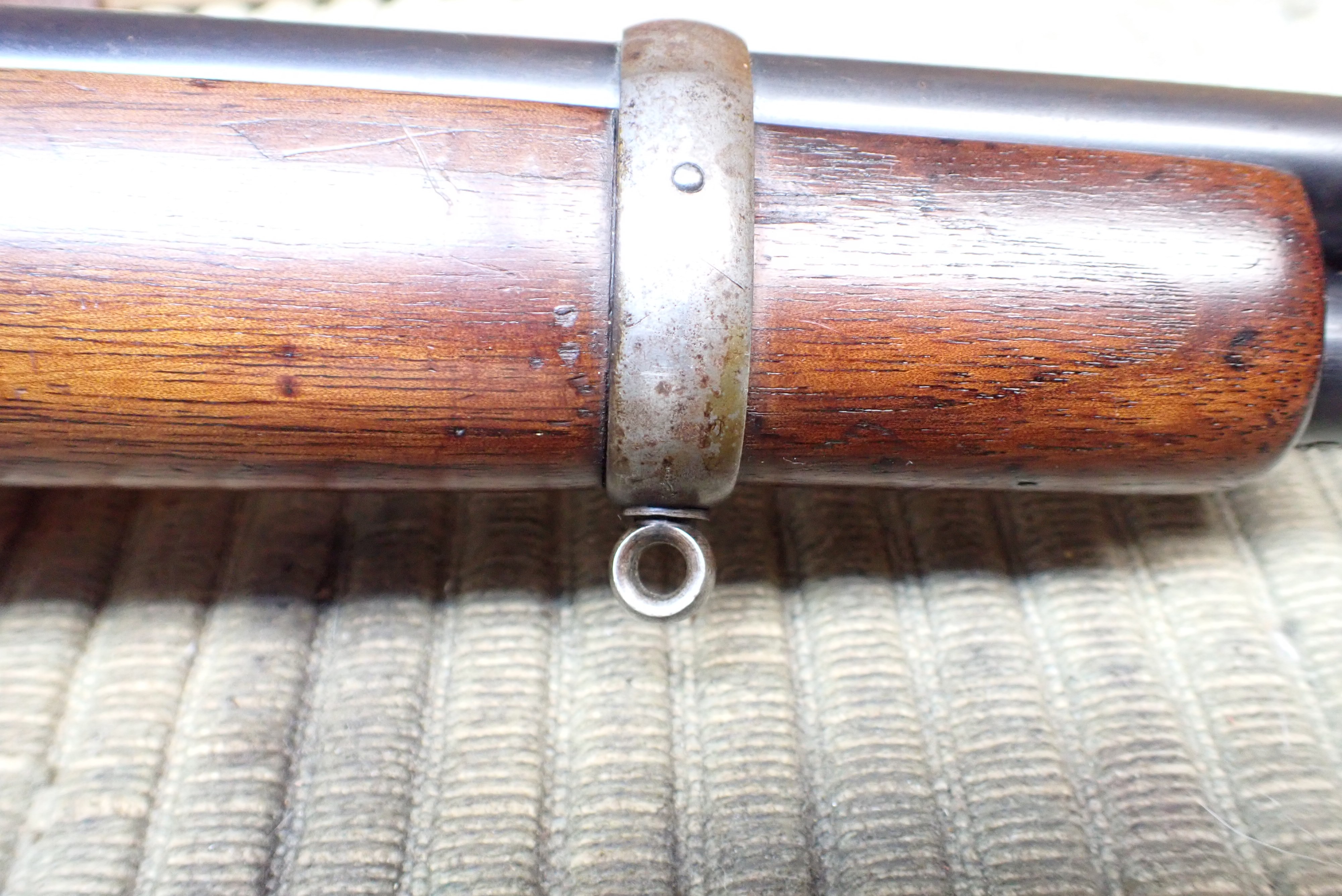

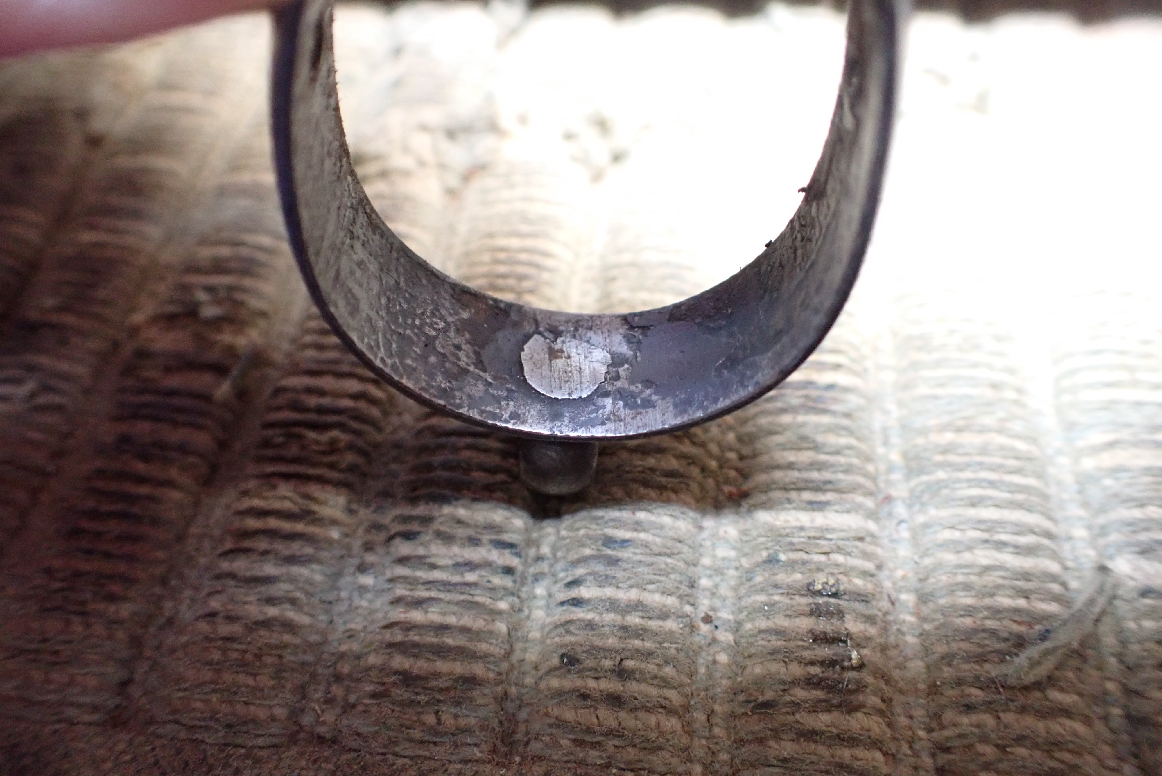

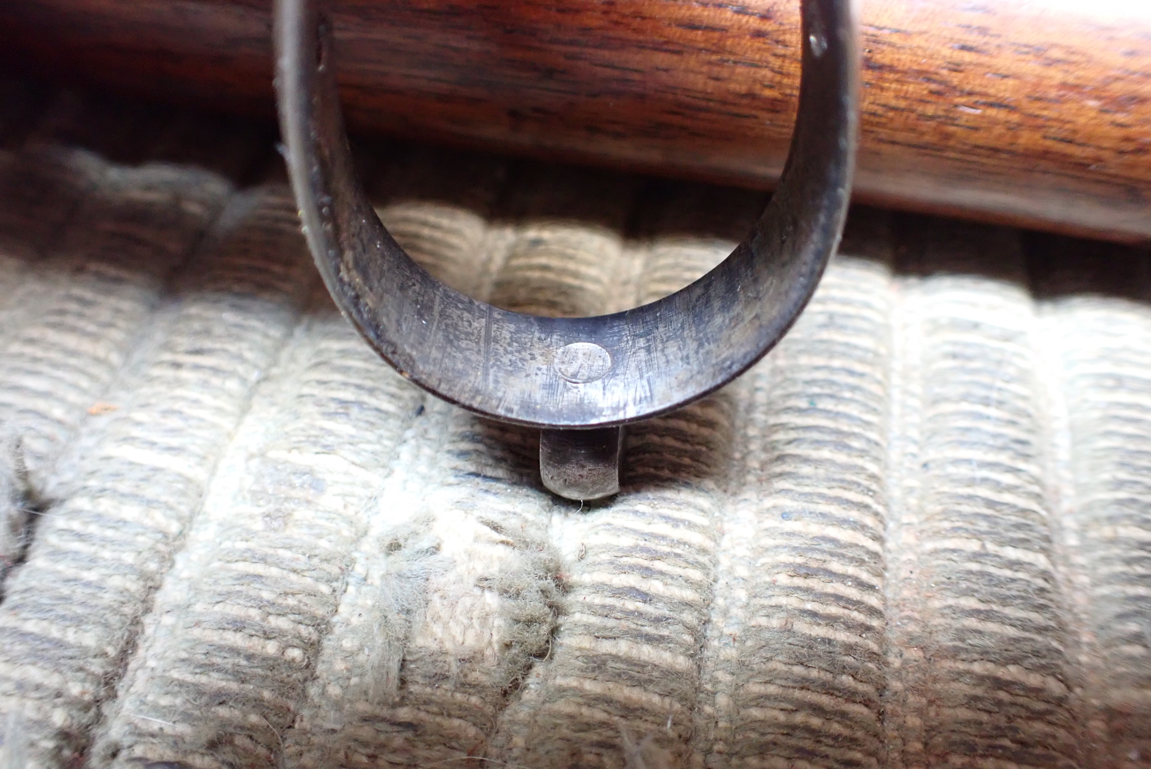

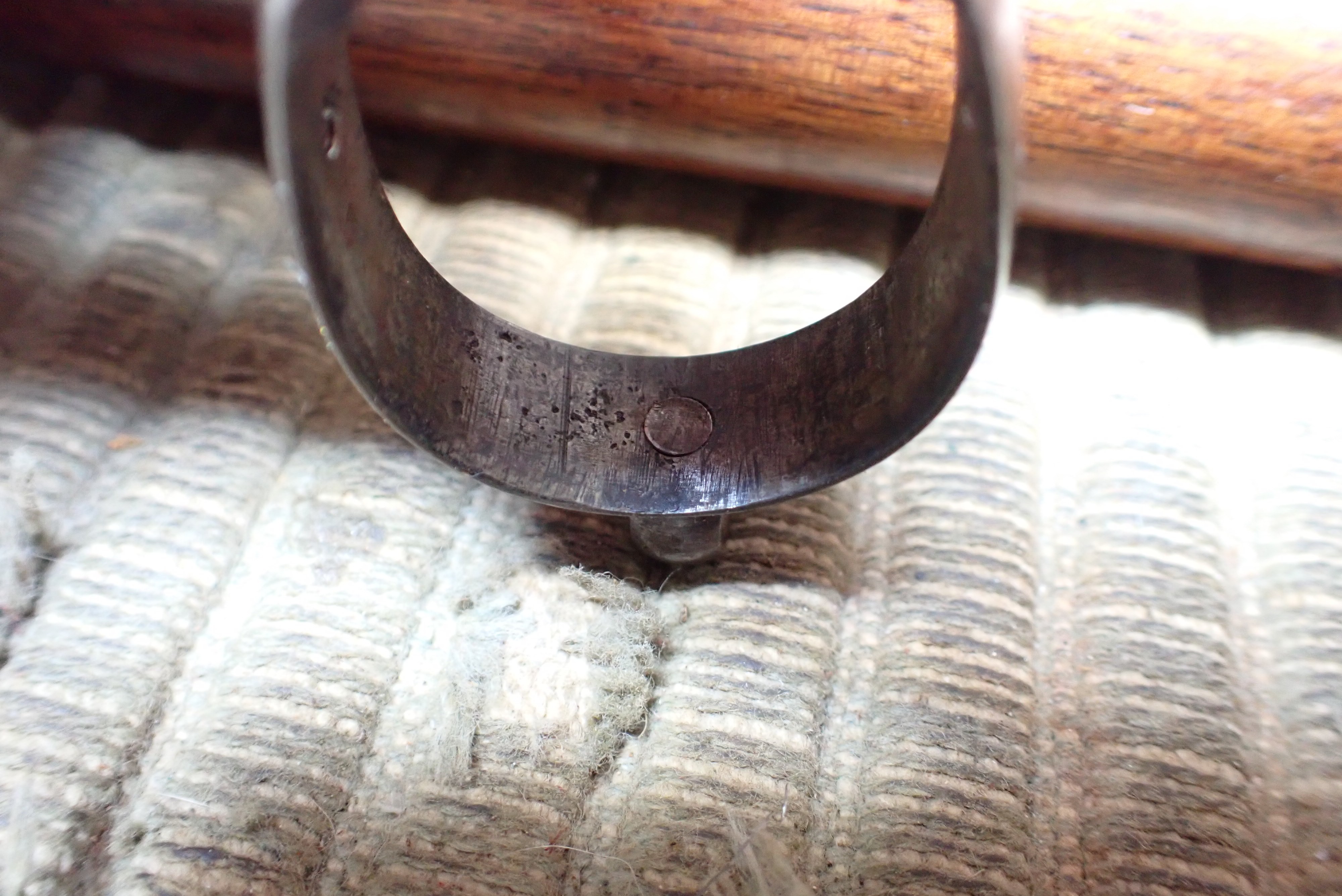

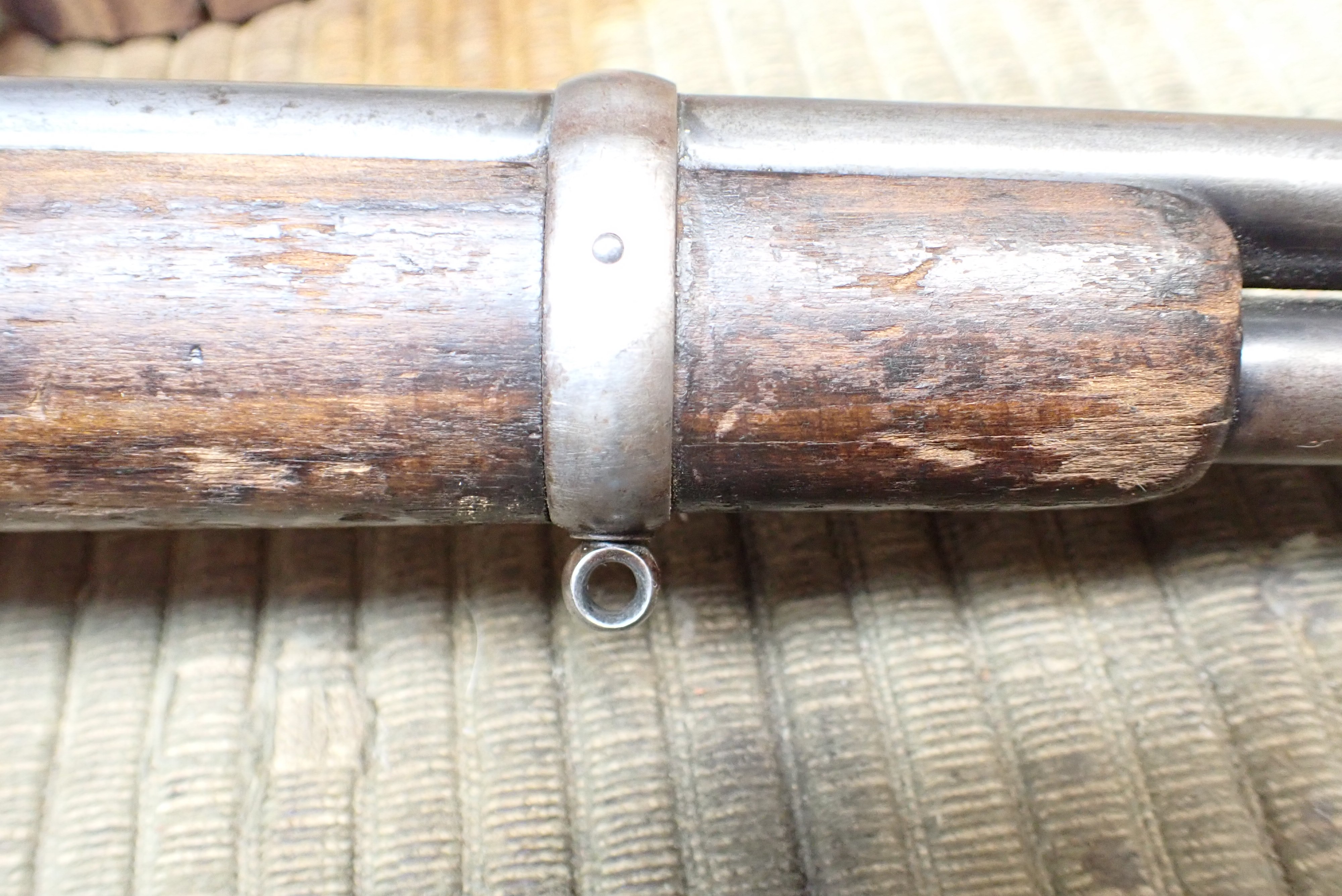

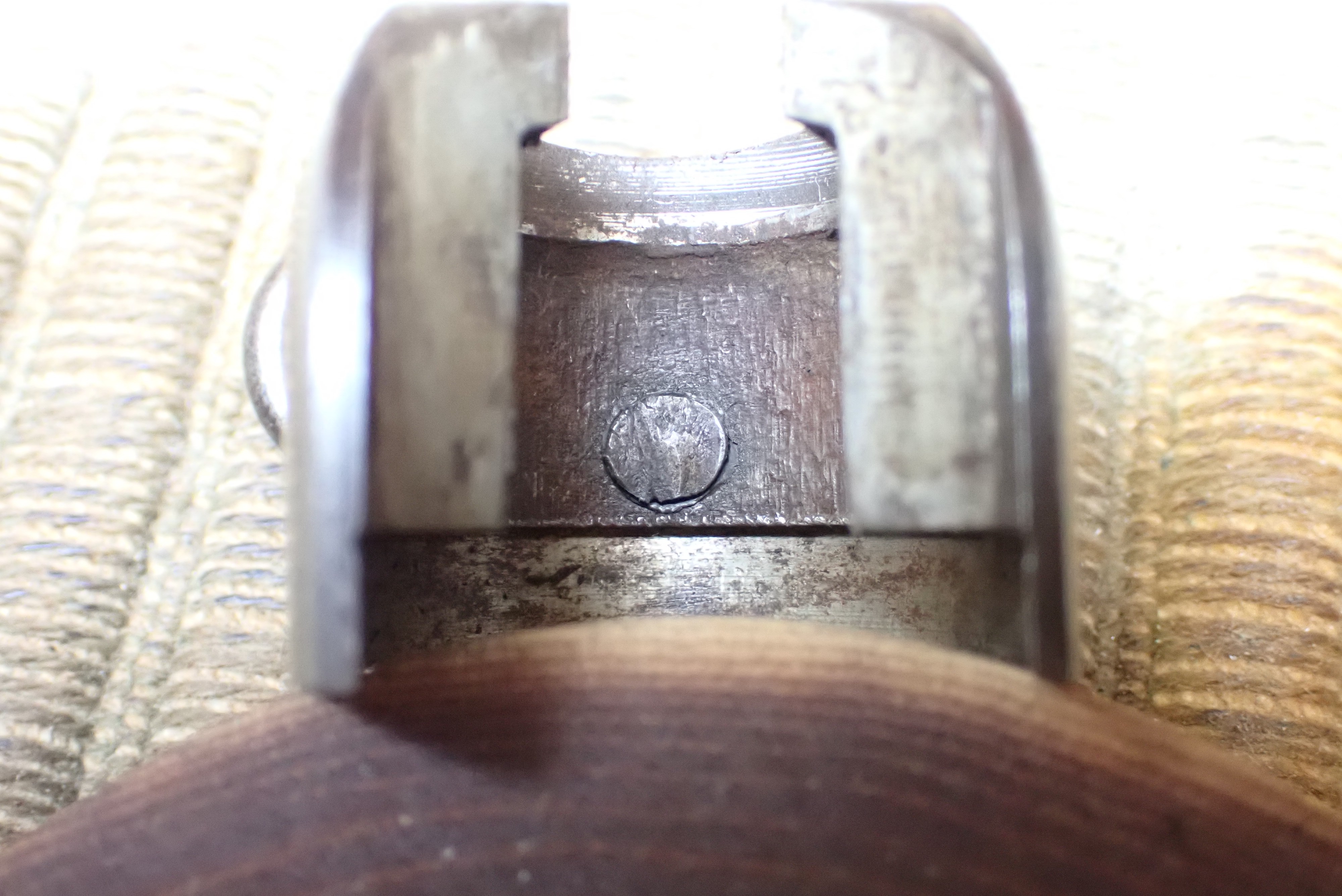

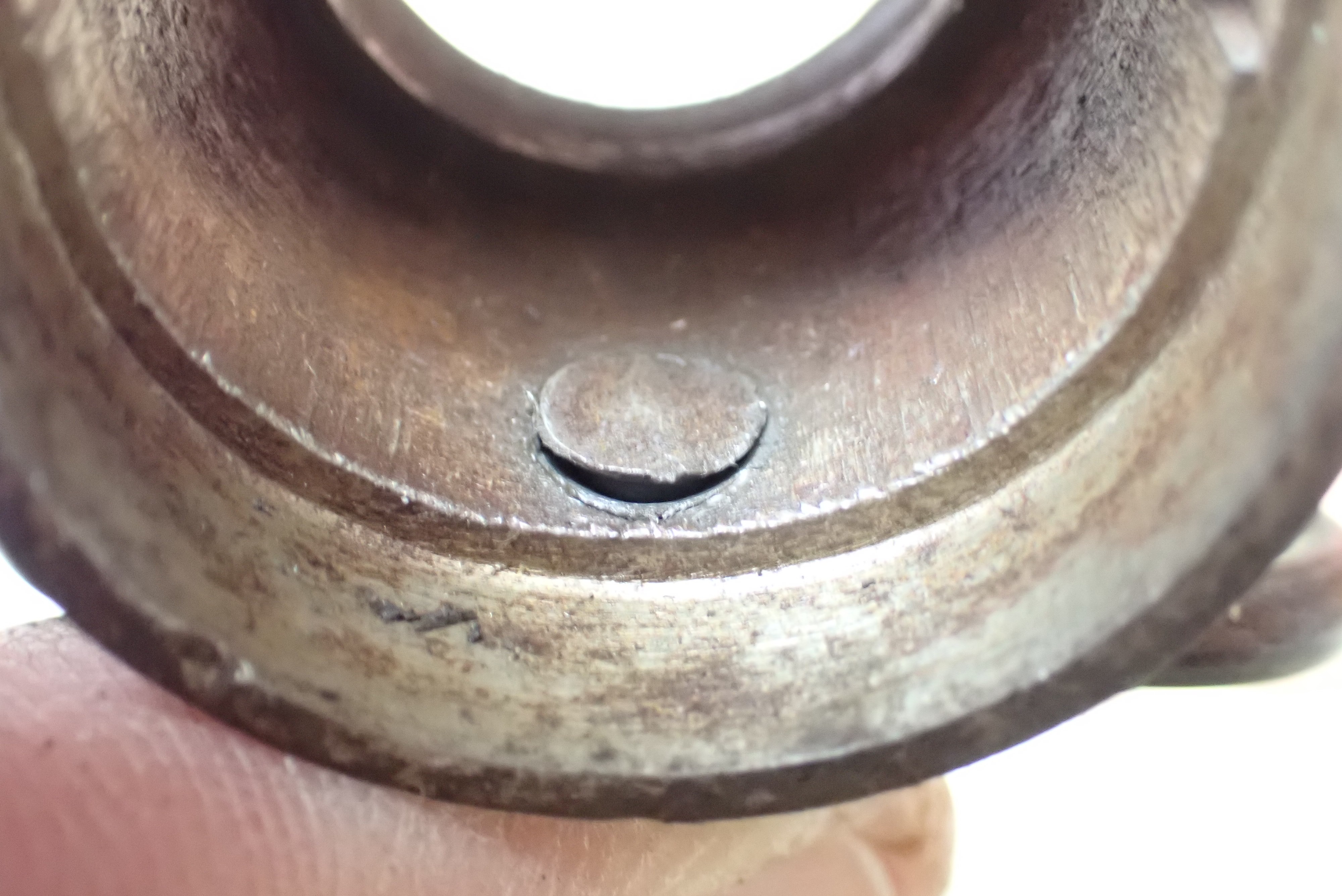

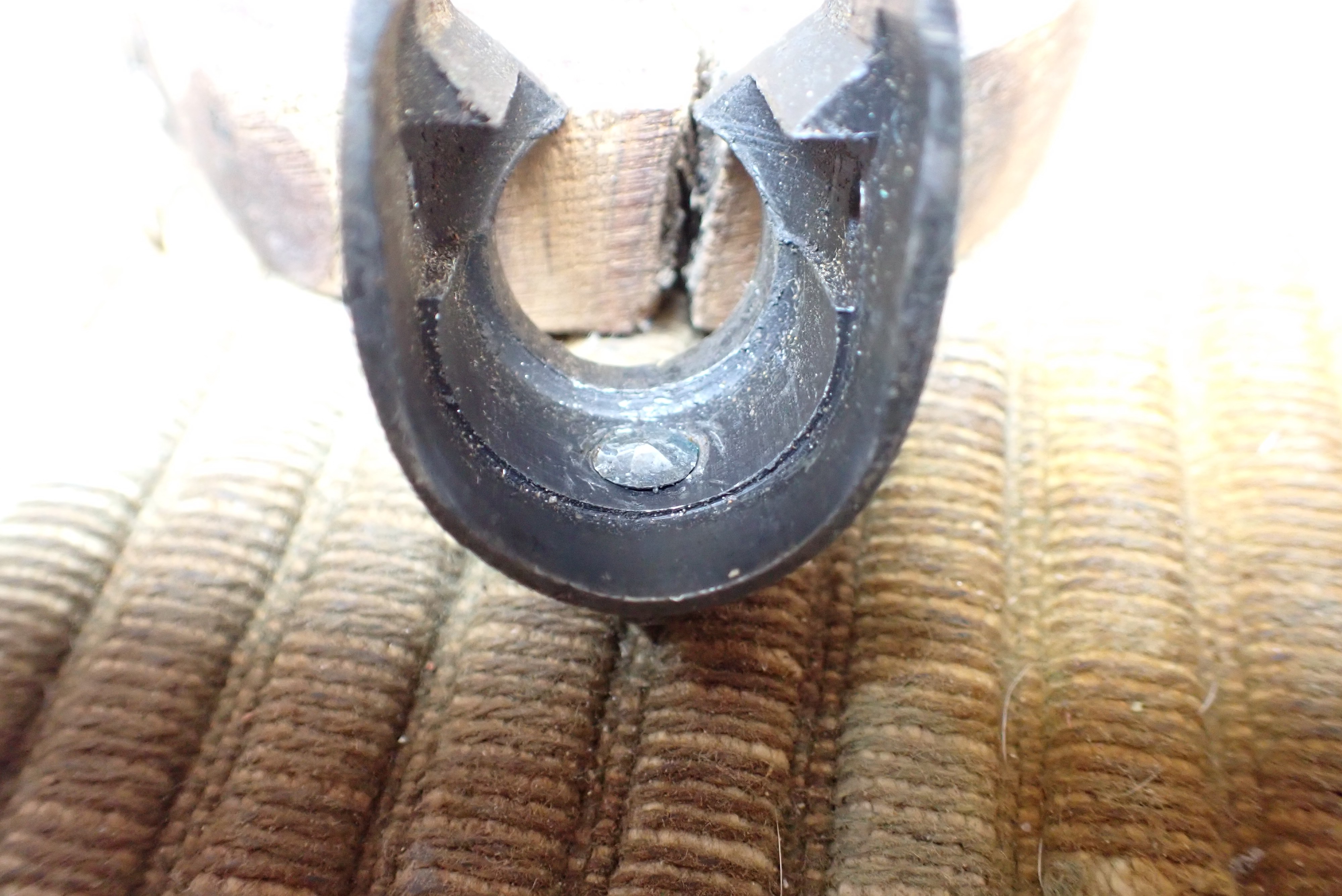

Forum Posts: 1183
February 2, 2026 - 7:06 pm
I wondered if anyone could please show a photograph of how the sling eye is attached inside the fore end cap of a 1894 Winchester rifle? I want to install sling eyes on my rifle and want to make sure I do it correctly, Thanks Bob.
Here’s a few examples from 1894 carbine:
An 1894 Rifle outside letter range, and on the fence as to whether it was added or not.  Have a few other examples I can check if I remember this weekend.
And an 1886 that I think was added (forend cap with sling ring provision), letter doesnt mention sling, but the install looks same as Bob’s example).  It does swivel freely, unlike the 1894 examples.

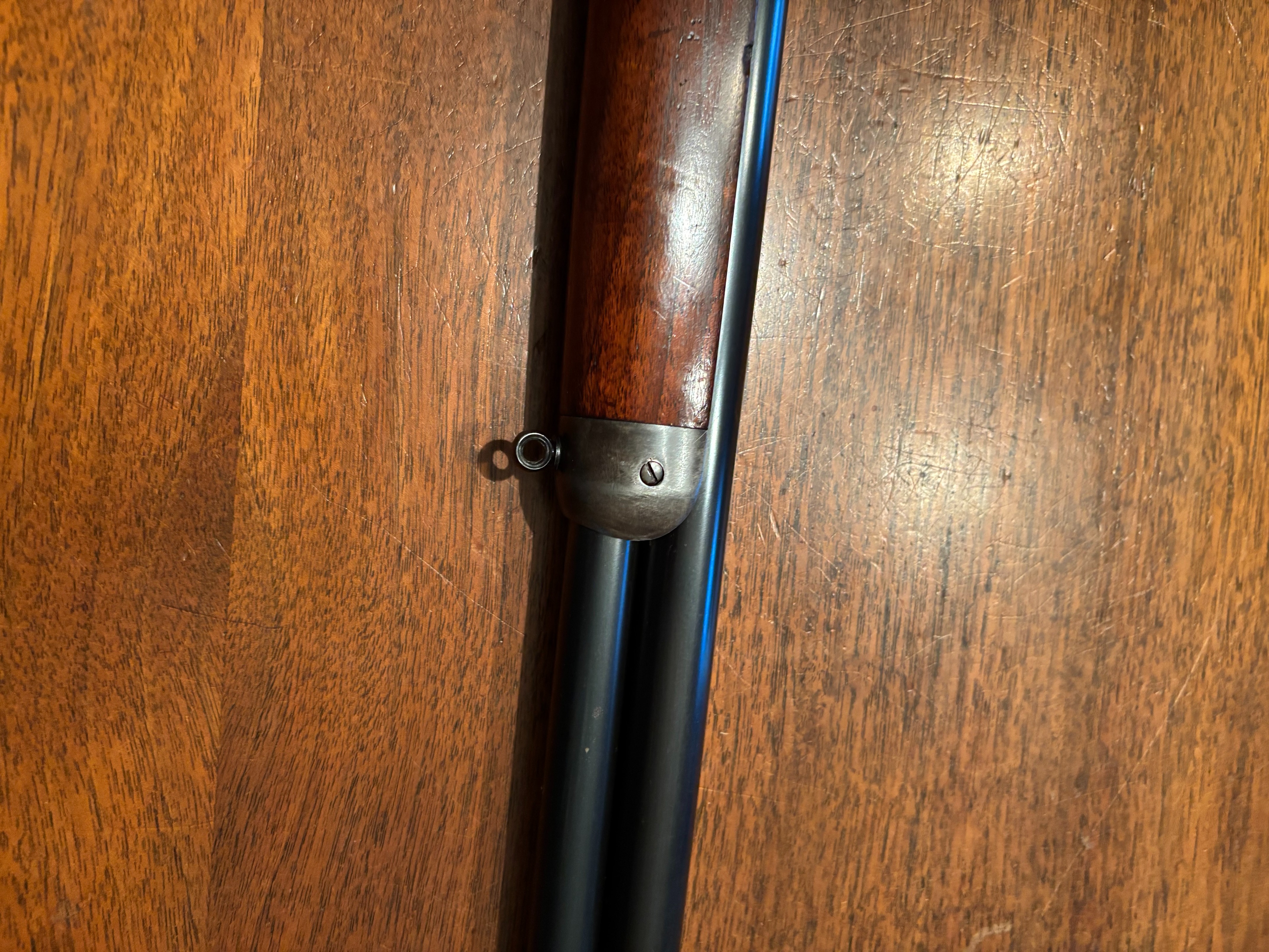

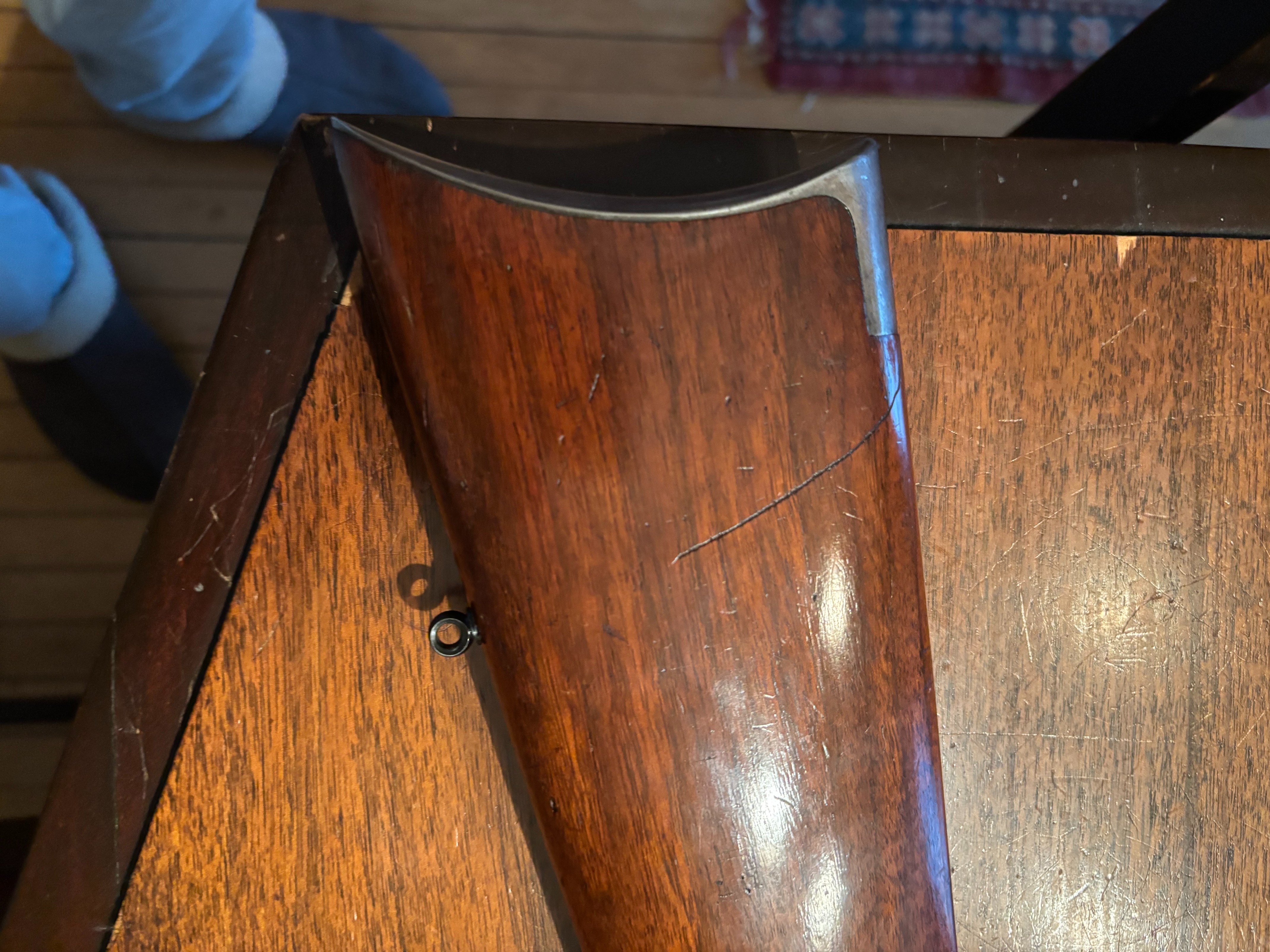

Robert Jambrosic
Forum Posts: 17
December 30, 2023
February 10, 2026 - 1:41 pm

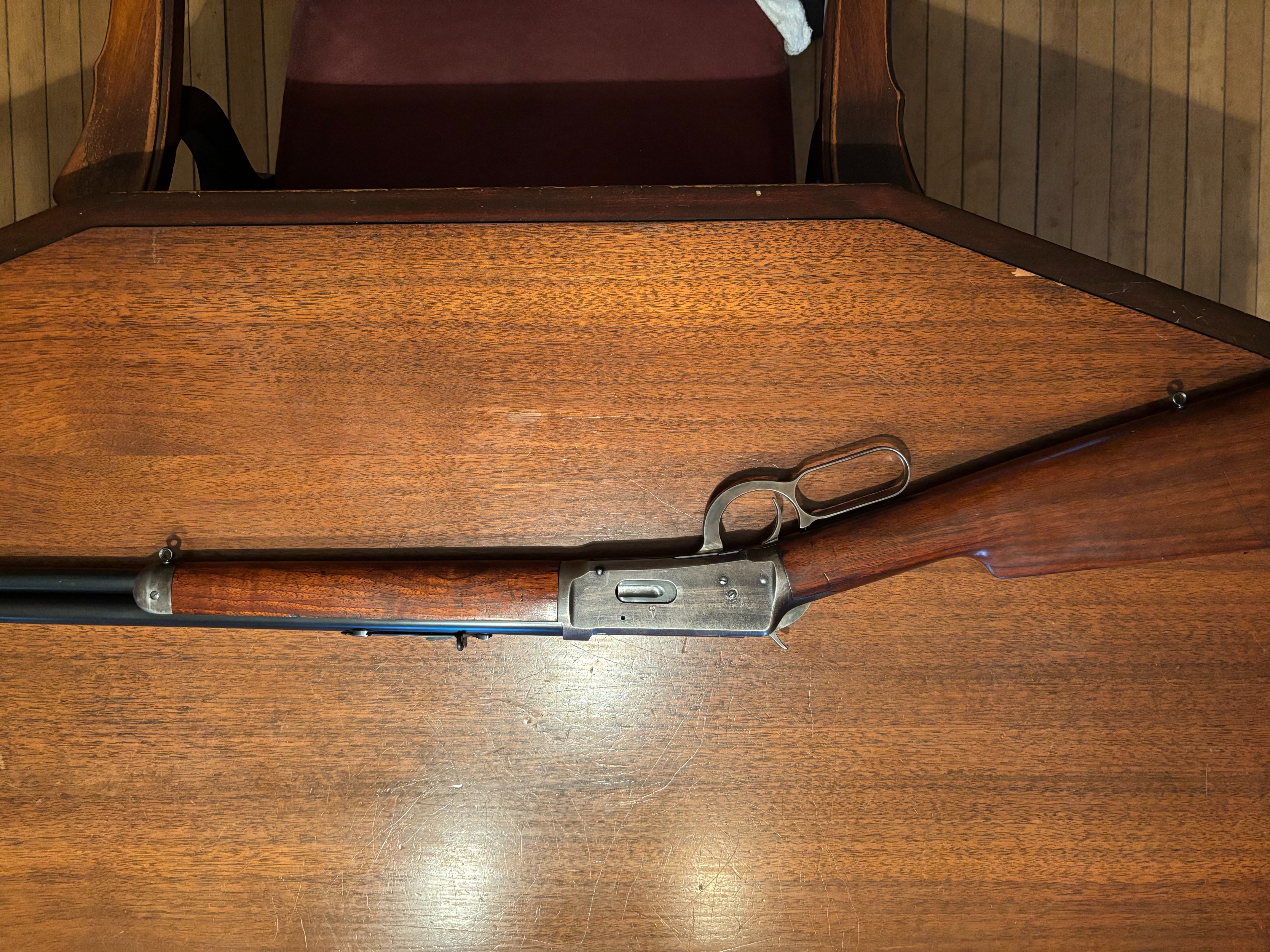

IMG_1745.jpegIMG_1744.jpegIMG_1742.jpegI have finally got my sling eyes attached to my 1894 sporting rifle, thanks for all the kind help from members with the advice, and photos.
Bob.
Forum Posts: 14975
February 10, 2026 - 3:43 pm
Bob.
They look good!
