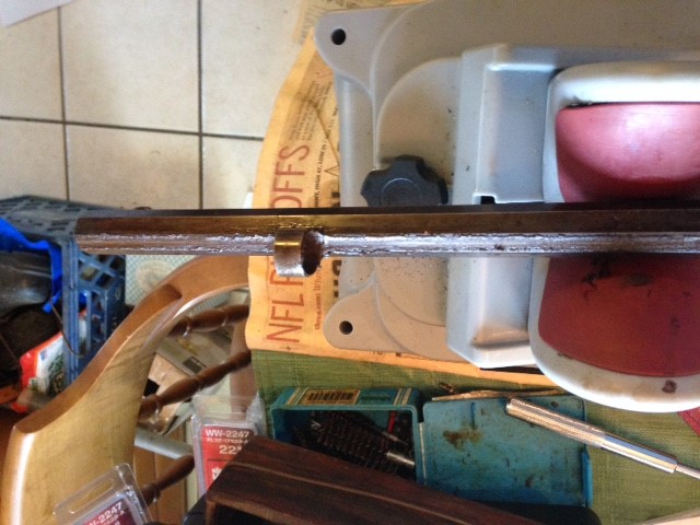

Turns out my 1894 has led a rough life recently. Lots of surface rust on and under the butt plate and a few other places. Bore patches still coming out brown. Pin that holds the magazine tube is frozen, will have to let Kroil work on it overnight. Looks like getting this old girl cleaned up will take a fair bit of elbow grease….and Kroil…..and copper scrub pads. No pitting so far so it looks like the abuse was recent, think it was probably stored in an unheated Montana building all winter.
Guess I need to continue this thread in a more appropriate place, still no pitting or major damage to the bluing but it was a lot worse than I thought. What I thought was decades of grime was actually fairly new rust soaked in oil.

Here’s the “before” pics. Sorry for the delay, phone and laptop fighting again.

Good on ya for using copper pads. Bronze wool, brass bristled ‘tooth’ brushes, brass scrapers and even a small piece of .010″ stainless steel shim stock have done wonders for me. I never tried anything, besides Hoppe’s No. 9 solvent, but have heard that Kroil is great stuff. With the aforementioned implements, I have been able to clean tons of rust without causing damage to the actual patina and remaining bluing. Good Luck!

Looks like it went pretty well, only have a few small areas of pitting and a little blue loss here and there. I’ve always used 0000 steel wool for light surface rust but this is the worst mess I’ve tried to tackle. Have a few stubborn spots soaking, will hit them again on a few days.
Copper seems to work much better, would have never gotten it done right with steel wool.
Kroil is great stuff, works just like it says with no nasty traits. Even smells good!

Finally got back to work on this old 1894, did all I could to reverse the damage done to the metal and prevent further damage. Almost forgot to remove the rear sight, plenty of surface rust under there as well. EmbarassedBore up cleaned OK, wasn’t as bright as I was hoping for. Bore scope images a bit disappointing but should shoot just fine. First coat of tung oil/mineral spirits soaking into the wood as I try to type this, excellent thread on the subject on this page.

Thanks! Finished up with the wood last night, will go over it again tomorrow night and if all looks good will go back together with her. Wood still shows the marks from many years of hard use but a few coats of tung oil made a nice difference.

Thanks for the kind words and for taking the time to post your tung oil method, Wayne. For clarification I did not add any stain, just applied three coats of 50/50 tung oil/mineral spirits. If I had tried to repair the wood or remove the oil stains, scratches and dents I would have had to refinish and stain it. My goal was to preserve the character of this hard-working old gun while giving it a good cleaning to prevent further damage.
