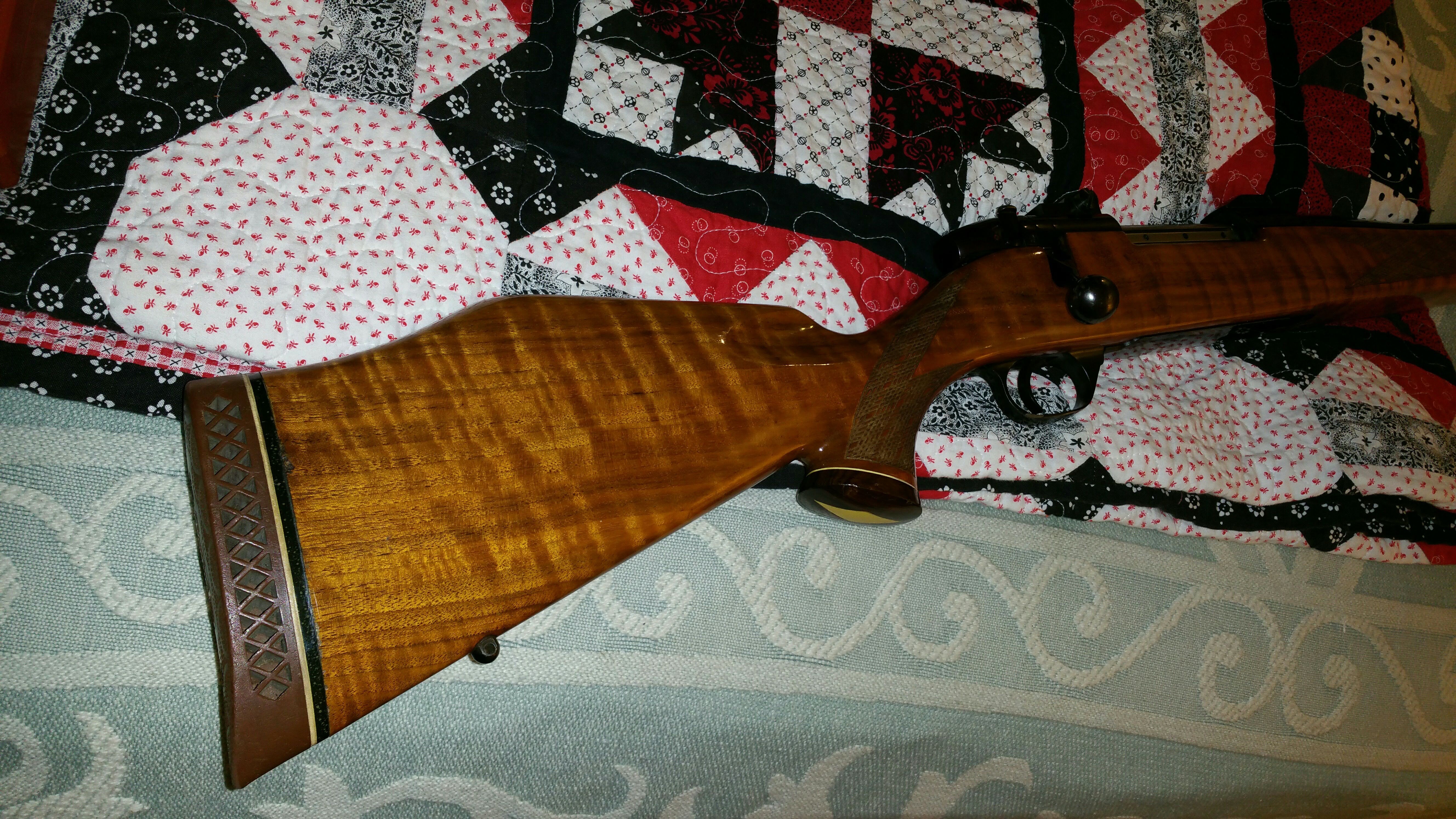

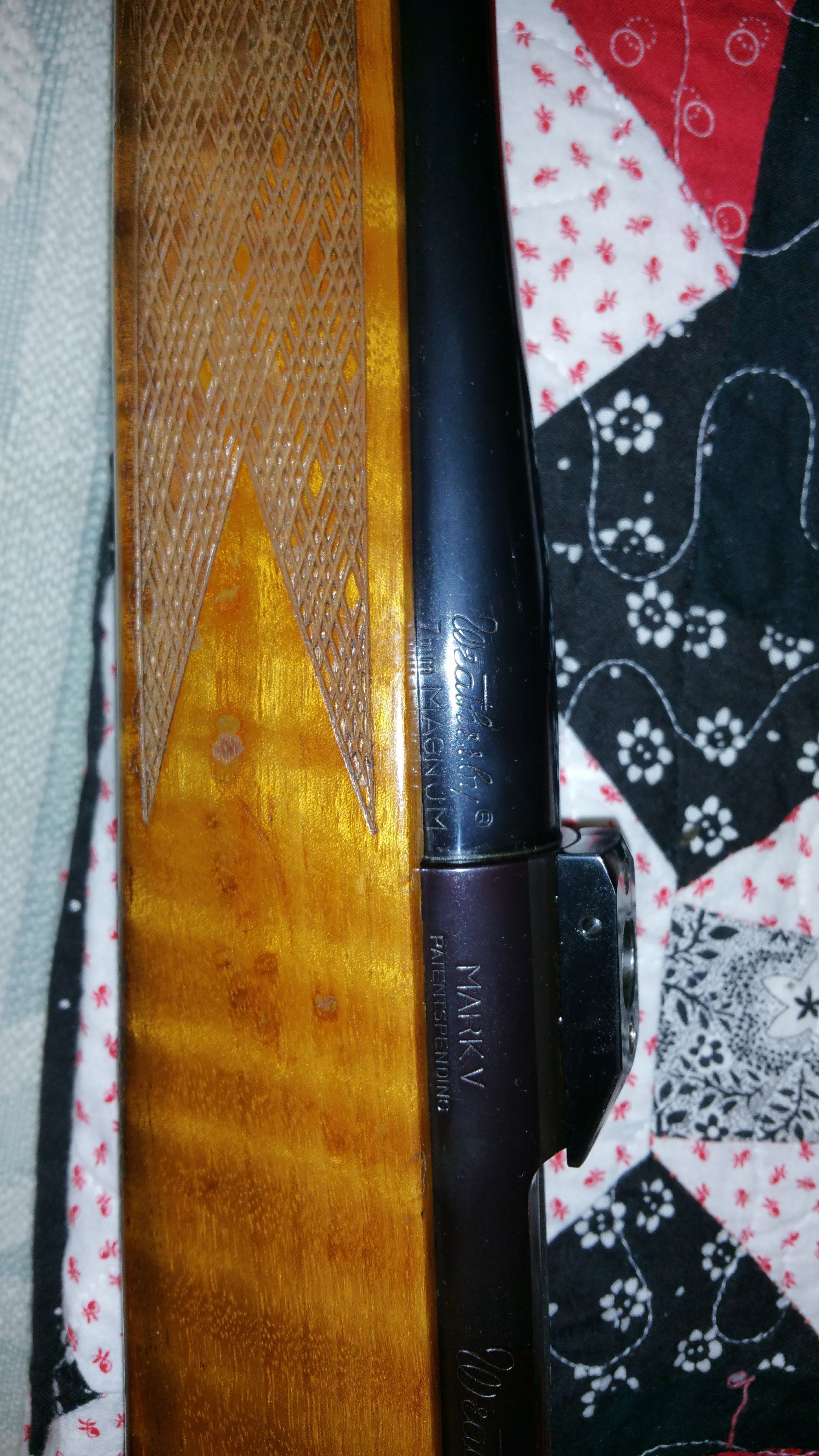

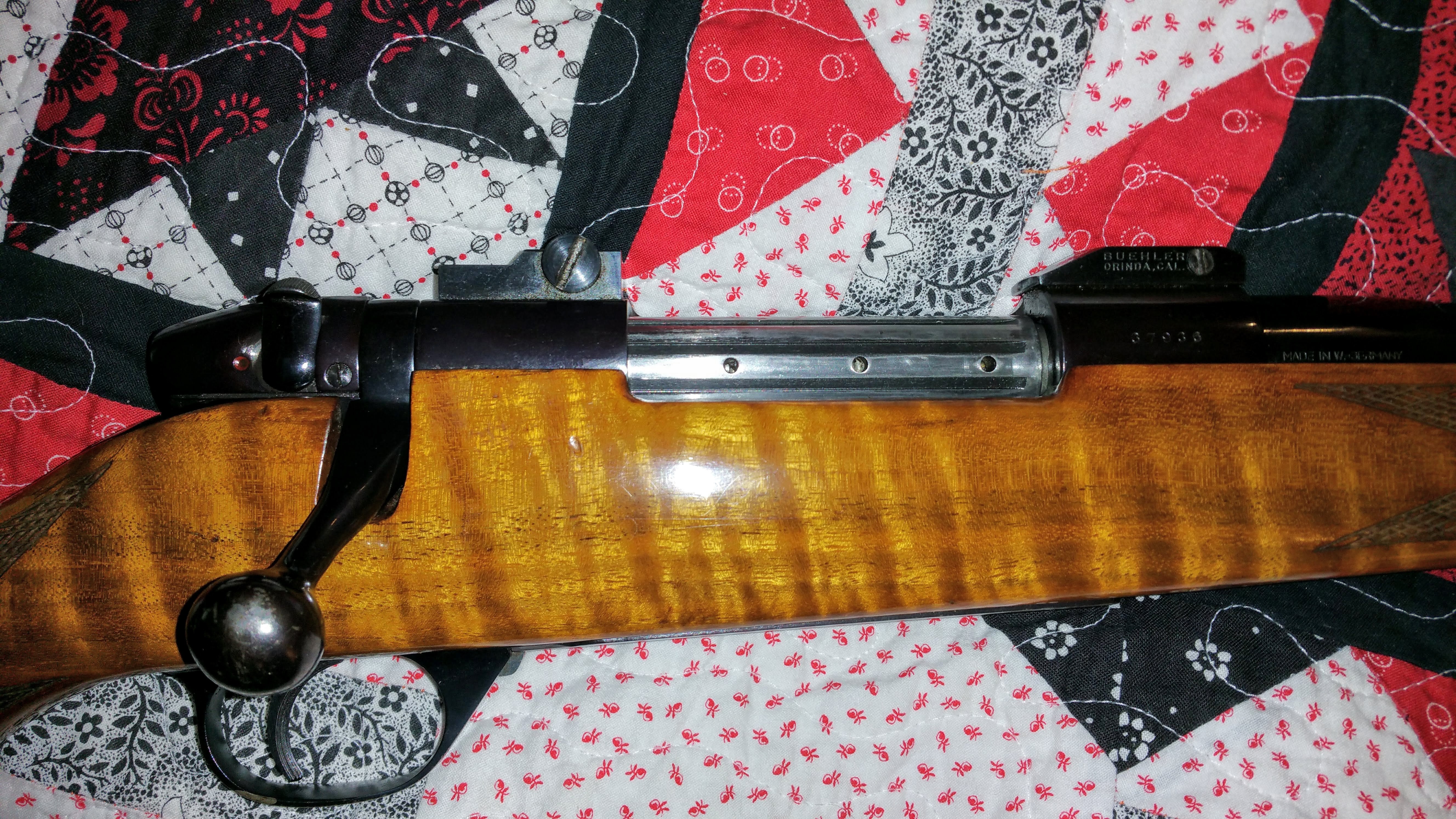

Update:  when I picked up the two rifles I left with him,  I brought Ron another minor mystery gun to investigate and fix, an early (“patent pending”) Weatherby Mark V built by J. P. Sauer und Sohn about 1959 and stocked in Southgate with a beautiful tiger tail pattern blank of Claro Walnut.
This rifle seemed remarkably butt-heavy and one of the attachment screw points in the face of the recoil pad was torn and distorted. Some idiot had removed the pad without lubricating the screwdriver shank.
A little shaking and tilting told me an inertia cylinder recoil reducer had been installed in the buttstock, which would have been understandable in a .340 or even a .300.
But this rifle was chambered for Roy’s most underappreciated cartridge design, the 7mm Weatherby, a short magnum almost identical to his very popular .270 Weatherby,  differing in bullet diameter by only .007″. Neither is in the least uncomfortable to shoot in a Mark V by shooters of average size.  The LOP of this rifle had not been shortened so I just don’t know…
Ron called me this morning and said the gun was ready. When he pulled off the pad he found not one but TWO recoil reducers, which he removed at my request. Even with its 24″ #1 contour barrel, the gun should now balance a little weight forward and not feel so whippy.
I didn’t want to replace the original brown, ventilated Pachmayr Whiteline pad because the Weatherby “Tomorrow’s Rifles Today” logo is molded into its face and duplicates are unobtainable. To clean up the buggered screwdriver puncture, Ron suggested a pair of neat access holes be milled through the pad face, colinear with the attachment screw heads, in the manner of the Silver’s pads seen on Holland, Rigby and Purdey double and magazine guns. I agreed.
