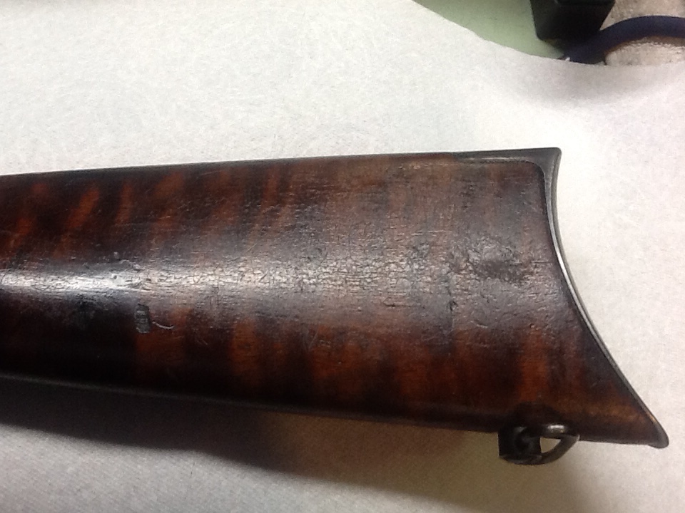

Gentlemen,
As shown in several of your examples, I would love to restore the beauty of my 1894 stock while not destroying it’s originality. Looks like my stock has received an additional coats(s) of lacquer or varnish that has failed.  Do you think this stock would be a good candidate for rubdown with denatured alcohol / min spirits followed by tung oil?  I would appreciate your thoughts.

Jim M. said
Gentlemen,
Jim
I would definitely remove the added coats of lacquer or varnish, then soak the stock overnight in mineral spirits.  After letting it hang to dry for at least a day you might as well steam out any dents before hand rubbing with tung oil to restore the original appearance.

– Since I don’t know the history of the rifle, I am speculating that varnish/ lacquer has been added and the “crazed” area in the butt stock is the failure of this added finish.  Is this a reasonable assumption?  What method and materials would you recommend to remove this material?  I was thinking a rub down with min spirits and superfine steel wool might do it.
–  I have read about soaking stocks in mineral spirits for the purpose of removing lubricating oil that has penetrated the wood.  In your opinion, is this the purpose of the soaking procedure?

You can use steel wool to remove the “varnish” coat.  The right chemical will remove this added coat.  Try mineral spirits first and you can use a short bristle brush or a piece of towel or t-shirt, or the fine steel wool.  Since we don’t know what the finish is, mineral spirits is the safest way to start.  If that doesn’t work move on to acetone and then lacquer thinner if that doesn’t work.  Denatured alcohol can also be tried but I believe that is primarily for epoxy type finishes.
The soaking in mineral spirits after the varnish has been removed will remove old hand oils, grease and other dirt from the original finish and also remove and smooth out the original linseed application so that you eventually end up with an even finish.  The soaking will not remove the original stain that is in the wood.  I have even boiled stocks in distilled water when a stock is extremely oil soaked and has lots of dents, but this does remove the stain and that is when I have applied alkanet.
Once you have all the finish removed to where you are satisfied, that’s when you steam out any dents if you want to do that.
The final and most gratifying step is the application of the finish.  I apply pure tung oil thinned 1:1 with mineral spirits for the first 5 coats.  Apply the finish with a 100% cotton patch (t-shirt or I use 2″ squares of old towels).  After the first coat, hand rub the wood across the grain for about 10 minutes about an hour after each application of finish.  Allow the finish to cure for at least 24 hours after each of the initial 5 coats.  After that I use the tung oil cut 1:2 with mineral oil for however many more coats are needed to get the look I want.  During this procedure I let the stock cure for at least 48 hours between coats.  Occasionally you might need a light rubbing with brass wool or steel wool between coats (after 4 – 8 coats) but I’ve never found a set rule for this – it’s mostly a matter of each project being a little different that the previous one.
The number of coats required will be up to you and the way you want the final finish to look.  The more coats you apply, the deeper and glossier the finish.  Gloss can be cut down with brass wool rubbing.  I have found that a refinish job turns out the way I want somewhere between 4 and 10 coats.  New wood has always taken me at least 15 coats, but never more than 20.
Keep in mind that a cured tung oil finish is permanent.  Nothing, short of sanding, will remove a tung oil finish.  The good thing is that it is very easy to touch up and blend in if a repair is required later.  The advantage of tung oil vs. linseed oil is that the tung oil finish will be more waterproof than a linseed oil finish and the tung oil finish will not darken with age as the linseed oil one does.  The advantage of linseed oil is that a cured finish will be removed with a good soaking in mineral spirits.
Well, that’s the way I do it.  There are many other finishes and everyone has his own preference.
