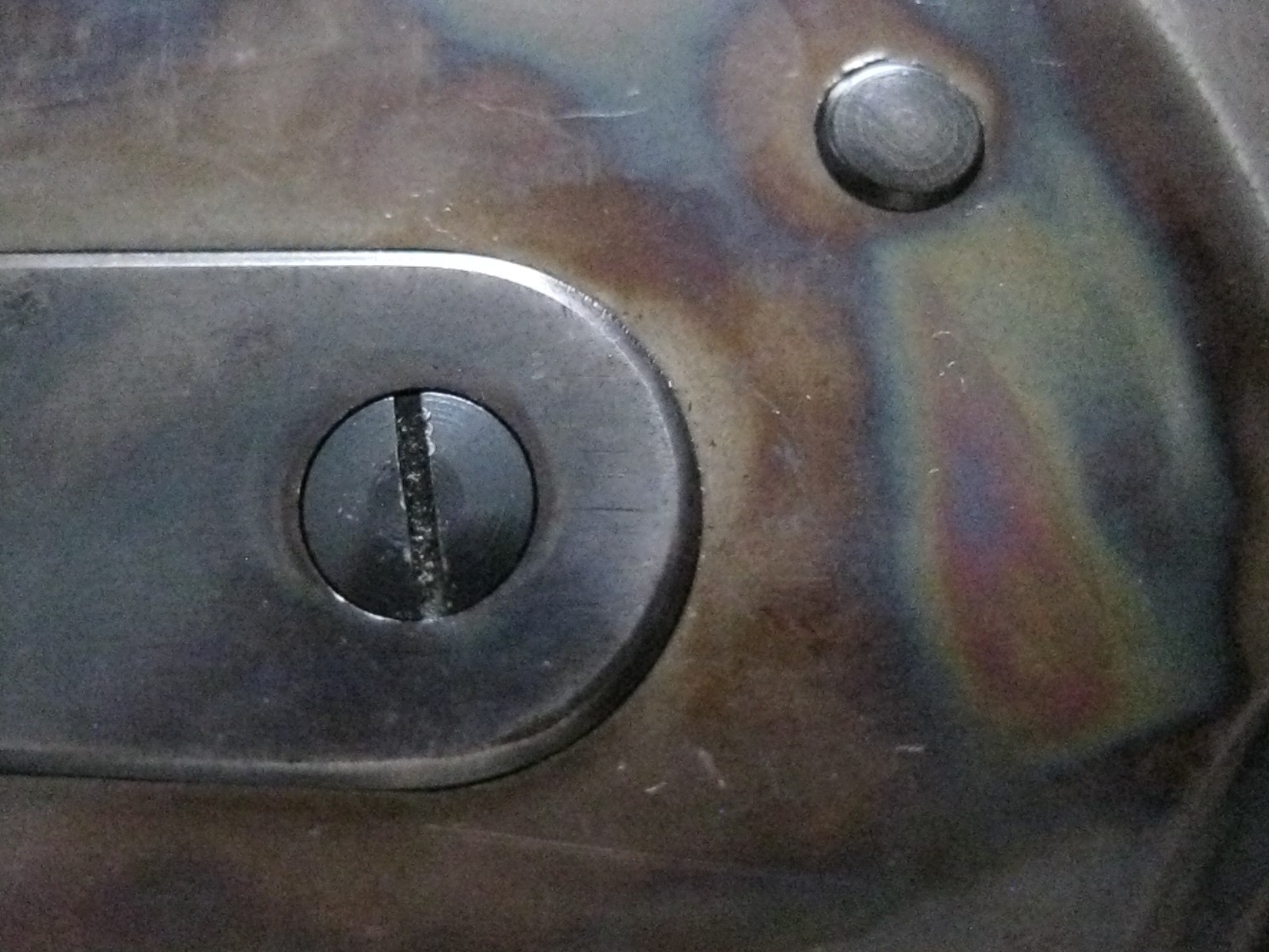

Here are the photos of the receiver screw in question. The question is it original, factory replacement or after market? Or can we tell?

Forum Posts: 4995
November 2, 2017 - 5:57 pm
That a repo screw as well as the one in the loading gate.

November 2, 2017 - 8:38 pm
The hammer screw is an aftermarket replacement as well as the loading gate screw.  The cartridge stop screw is probably one too, though it’s hard to tell from the fuzzy photo.

OK that does not give me a warm fuzzy. Does anyone know where I can get an original screw(s)? Does anyone make a factory spec replacement? How does this effect the value of the rifle? Nuts!
Forum Posts: 4995
November 4, 2017 - 12:29 am
The problem you have is your gun looks to be a high condition gun and trying to find original screws to match would be rare.  I think what you might try is to have the screws refinished so they can be passed off as original.

My assessment is that they are reproduction, BUT, on the other hand it’s a screw.
Years ago I had problems finding correct buttplate screws, and got tired of repairing buggered ones. I had 5K buttplate screws made, identical to the originals, sold 4500 of them, and now I see quite NOS buttplate screws on ebay 🙂
Screws are easily made and replaced,  if you want a well made Winchester screw made to spec, go to Bob Knapp (aka Winchester Bob on the net). Bob is a good friend and is meticulous about his parts.
Also, on many early Winchesters, especially case hardened frames, the screws were case hardened not blued. Winchester used a different wood/bone ratio on small parts, so the colors are a bit thinner (not as bright and bold) and did not have a shellac/lacquer protective finish applied, so they “silvered out” rather quickly.

November 4, 2017 - 3:39 pm
Respectfully
Thanks for that information, Mike.  I have often seen Winchesterbob’s site but have hesitated to order from him as he doesn’t post any pictures for his stuff.  On sites with photos one can usually see things like if the screw heads are oval, if the slots are SAE or chinese narrow slots, if there are machine marks on the heads or, in the case of the short lower tang screws for 73, 85 and 86 lmodels, if the are simply cut off buttplate screws or if they have the correct taper for the shorter length.

Now my next question is what is good? Wincacher pointed out that the heads should not have machine marks and be polished and Mike pointed out that screws for the early rifles were heat treated and not blued. Where can I find them or have that done Mike? Given that I know the what, not the how. What is the process to polish the screws if necessary. If blued do I just buff then out and polish. I know you guys know the tricks of the trade. Hope you guys had a good weekend.

Forum Posts: 4995
November 5, 2017 - 7:06 pm
Kirk,
The NOS ones I saw on Ebay you can see the circular machine marks in the head and NOS may only mean the 20 or 30 years. Mike said original screws were case hardened but with less color so they tend to have a silvery gray cast to them. I have played with making new screws look old by using heat and cold blue then removing the color and after a few tries you might get something that looks right. You can clean up the screw heads either with a lath or  in a drill and take off the machine marks with sand paper.

November 5, 2017 - 7:16 pm
Kirk,
To take the machine marks off screw heads I chuck them in a drill and use 220 grit emery paper with a drop of cutting oil.  This leaves a nice, smooth clean metal surface but does nothing toward widening those narrow chinese screw slots.  Then I degrease them and let them sit in brine overnight and then air dry wet.  I get some interesting rust marks that way.
