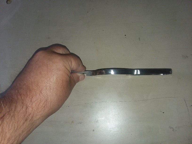

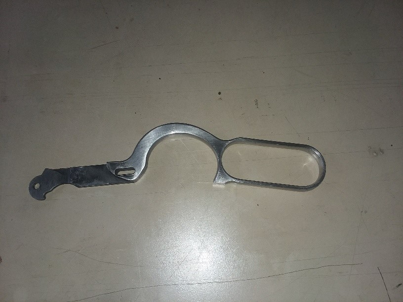

Sure. Here’s a couple of pics of the lever (which is the worst condition part to be saved) after sanding with 800 grit paper. I’ve also completed the barrel bands. Once all parts have been sanded with 220, 320, and 800 grit paper, I’ll then buff to a polished surface before sending off for hot blueing. I could be wrong, but my philosophy is to do as much removal of rust by hand being careful not to change the profile of the surface being sanded nor putting localized waves or indents where a pit, or series of pits reside. I probably have 2 hours in the lever at this point, doing 75% of the work by hand.
