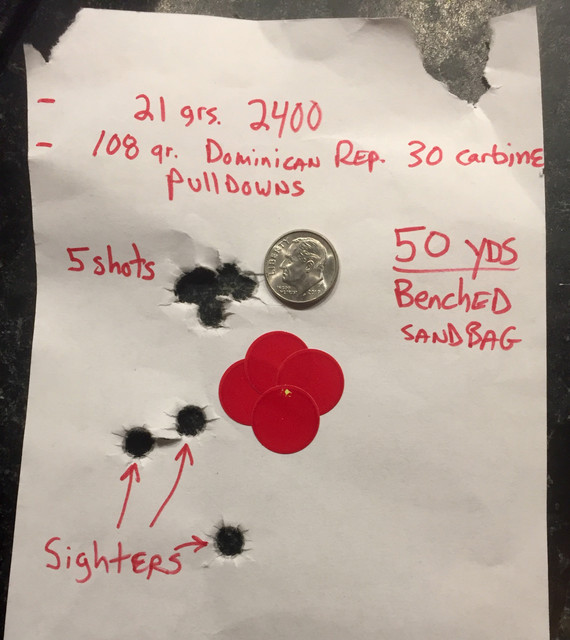

No bore scope, but it’s on my short list of items I need.  Amazing, even with the sewer pipe bore,  rifle still smacks the 6” steel plate @100 yds consistently, even with my M1 Carbine bullets, downloaded a bit.  I have a 1953 Carbine also in 30-30 my father bought when he got back from Korea.  Put on a Lyman 66 and was able to do this @50, off a sandbag.  That’s a dime.
https://i.ibb.co/qMfjR524/IMG-5443.jpg
