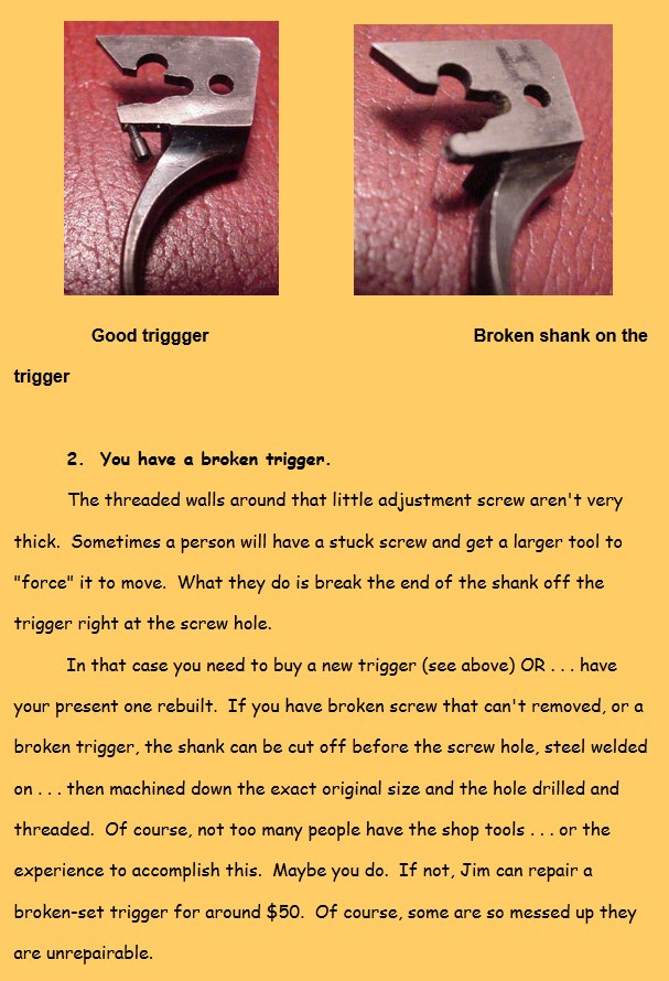

Then there is something messed up. Pull the stock and then you can look in there and see what is going on. You should be able to see as you try to set it, you can watch the catch moving and see if its missing the kickoff. Here is a copy of a article that will help you understand the set trigger.
