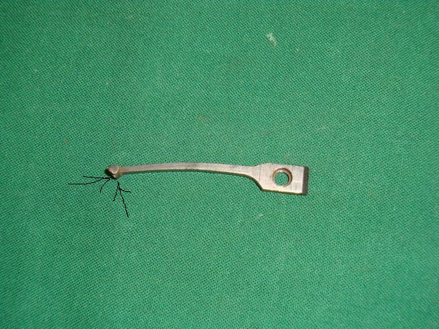

Here is a pic of a carrier spring for sale online but this one has some wear on it (see arrows pointing to wear).  The area indicated should form a sharp triangular shaped face across its length. (Click on the image to view)

Here is a picture of the carrier spring.  It does show wear.  There is a gun show this weekend and I will be on the look out for one in better condition.

That one doesnt look too bad from what I can see.  Most, if not all, that you find will be used.  For $10-15 its worth a shot (at least that is what I think they are bringing these days, maybe a little more if the screw is included)
