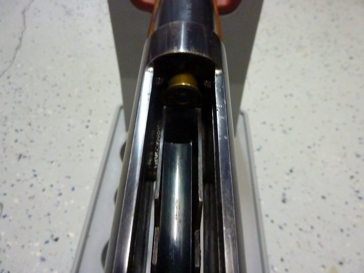

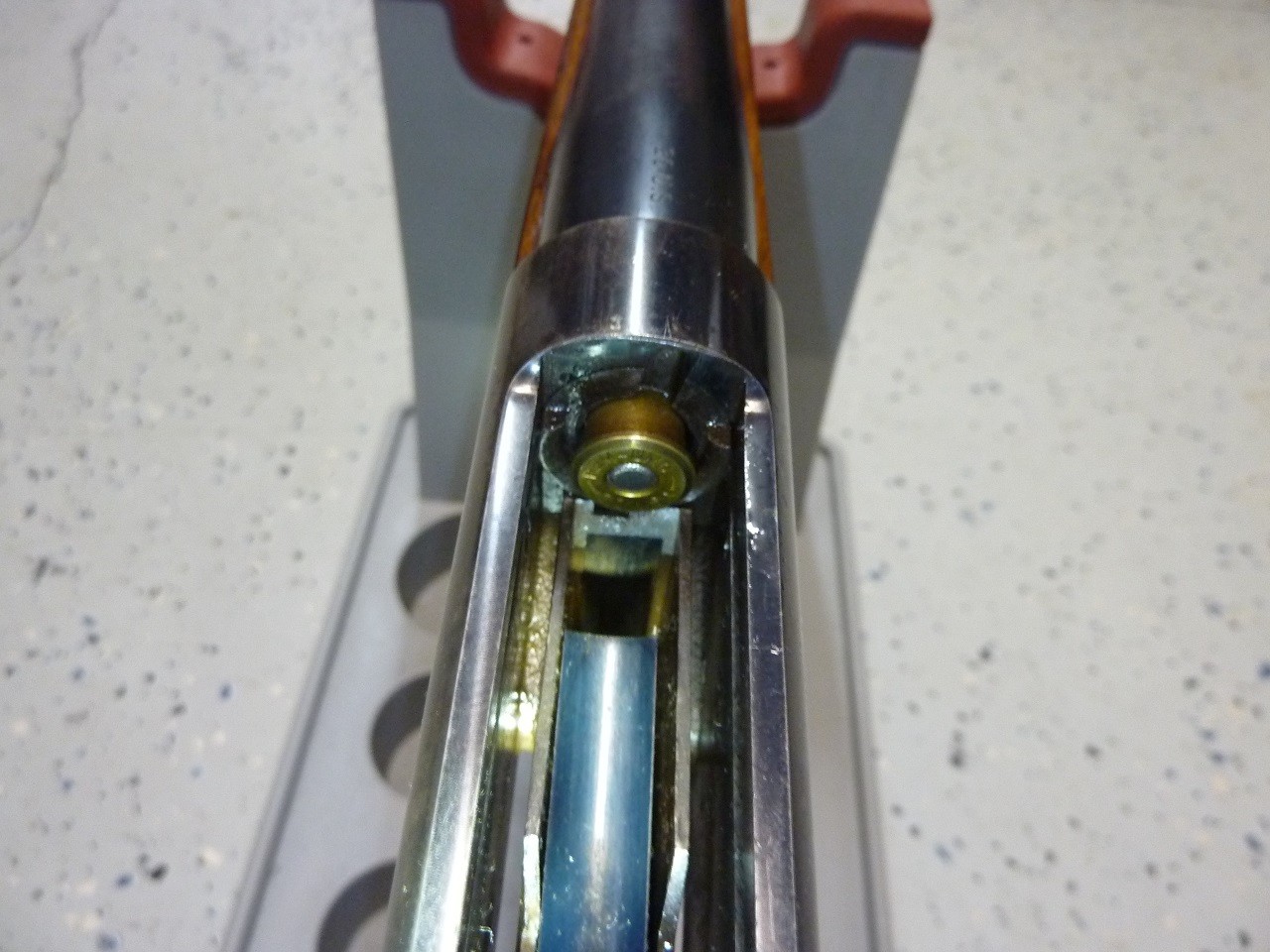

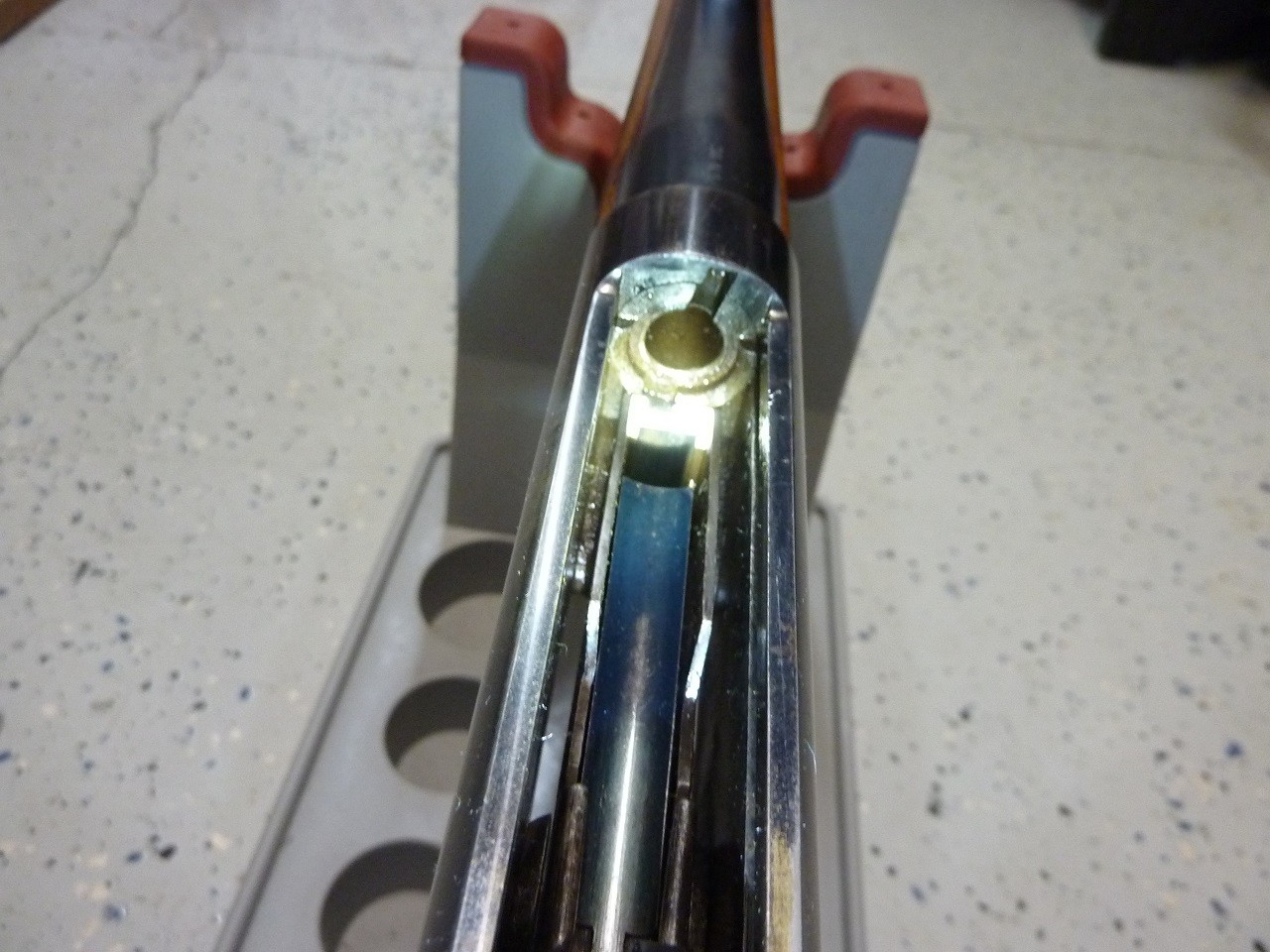

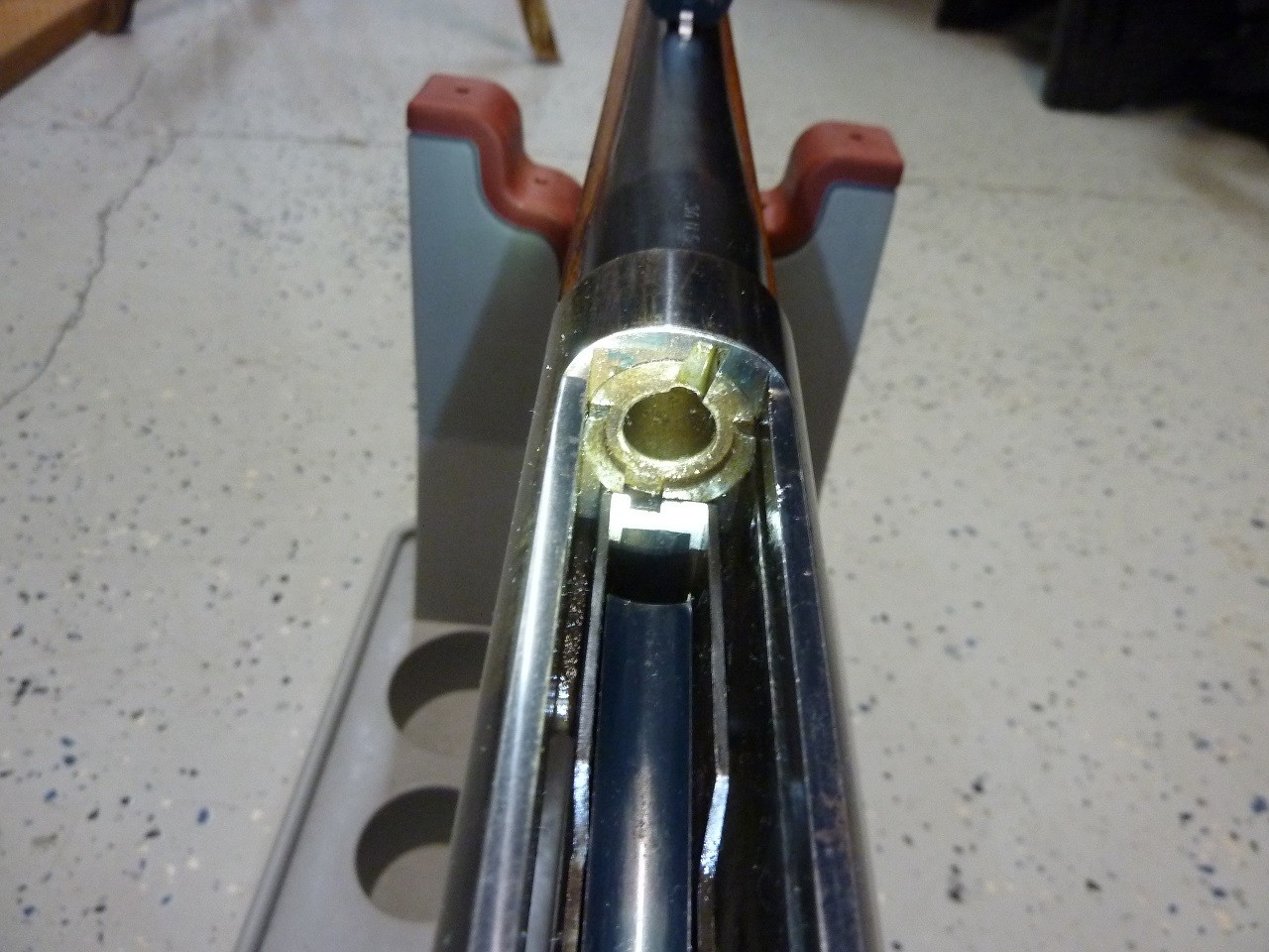

I just took delivery of a beautiful model 1895 in caliber 30-40 Krag in about 90%+ condition, but I went to chamber a round and noticed there is some roughness/corrosion in the chamber and the cartridge will not fully chamber.  In fact, it gets stuck about 1/4″ out from the chamber.  Is this something that can be remedied or should I consider returning the rifle?  I already tried cleaning it as much as I can, but no change.  I have 3 days to let the seller know and tomorrow (5/9/25) is day number 3.  The rifle is in excellent condition (including the bore), but just has roughness in the chamber so I would really like to keep it if it’s a somewhat easy and inexpensive fix through a quality gunsmith since I plan on shooting it.  I’ve attached some photos below showing the chamber along with a 30-40 Krag round in as far as it will go before it gets stuck.  Thoughts and opinions appreciated!  I think I’ll PM Mark Douglas with this issue as well.

Three thoughts come to mind:
1. Are you using a factory cartridge to test it?  A reloaded cartridge might not be sized fully at the base, although it may fit in another firearm with a more generous chamber.
2.  Did you use a bore scope to check the chamber on the off chance that an old cartridge neck is lodged in there?  At least you could examine the chamber in more detail.
3. Have you notified the seller of the issue and asked for a little more time to troubleshoot the problem?
Yes, I am using a factory-loaded round and have actually tried multiples and same result.  I do not have a bore scope, but there is a good amount of corrosion in the chamber and bolt face.  Thinking corrosive primers were the culprit.  I plan on contacting the seller tomorrow.

May 9, 2025 - 12:34 pm
Often, there is a reason a gun is up for sale.  It may well be the current seller had no idea of the issue.  This happens often among collectable rifles where rifles change hands and several of the owners never fired or even chambered a round.  But … one of the past owners did.

Well, I contacted the seller and the rifle is being returned for a full refund and even refunding the shipping cost.  Seller also sent me a return UPS label at their expense.  It’s very unfortunate the chamber is toast since the rest of the rifle is a good 90-95% condition and a perfect bore (other than the badly pitted chamber).  It even had the “KSM” marked hammer and lever link.  For those wishing to avoid falling into this unfortunate trap, take note of serial number 20677–model 1895 standard sporting rifle with crescent butt, standard buckhorn barrel sight (no receiver sight) chambered in 30 US / 30-40 Krag.  It’s my belief this rifle fell victim to the corrosive primers of the day.  Makes me sick to my stomach….
