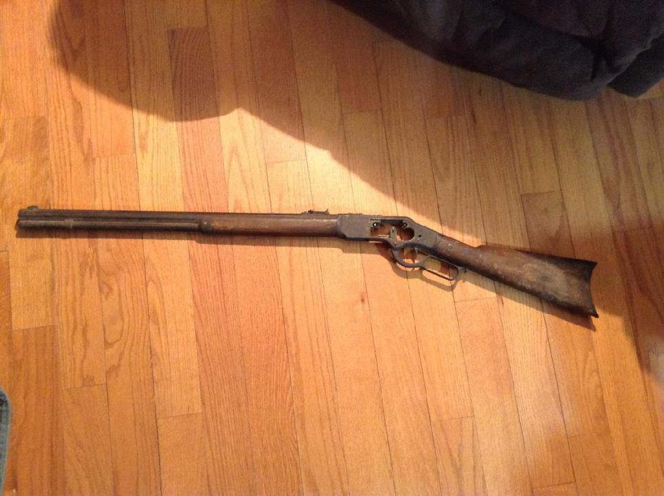

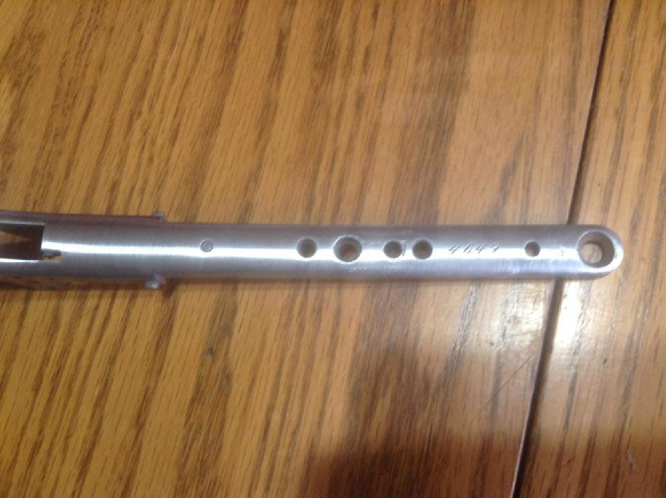

Please forgive me, I have no clue how to reply on this site. And can’t figure out how to submit a photo. Not computer literate. But I was mistaken, the serial number is 4649. There are no Indian markings at all. Was being used as a shelf support. Looked horrible, but I have busted my butt sanding and scrubbing and it is looking great. If my neighbor can help me with this computer I will resend. Thanks! Jim

 Jim, Please do not sand, file, or work on that gun until 1873man see’s a picture and runs a records check! T/R
Forum Posts: 4995
December 1, 2020 - 9:57 pm
Real Indian guns don’t have tacks and leather on them. The markings on the gun are on the wood and metal and can be easily mistaken for abuse. You might of cooked the goose that lays the golden eggs.

  Jim, Did you take any pictures before you started working on the gun? T/R
Forum Posts: 4995
December 1, 2020 - 11:41 pm
Jim,
As a guest you can’t directly post pictures. You have to host them on a third party site and then link to them or email them to me and I can post them. My email is below.

Here are the two pictures you sent.
