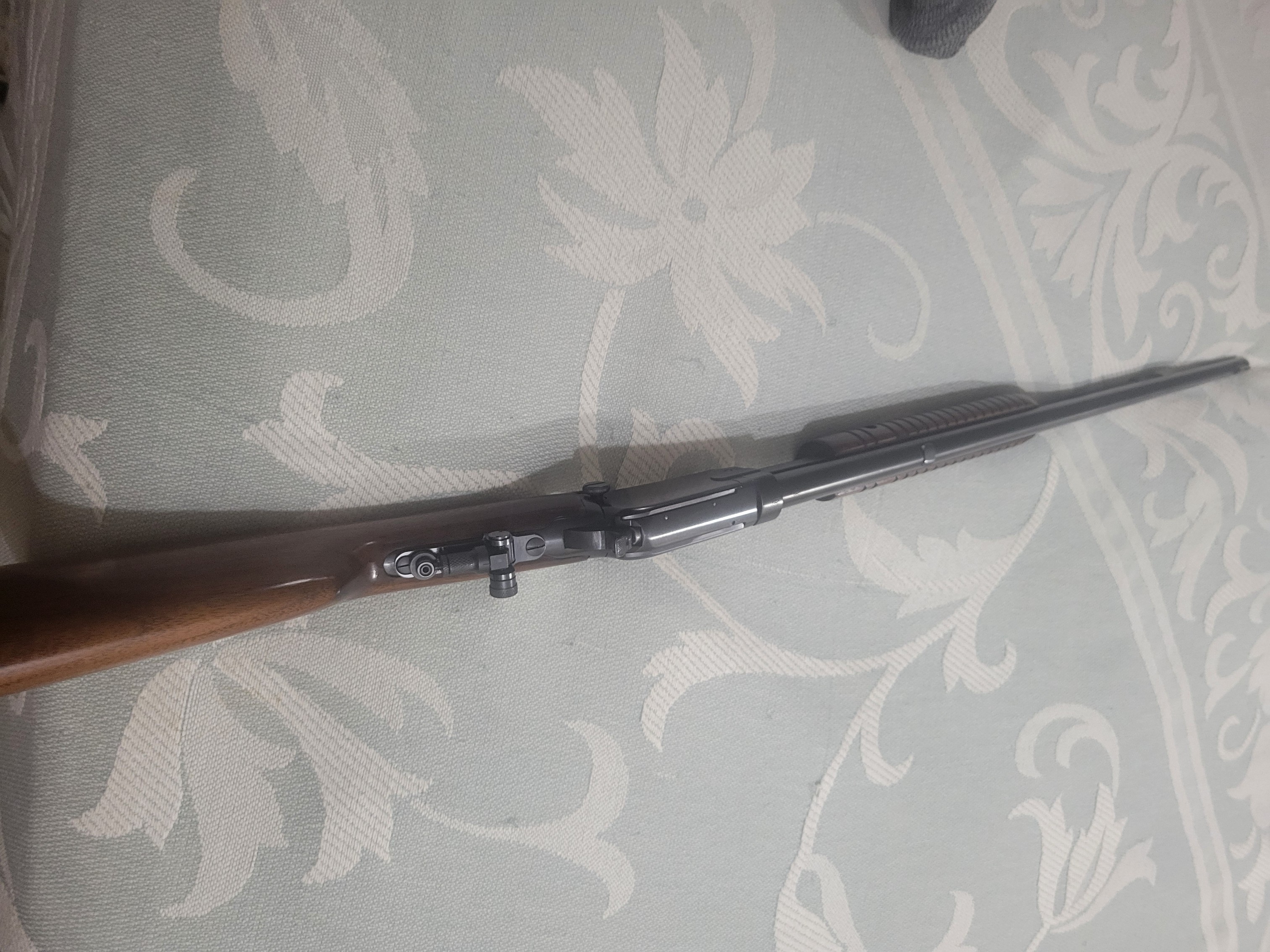

Got the M62 back and here are some pix. I asked if they shimmed the loose dovetail blank and was told they staked it, which I take to mean peened. I’ve got a Redfield Sourdough up front and the tang aperture with low light disk gives a great sight picture. Taken down with the tang sight folded, it slips into a Boyt two pocket case like it was made for it.  20240626_110548.jpg20240626_110449.jpg20240626_110434.jpg20240626_110348.jpg20240626_110323.jpg20240626_110320.jpg
