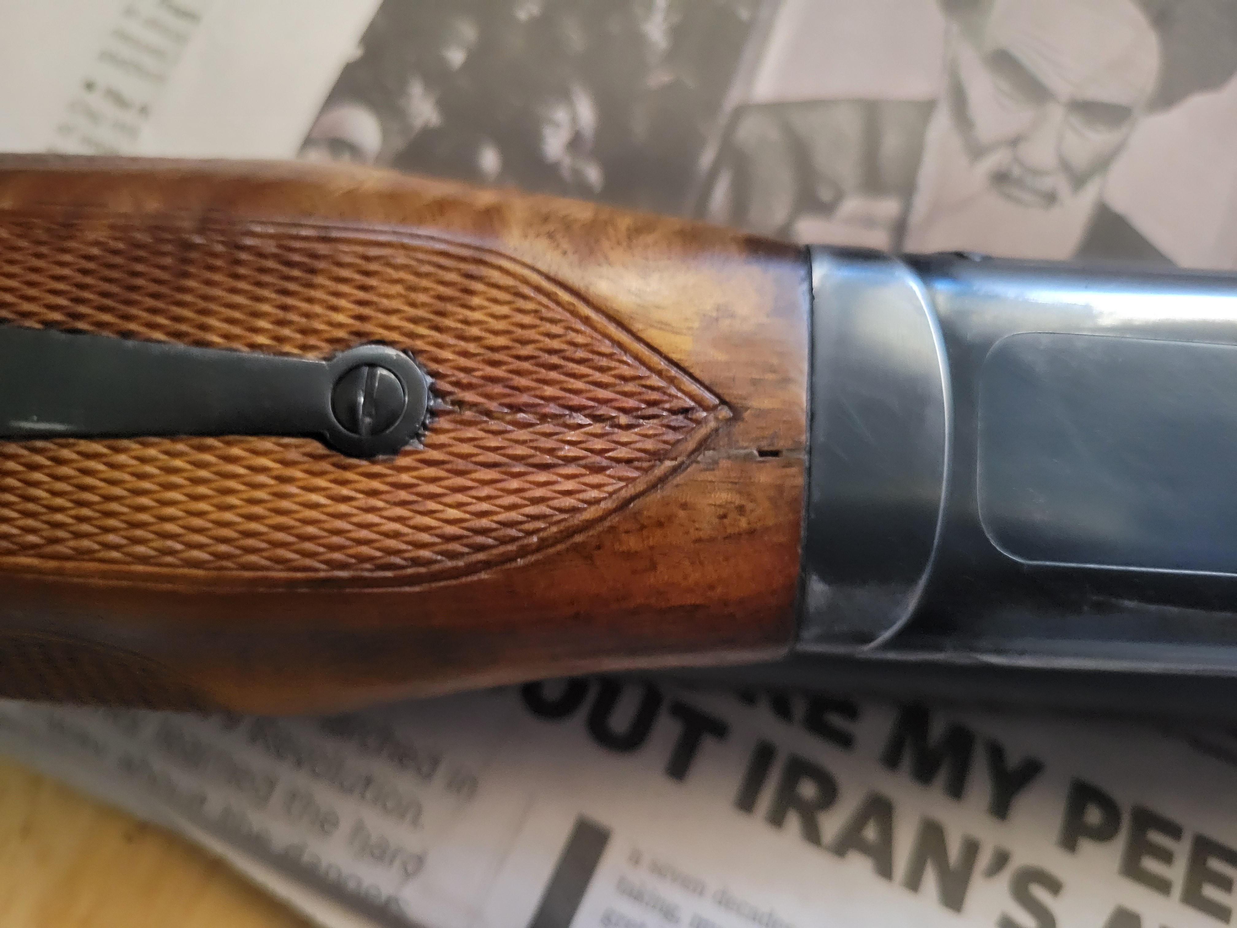

March 3, 2026 - 9:46 pm
Just got back with the gun. Ron did a careful and thorough job. He glass bedded the forearm iron in 3 layers of epoxy and added some at strategic places in the forearm inletting to ensure the forearm could not move under recoil.
The exterior is shown in the attached Pic. The crack line is still barely visible in the uncheckered area but fairly well hidden in the checkering.
After I recover from afternoon traffic– lots of lane closures for construction while the good weather lasts– I’ll take the gun down and photograph the forearm interior. 20260303_145953.jpg

Forum Posts: 6931
March 3, 2026 - 11:31 pm
Looks good to me.  He didn’t do more than necessary.  I’d suggest some walnut sawdust with glue, and stain if necessary, to fill that little hole.
Forum Posts: 2531
March 4, 2026 - 3:58 am
Yeah, that looks like shrinkage or an air bubble.  As small as it is,  I may just apply a coat of brown Butcher’s wax to the whole furniture and buff it off.
Ron told me he added some epoxy at the joint and around some other places to increase the wood to steel bearing surfaces. Whoever hollowed out the forearm stock was pretty enthusiastic. In gripping the forearm, it has a more solid feel than before.

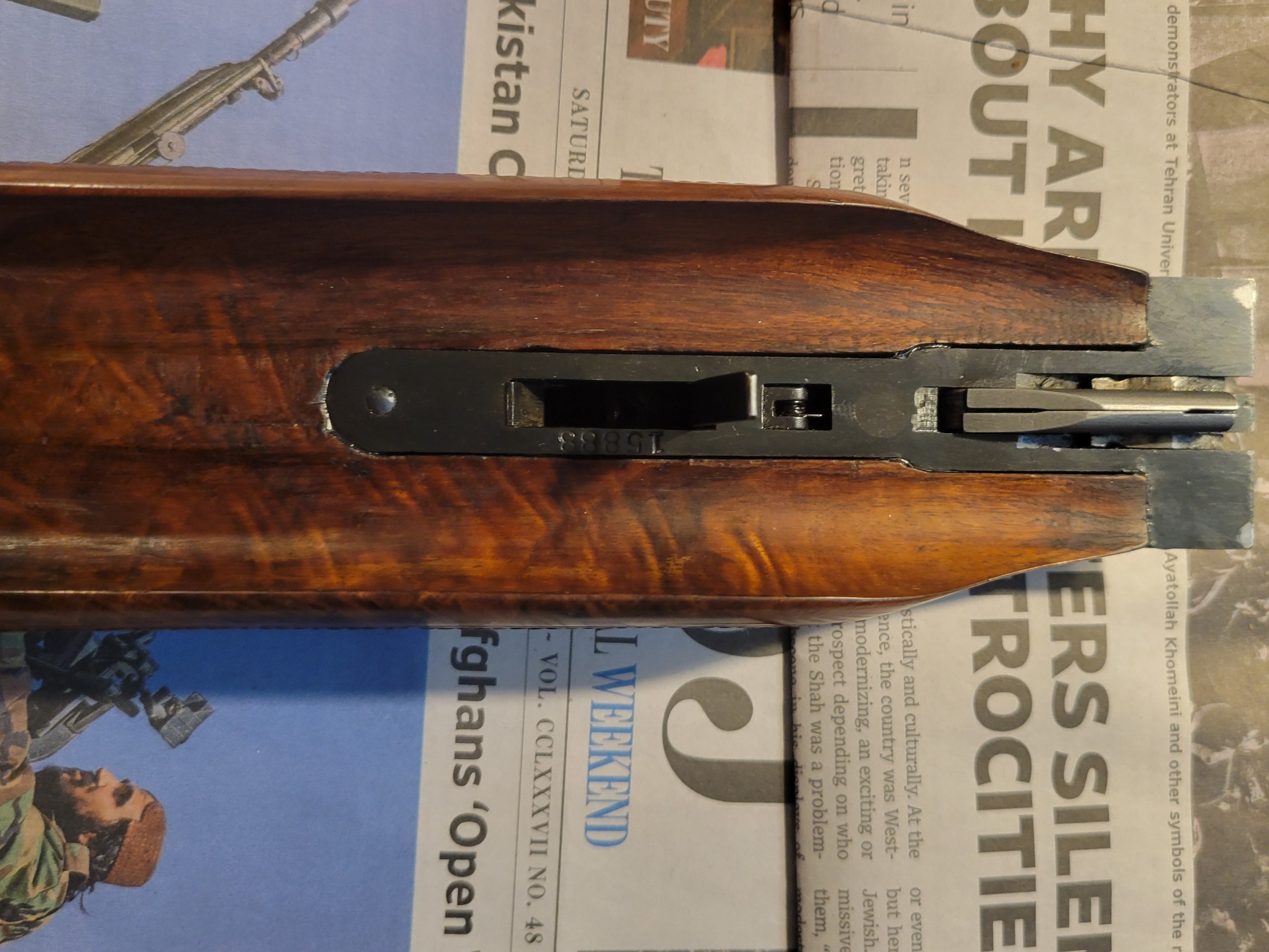

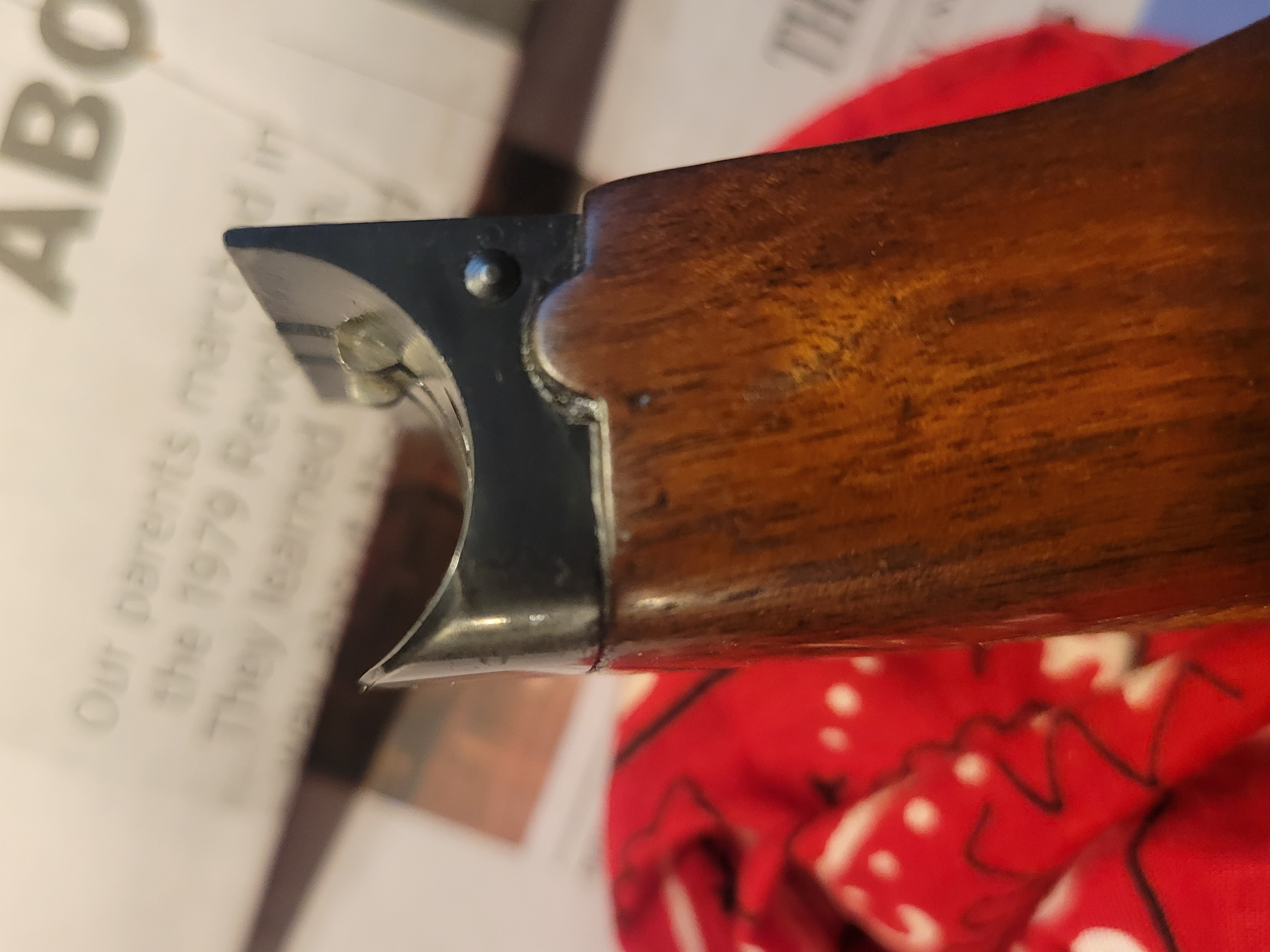

Forum Posts: 2531
March 4, 2026 - 6:56 pm
O.k. here’s the interior of the forearm and a side view of the end cap.
There’s not much to see unless I were to disassemble the forearm, which I have no burning desire to do. You can see traces of the glass bedding around the perimeter of the iron inletting. The side view of the end cap shows some epoxy in the junction of the steel and Walnut. The same is true on both sides.
The difference is one more easily felt than seen. Whereas, there were before hollow spaces below and around the iron, now there are none. It may be just my imagination but the whole assembly feels slightly heavier and, when mounted to the barrels, stiffer. 20260304_120845.jpg20260304_120740.jpg20260304_120649.jpg
