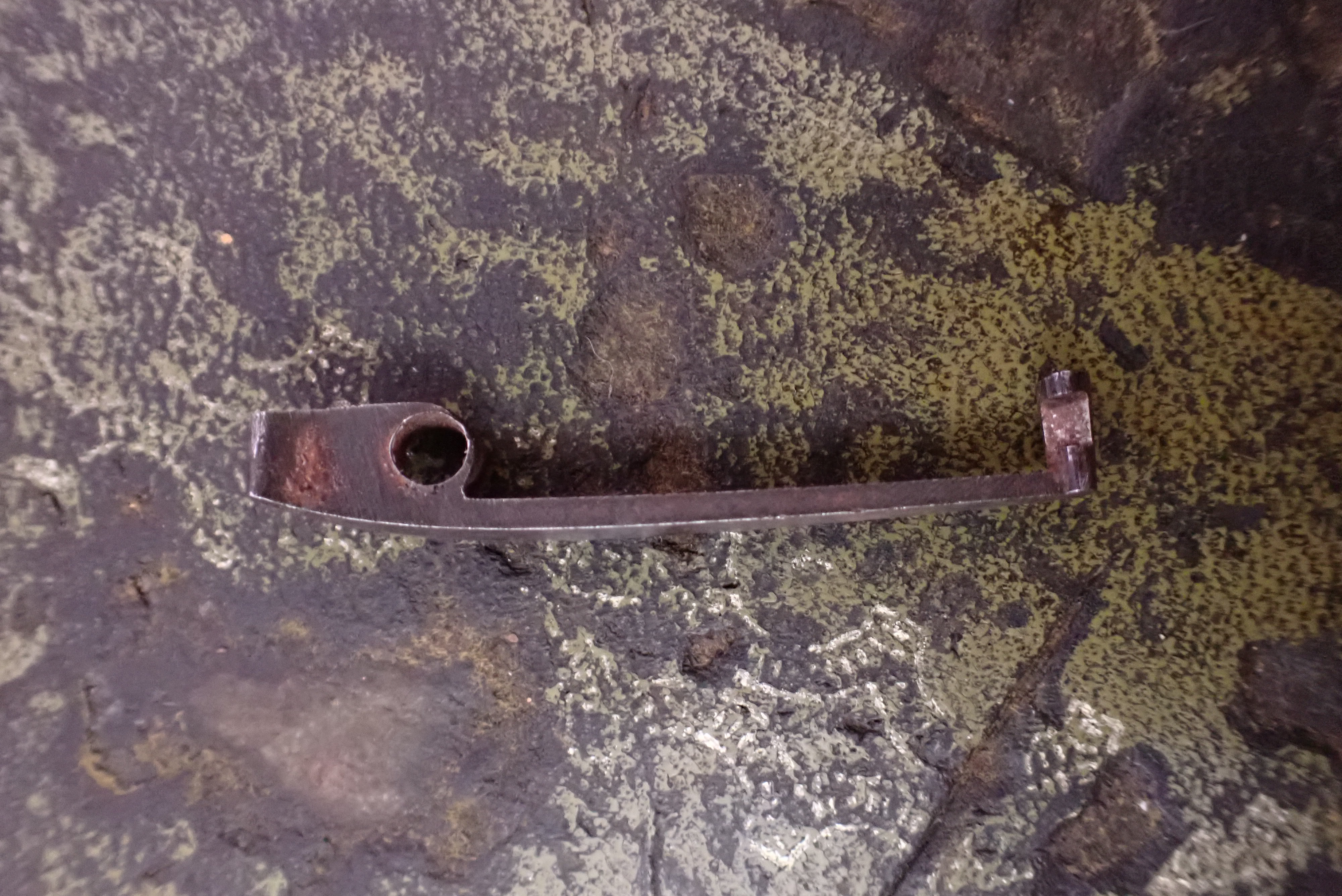

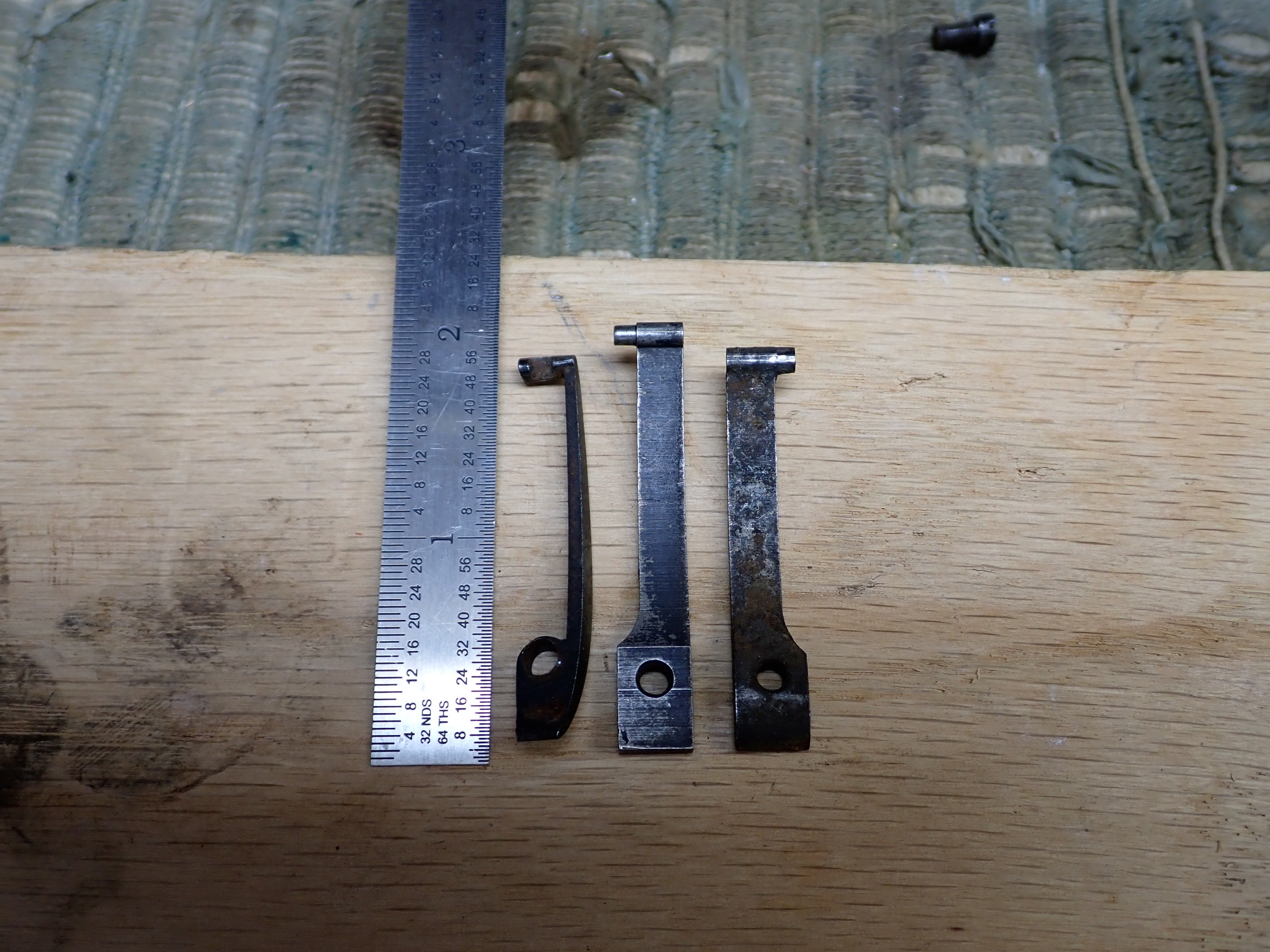

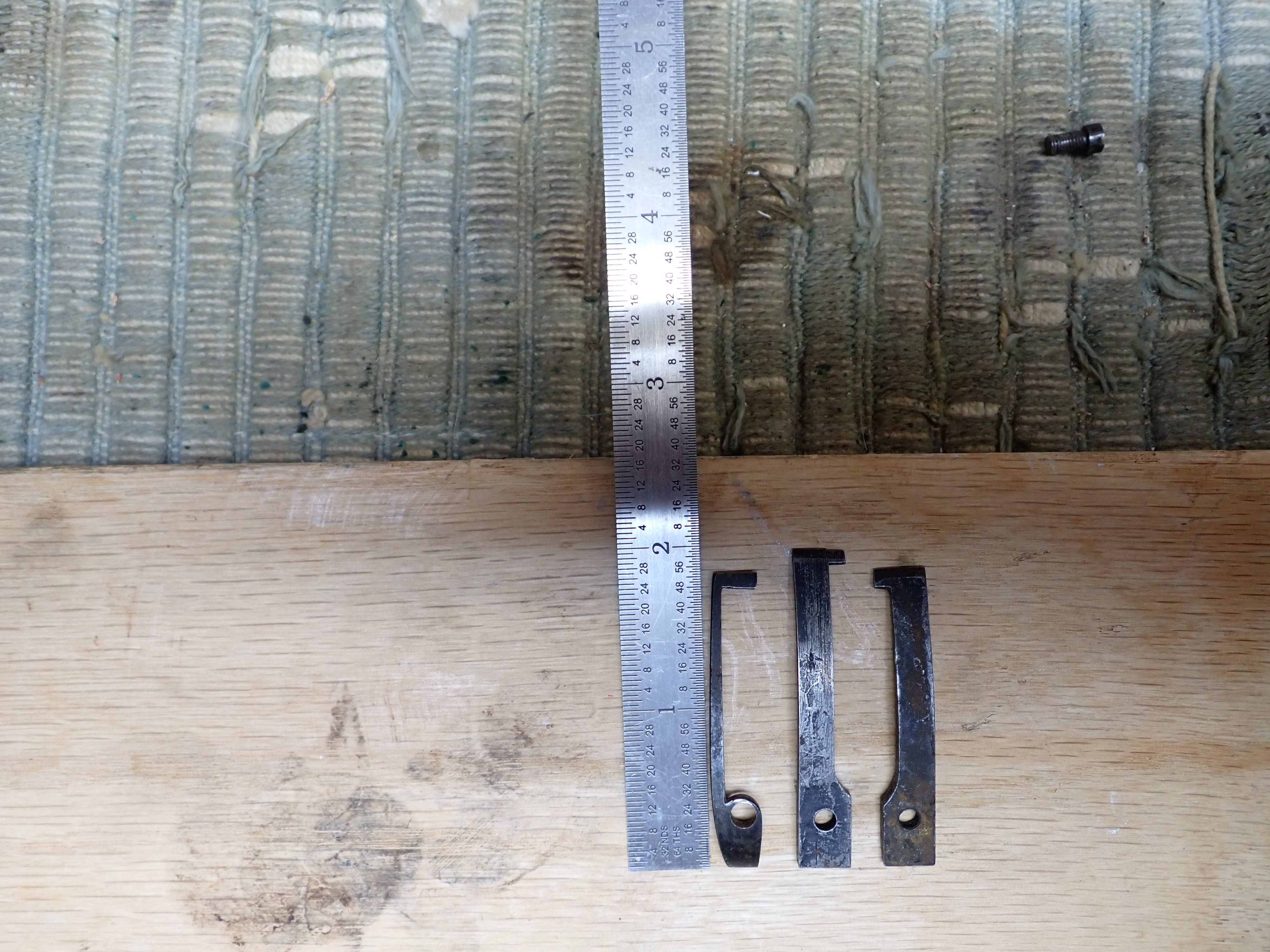

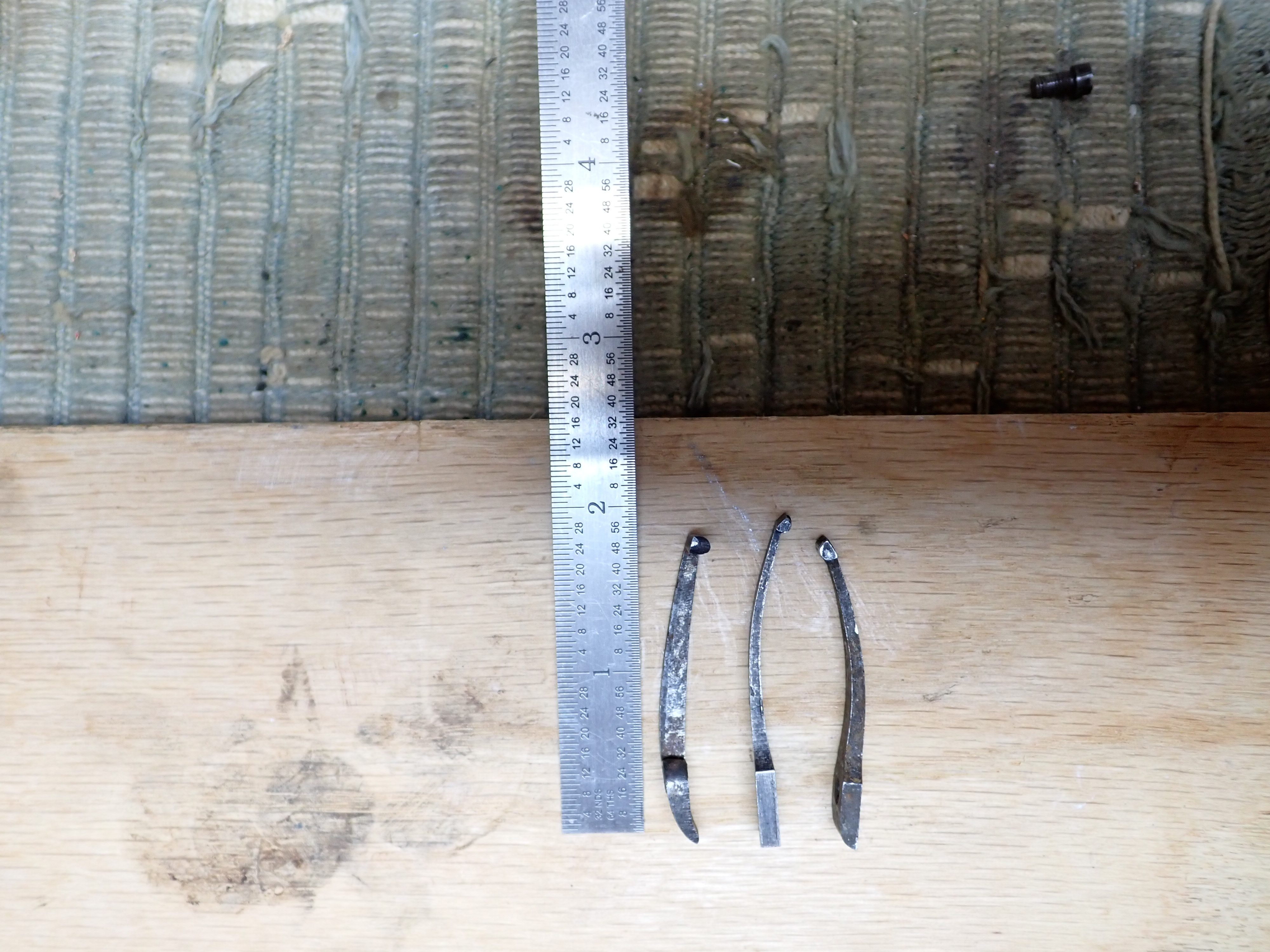

Trying to figure out what the left lever spring on the far left may have gone to.  The R & L lever spring for an 1873 are shown to the right for comparison.

Forum Posts: 5011
April 18, 2025 - 1:55 pm
Chris,
The one on the left is curved the wrong way to work on a 66, 73 or 76. It looks like it would be pushing up not down if installed in one of those if you figure the end with the hole would fit to the radius of the frame.
Forum Posts: 1183
April 18, 2025 - 3:04 pm
Bob,
Thats what I thought too, but whats confusing is the notch on what I would presume is the bottom side is where it would bear against something.  This came with a number of 73 springs and other parts I bought years ago but could never could figure out what it went to.  Its seems like it doesnt have a lot of meat around the screw hole like on a 73 spring.  Based on the length, I’d assumed it was for something with similar size cartridge range as the 66 or 73.  The way it is designed is pretty stiff, not like a typical flat spring.
