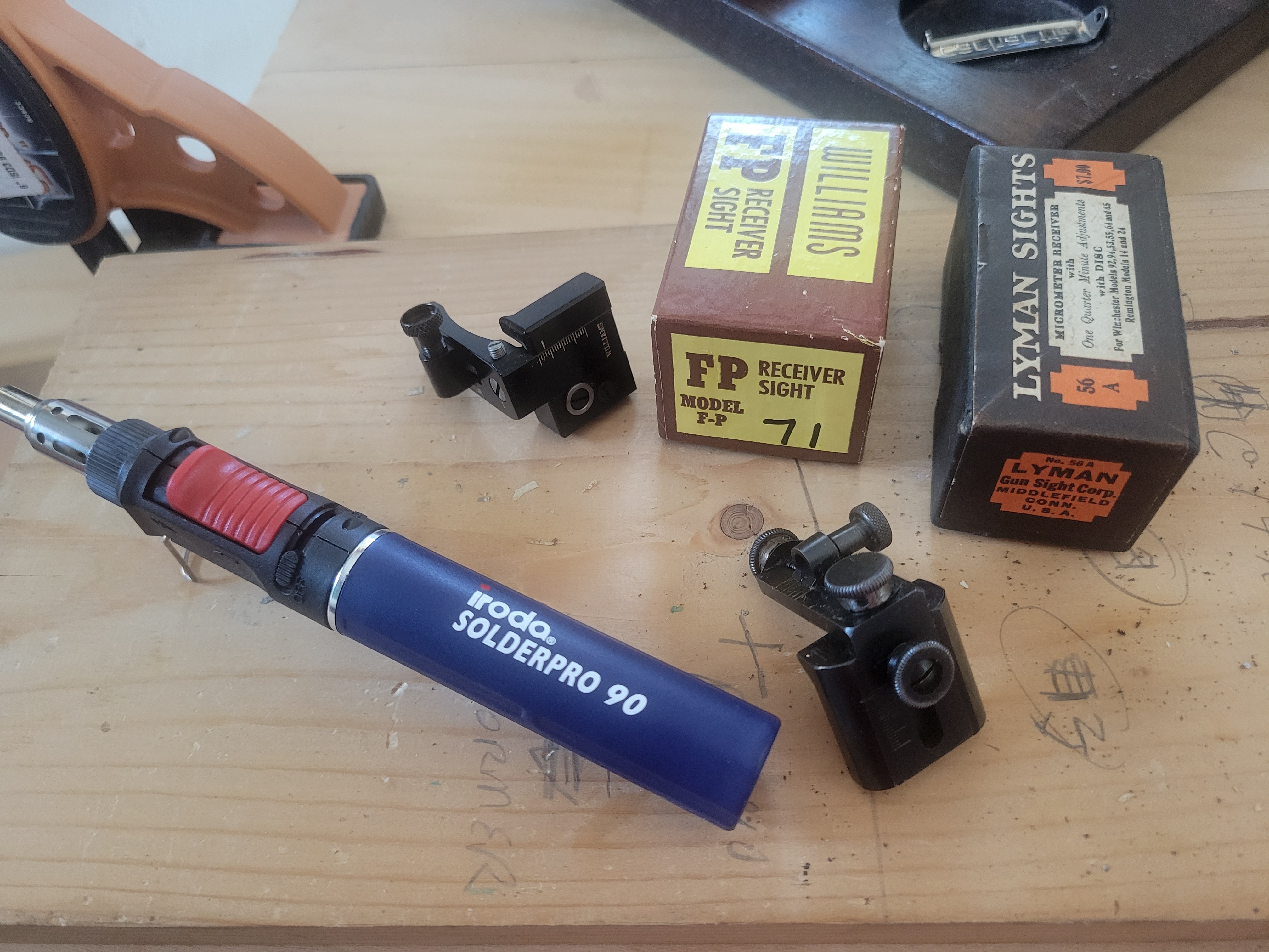

I’ve had in my parts kit a Williams FP-71 that I’d installed on a once owned Browning Model 71, sometime in the Nineties.  As I’ve mentioned, my 2010 Winchester 1895 .405 shoots so high, out of the factory box, that the stock iron rear sight can’t get low enough to compensate for what appears to be a too-low factory front sight.  Go figure, although the open rear is probably going to be replaced with a blank anyway.  I’d be leary of a tang sight even if I wanted to go to the expense and trouble of removing the little sliding tang safety button,  which I don’t. My personal favorites are micrometer aperture receiver sights, specifically the Redfield 70-H, or the Lyman 48-H for bolt actions, but trying to find a Lyman 56W for a Japanese 1895 seems like over-egging the pudding. It is a rice-powered Winchester and still would be, so being period obsessive would just be silly.  In that light, the FP-71 looks like a nice solution.
But the Williams has been in its box a very long time and the controls are unacceptably tight, likely meaning there’s a thin layer of dusty gunk in the threads, probably dried preservative too. While I’ve got big electric Wellers and even bigger heat guns for rough work, I wanted something delicate and small that would heat the heads of small screws and parts. The only circuit board iron I had has been AWOL for decades.
I ran across this little jewel, sold on Amazon and elsewhere: an iRoda SolderPro 90K, for about 43 bucks, cordless, lightweight, runs off butane, and comes in a kit with several tips and some lead-free solder.  The best thing about it is you don’t have to clamp up what you’re working on, struggle with a trailing power cord, or worry about getting intense heat on adjacent surfaces. You can literally put up to 1300F on a pin point, which will very quickly melt away cured LocTite from threads or, in my case, give enough differential expansion/contraction to free up the assembly. What’s especially nice is you can control the tip temperature by dialing the fuel flow up or down with a small wheel on the tool.
Everybody but me may have had one on their bench for a while but, if you don’t, I think it’s going to be very helpful and it is also very quick to set up. 20250318_172703.jpg

I’ve worn a couple of those butane soldiering irons out in my life time. They generally stop lighting, They still spark but I think the piezioelectric sparker gets weak. I do electronic work at times and have a good Weller soldiering and desoldiering station on my bench. I use freeze spray for checking temperature sensitive components which will also help with screws. Heating the base metal and then cool the screw and use some thermo contraction to give you a assist.

Thanks for the tip.  I don’t think this butane iron is going to be long-lived and it will go into my “used seldom but when you need it, you really need it” gunsmithing box.
