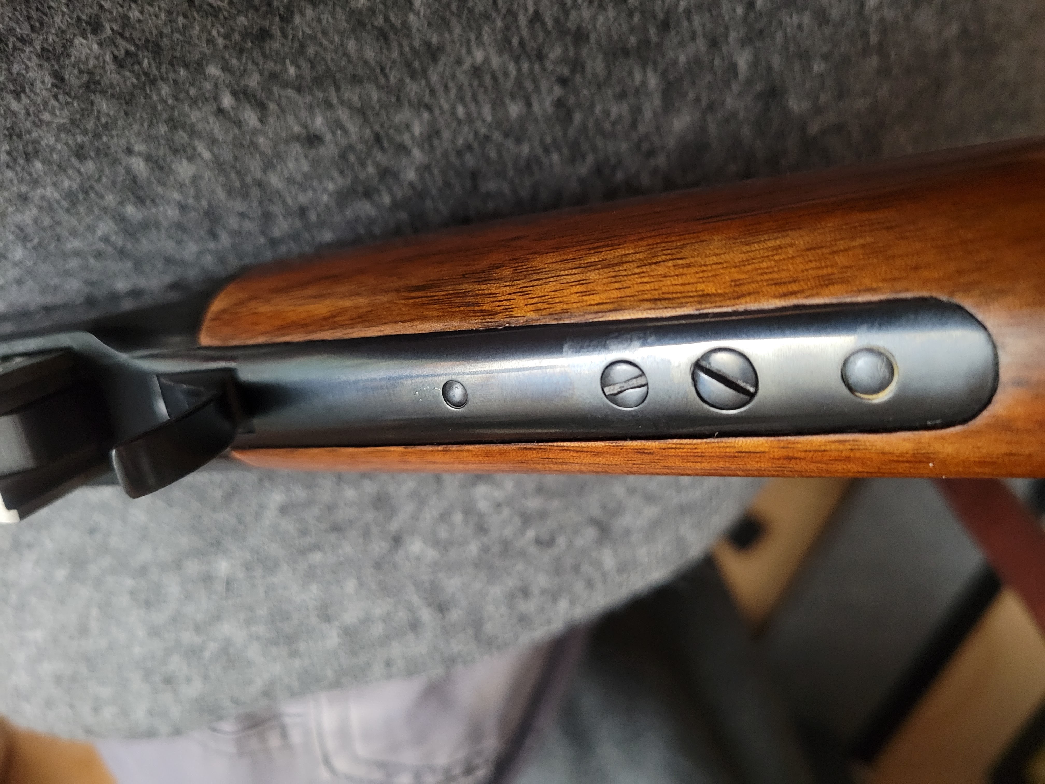

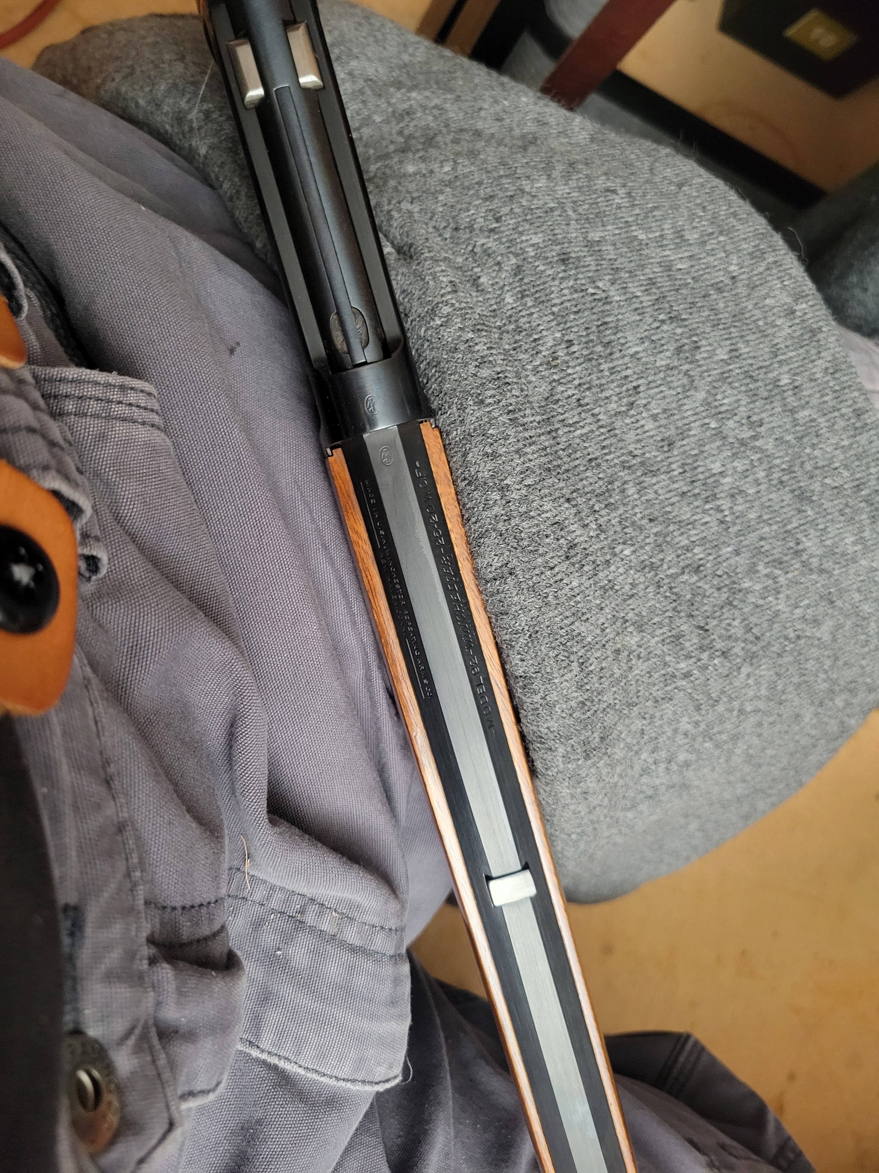

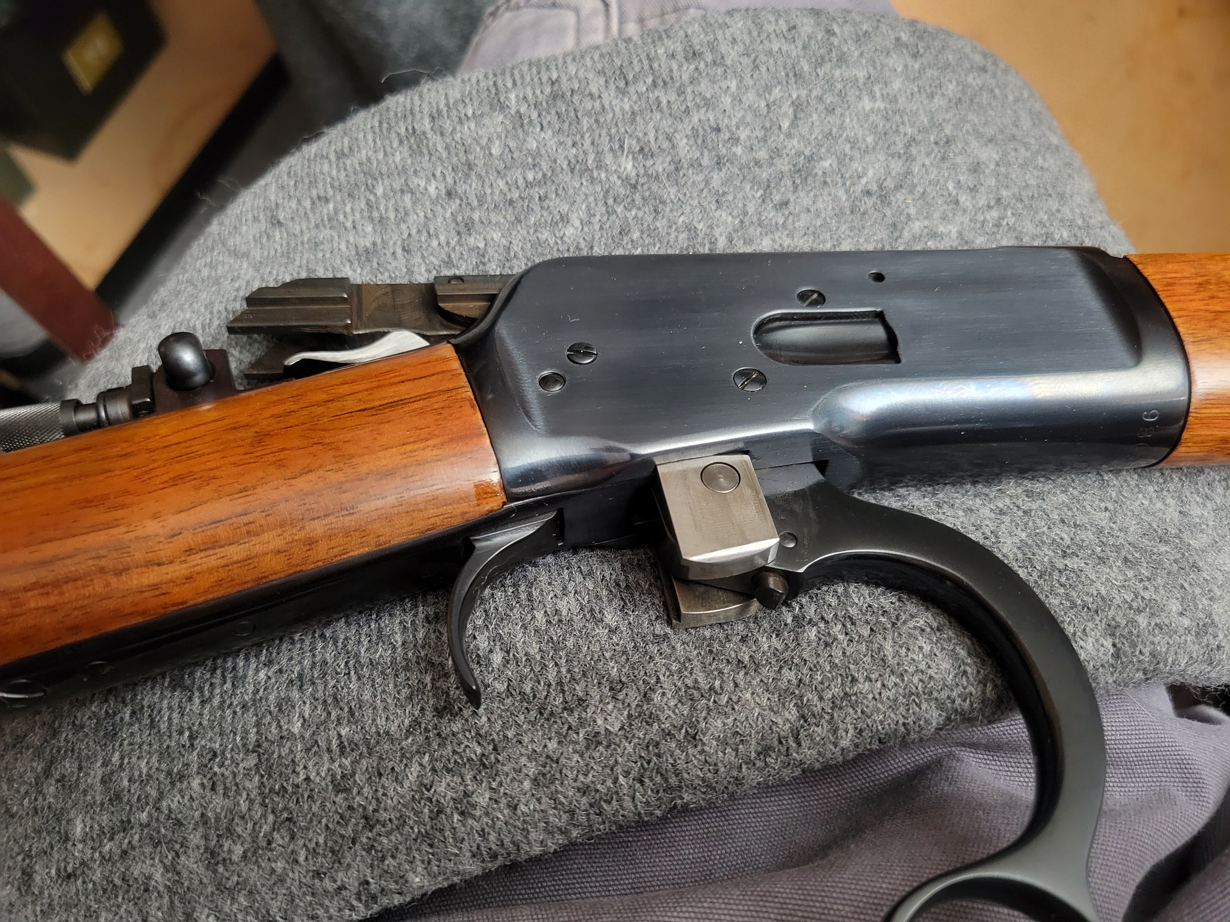

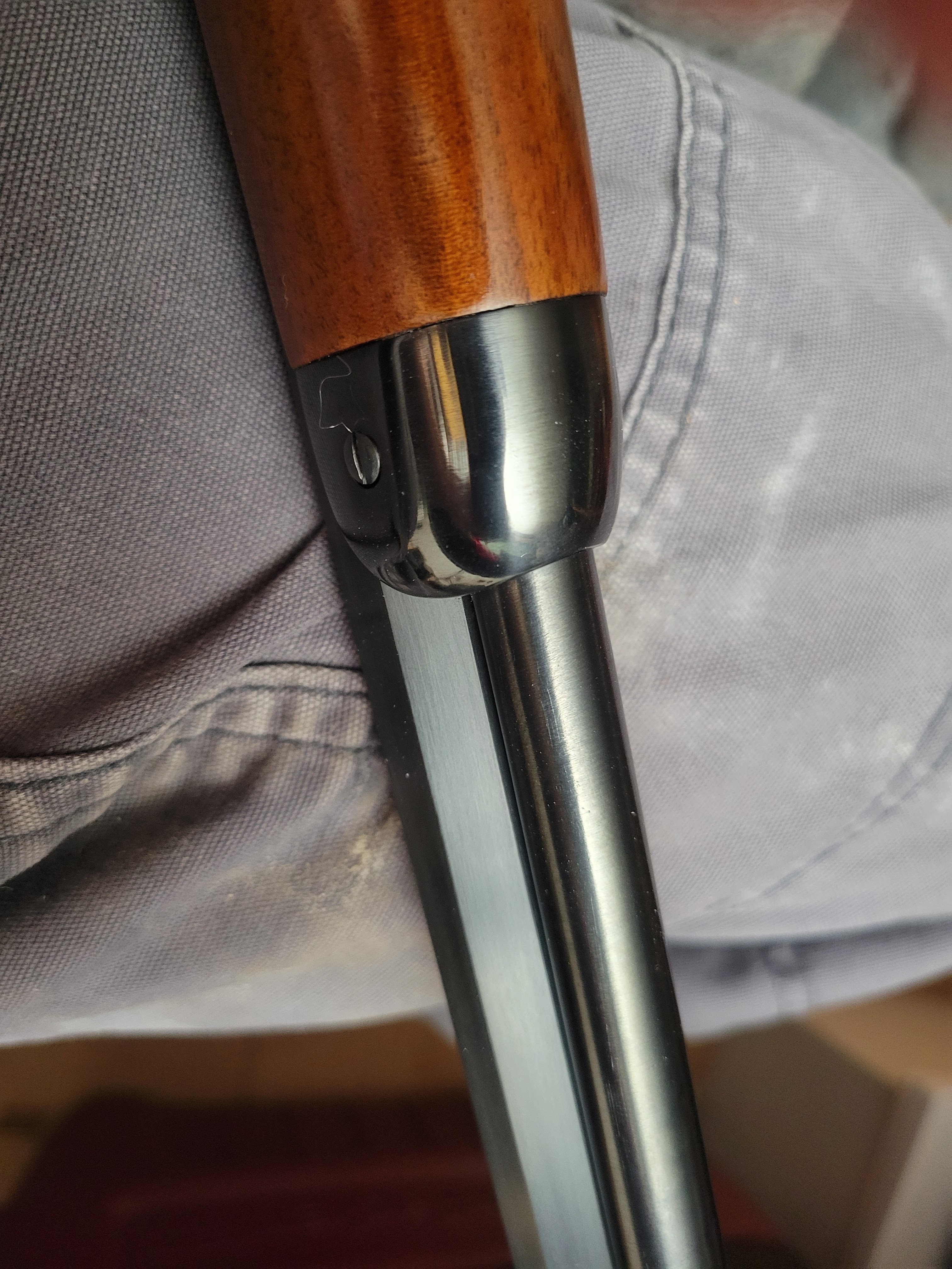

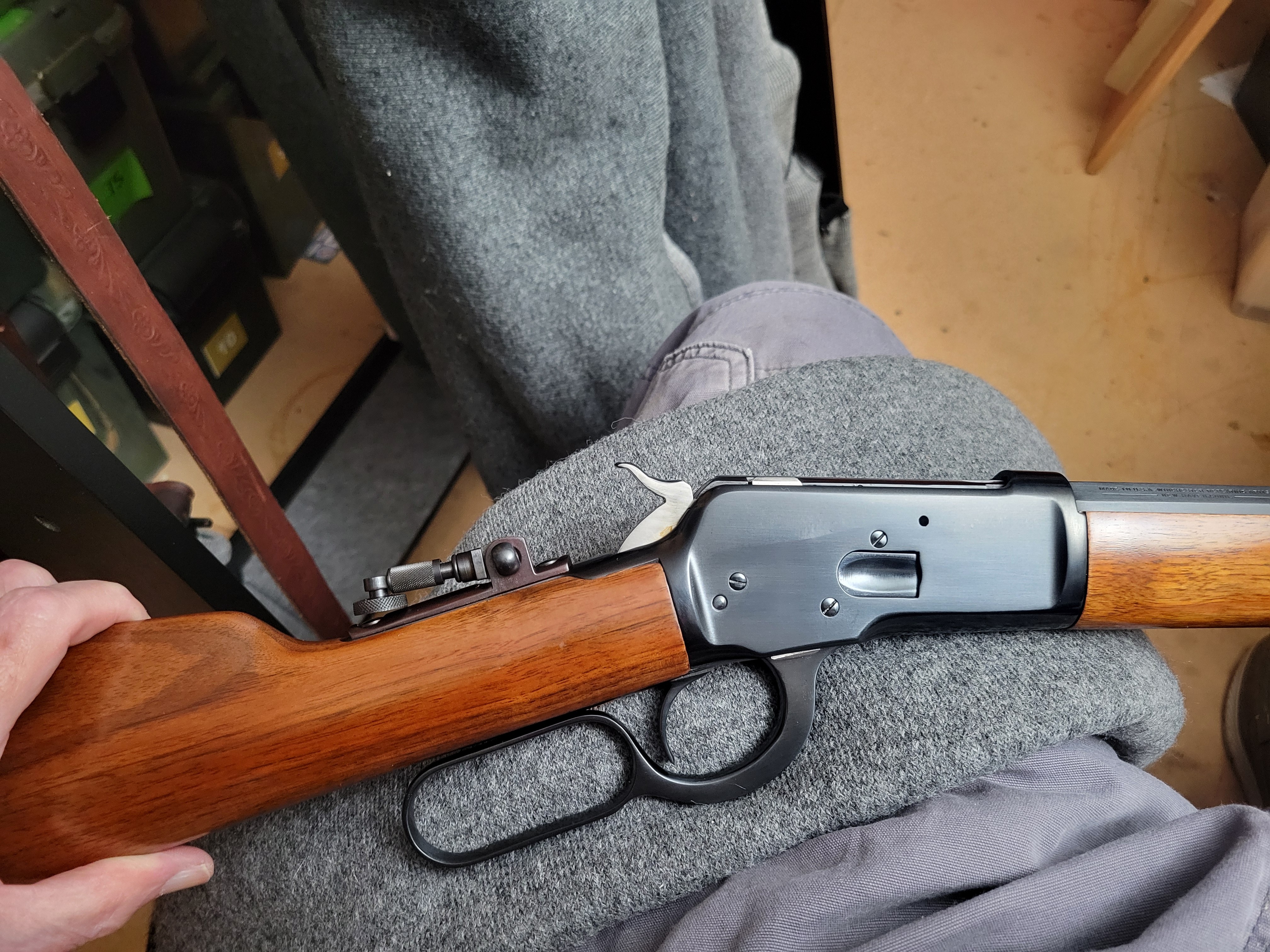

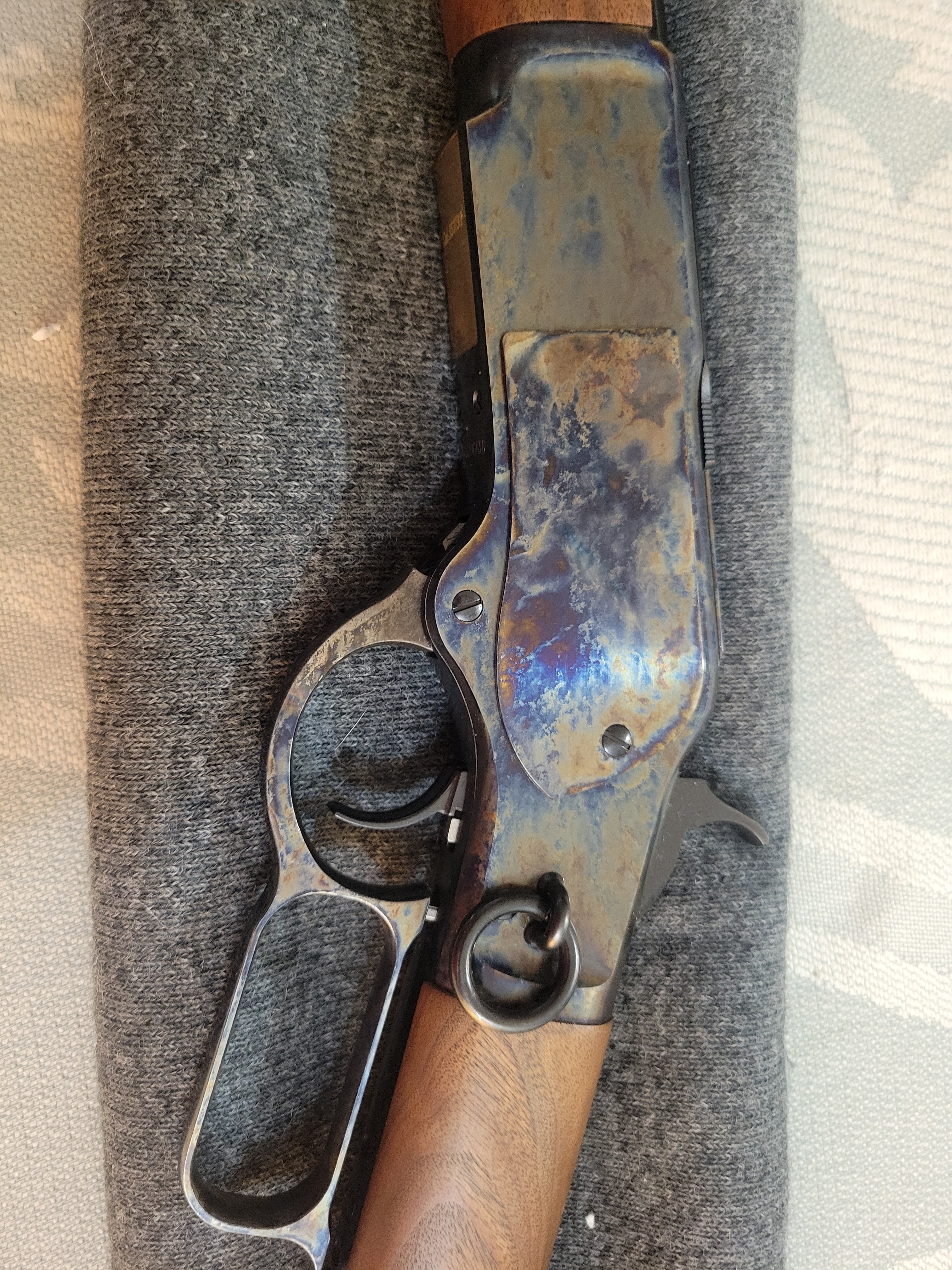

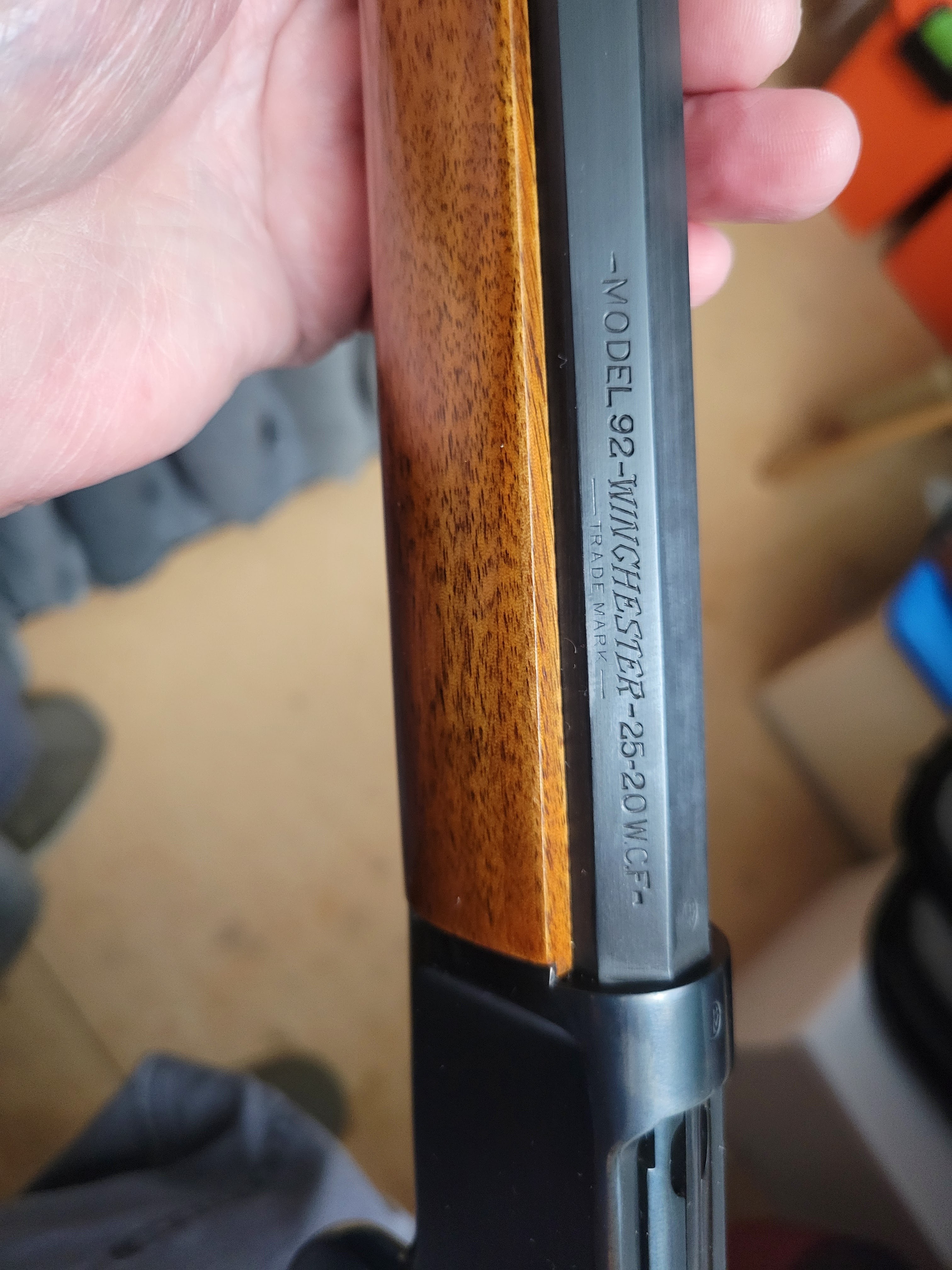

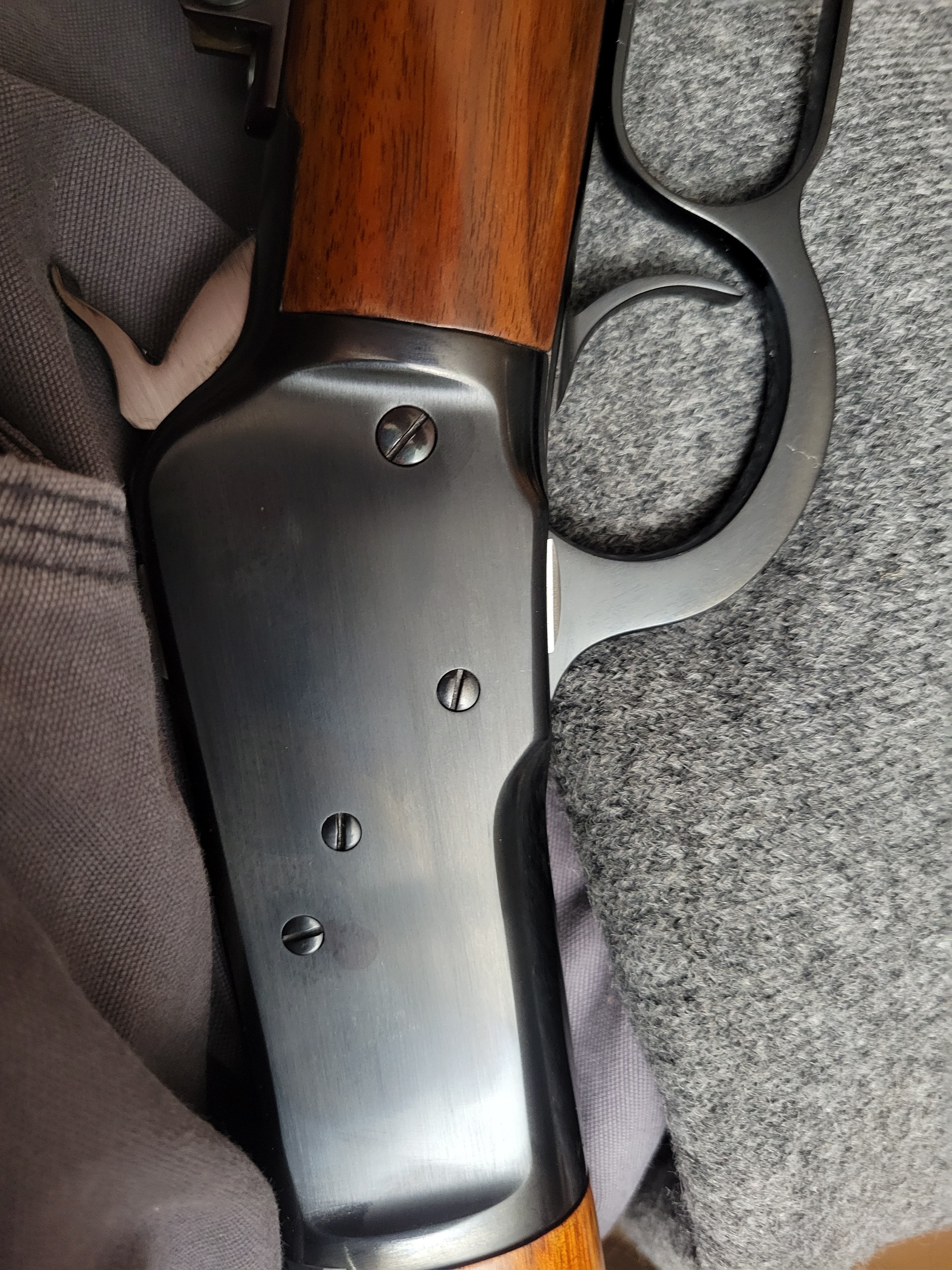

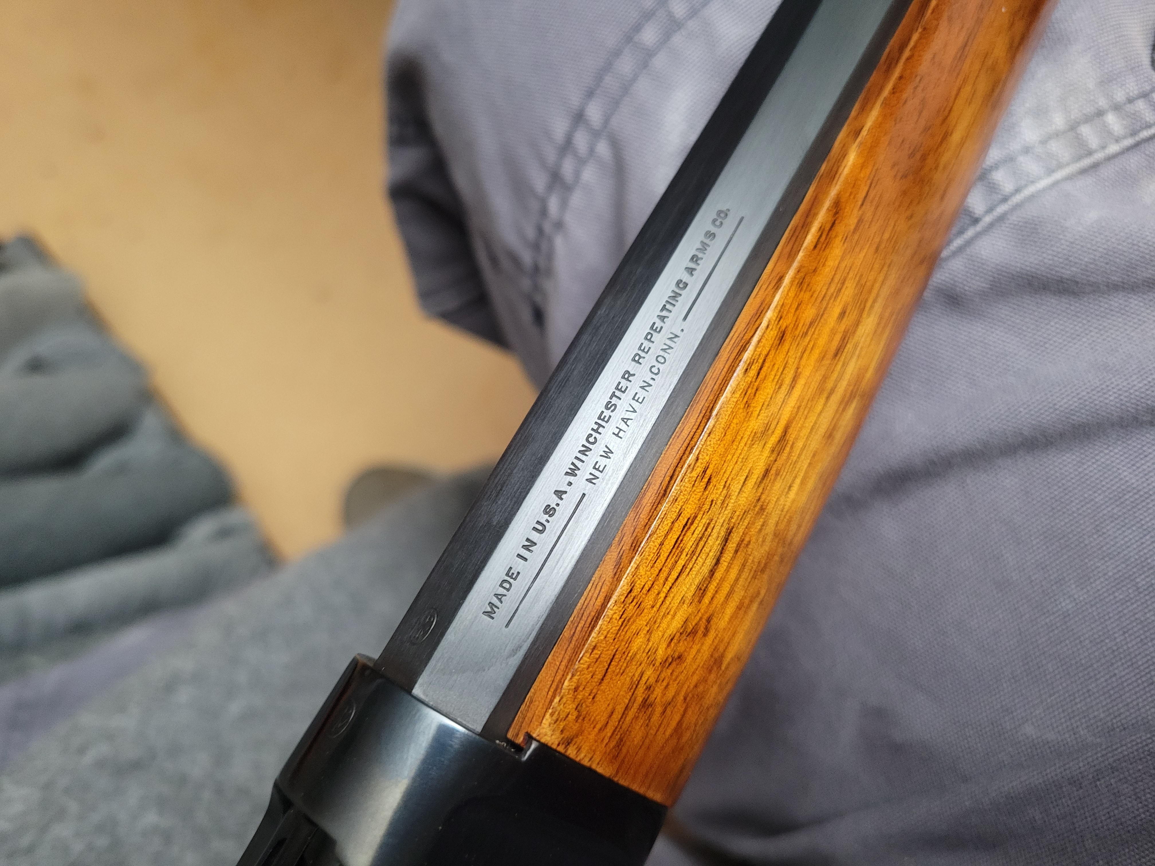

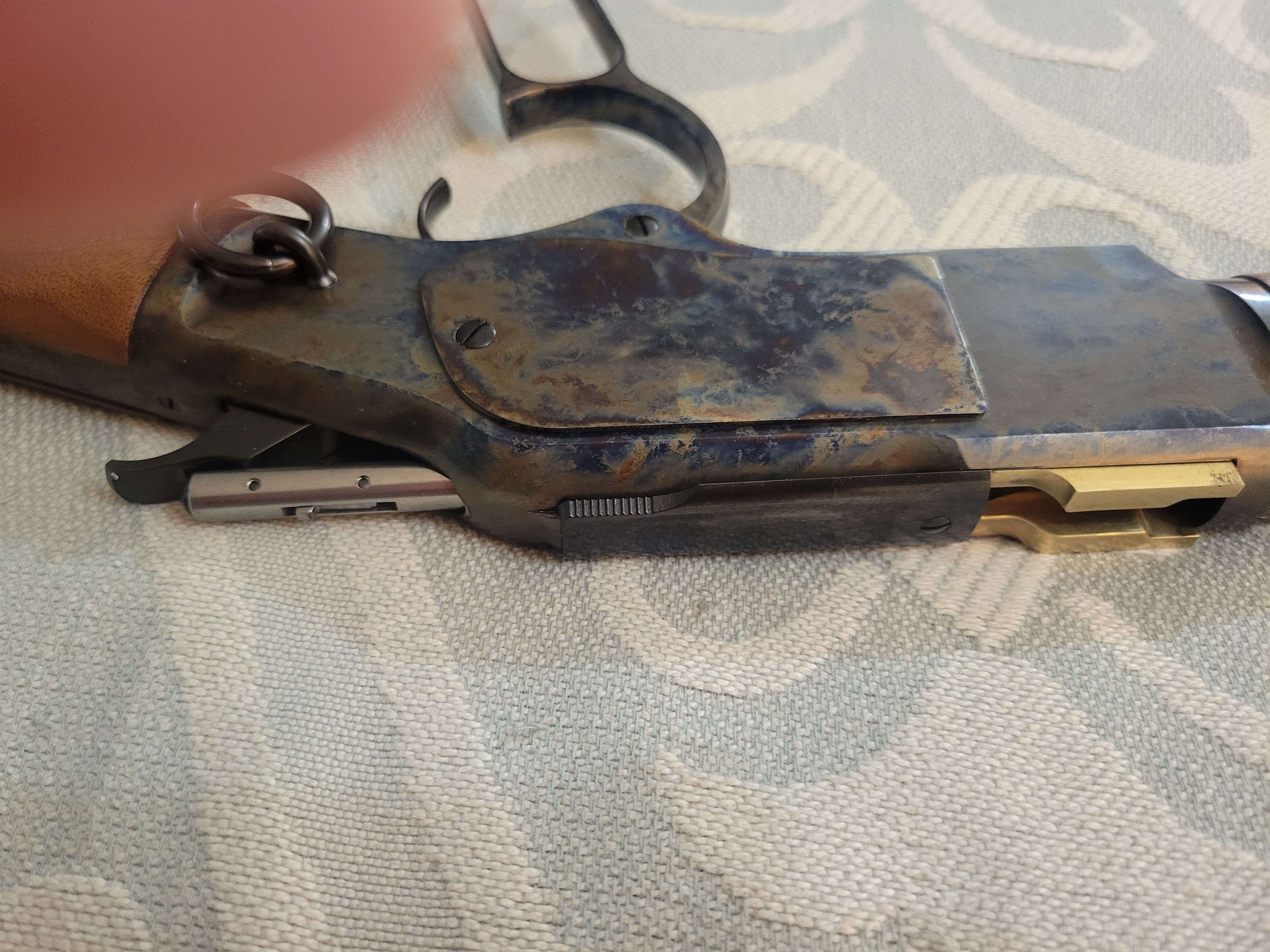

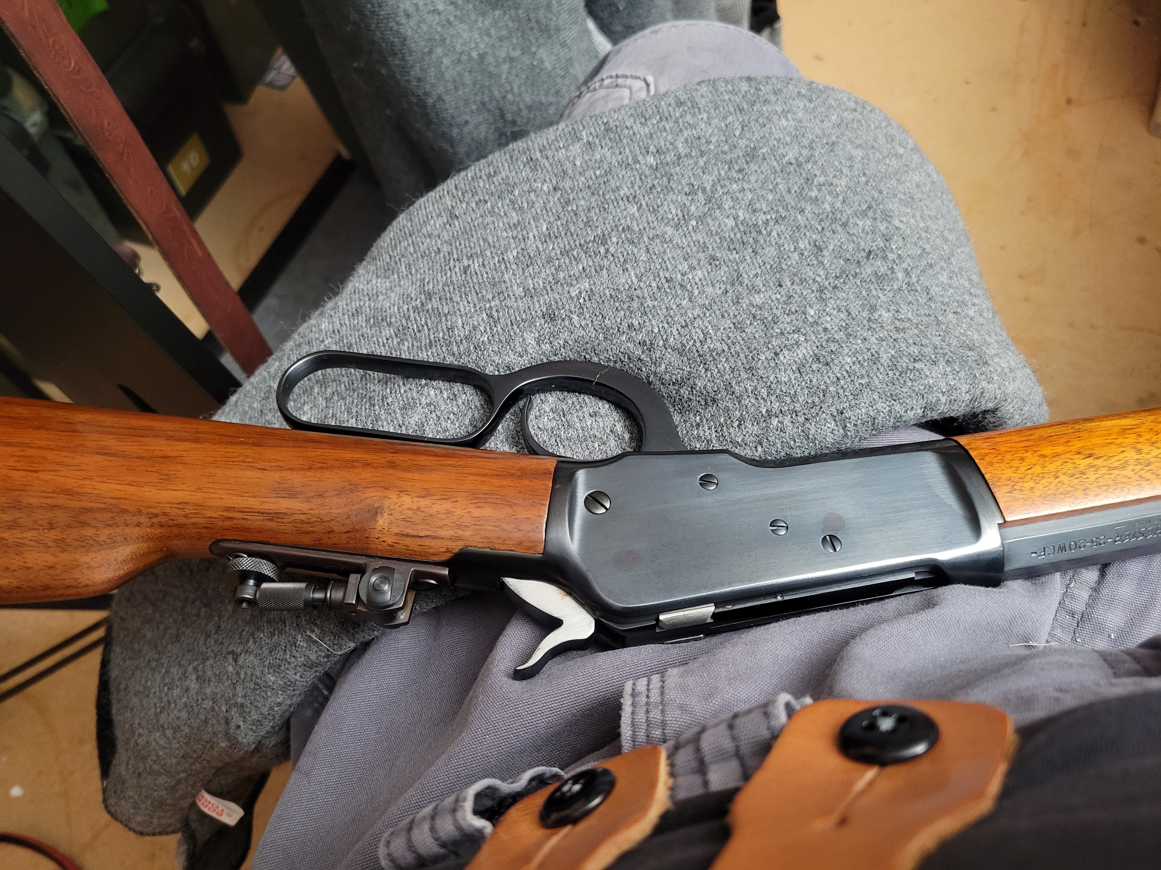

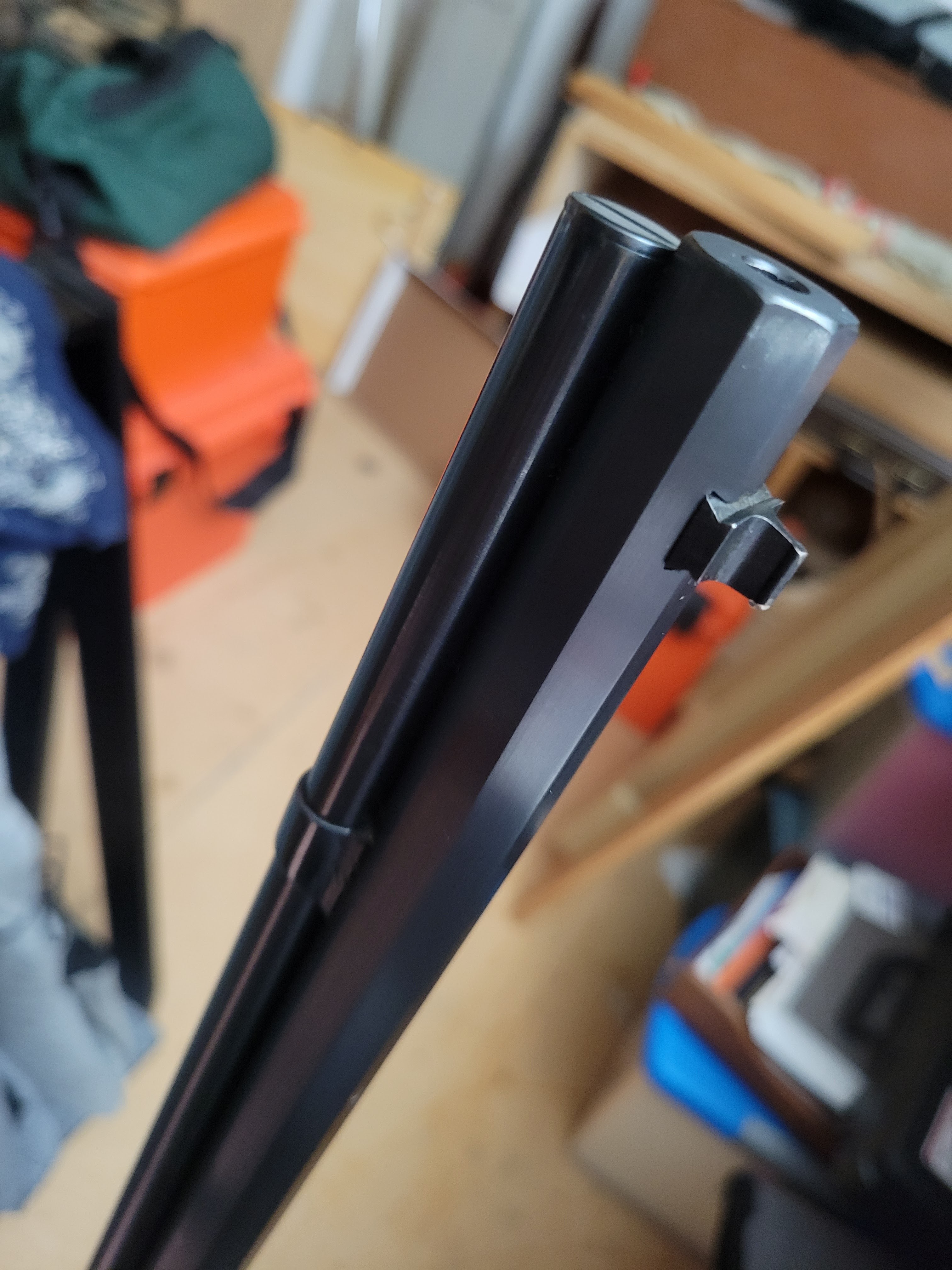

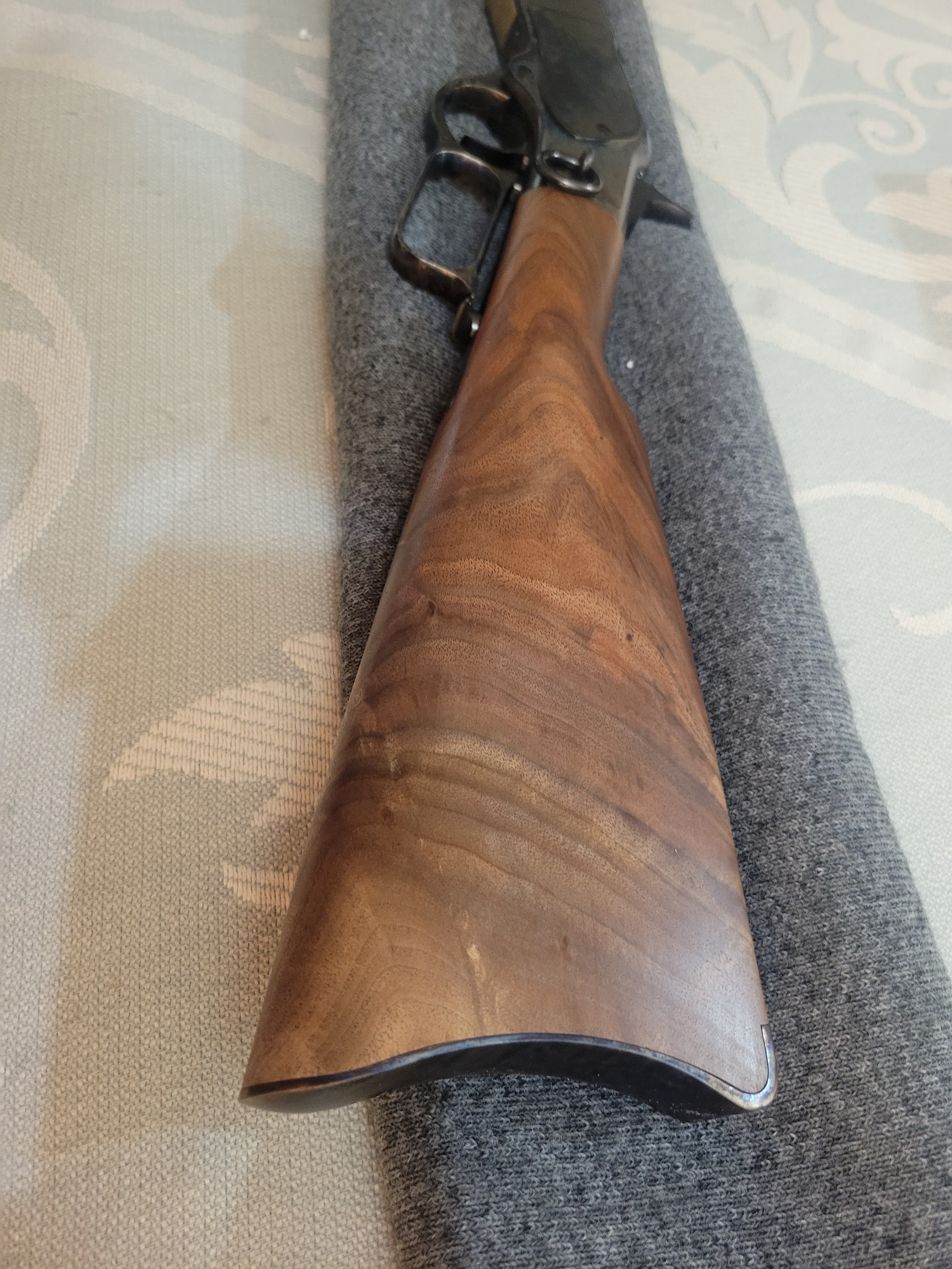

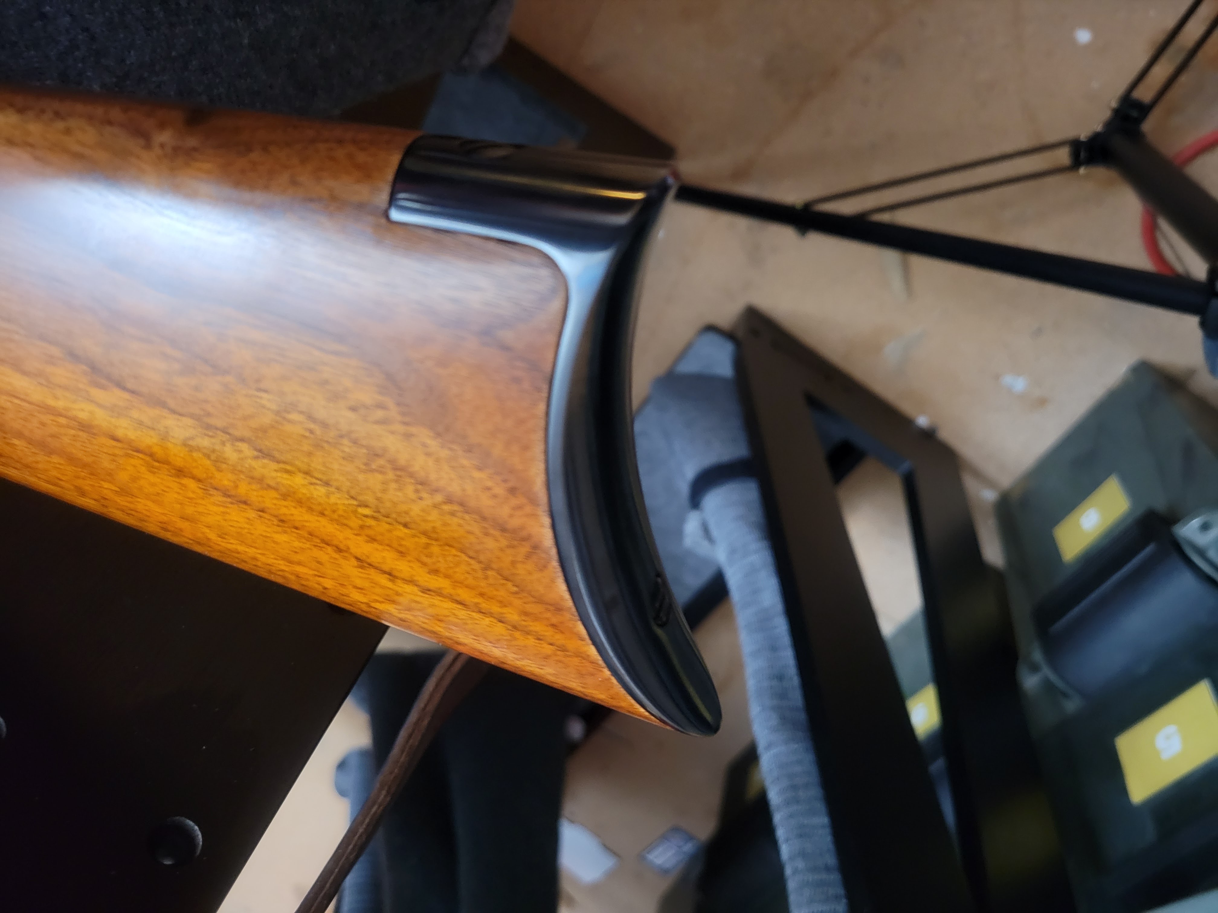

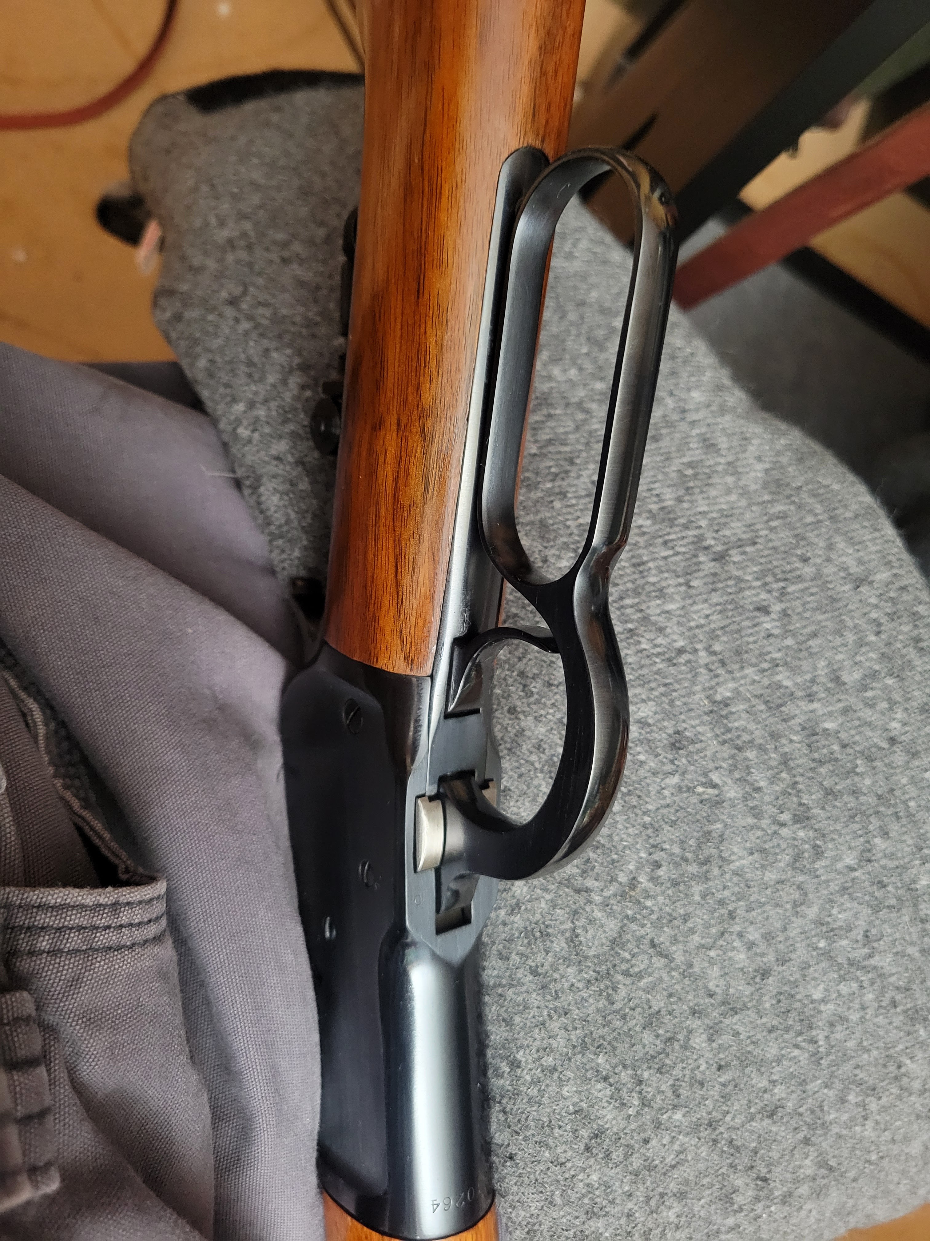

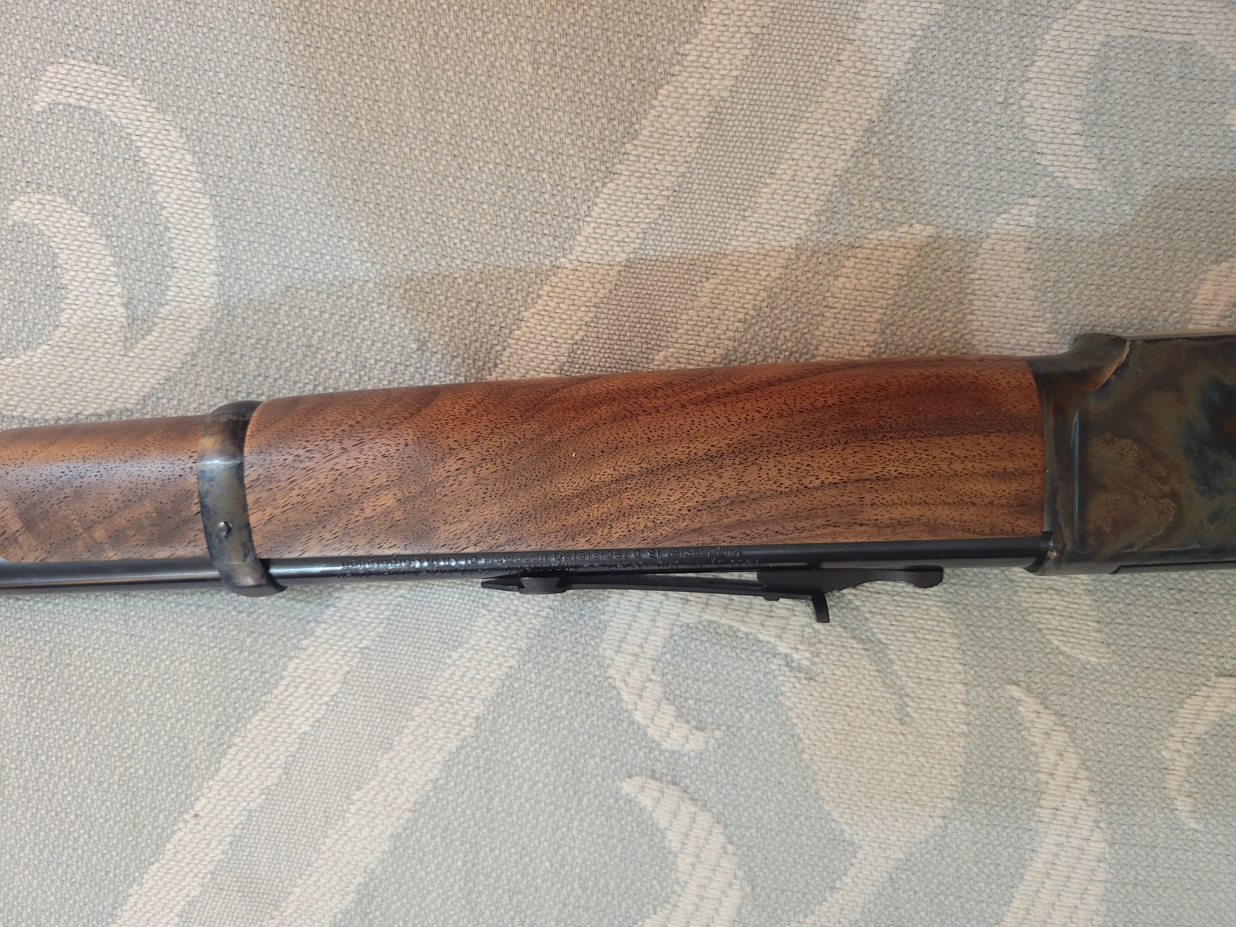

This is a rifle I’ve talked about several times in the last couple of years but never properly photographed. I had it out this evening and decided to show what I think is a restoration on which most could agree.
This was not an attempt to make the rifle historically correct — as you can see, the buttplate, lever, and nose cap are not case colored, the tang sight is Lyman’s then (circa 1999)  current reproduction, and the front sight is a modern Marble’s.
The reason I bothered to have this work done was (1) the gun had been badly abused by more than one owner, although the bore was pristine and the gun perfectly functional; (2) I bought it for $399 USD; (3) first trial at the range it shot 50 yard cloverleaves with 86 grain Remington factory ammunition.
As bought, the steel had been over-buffed and rounded, although bozo did leave the rollmarks and serial alone. Screw heads were flattened. Garish blue job.  Left receiver wall had been drilled and tapped for a side scope mount. The wood had been hopelessly sanded down.
I turned it over to Scott May, the talented gunsmith and custom stockmaker who has since gone on to manage Beretta’s custom shop in Dallas. Scott ordered new Walnut and screws, stoned the steel back to contours, welded up the extra holes – had a hell of a time find welding rod that wouldn’t be a sore thumb — rust blued the barrel and the receiver, fitted and finished the furniture in oil.
This was more than 25 years ago. The tab was $700. So $1,100 all in, in 2000 Dollars. Could I have bought an original small bore 1992 with a pristine barrel for that money back then? I don’t know. I don’t think so because Cowboy Action competition was hot. But I had no intention to spend $700 more until I saw how accurate the little rifle was.
In any event, the gun was so far from any sort of original condition, it needed to be either parted out or given back some portion of its dignity.

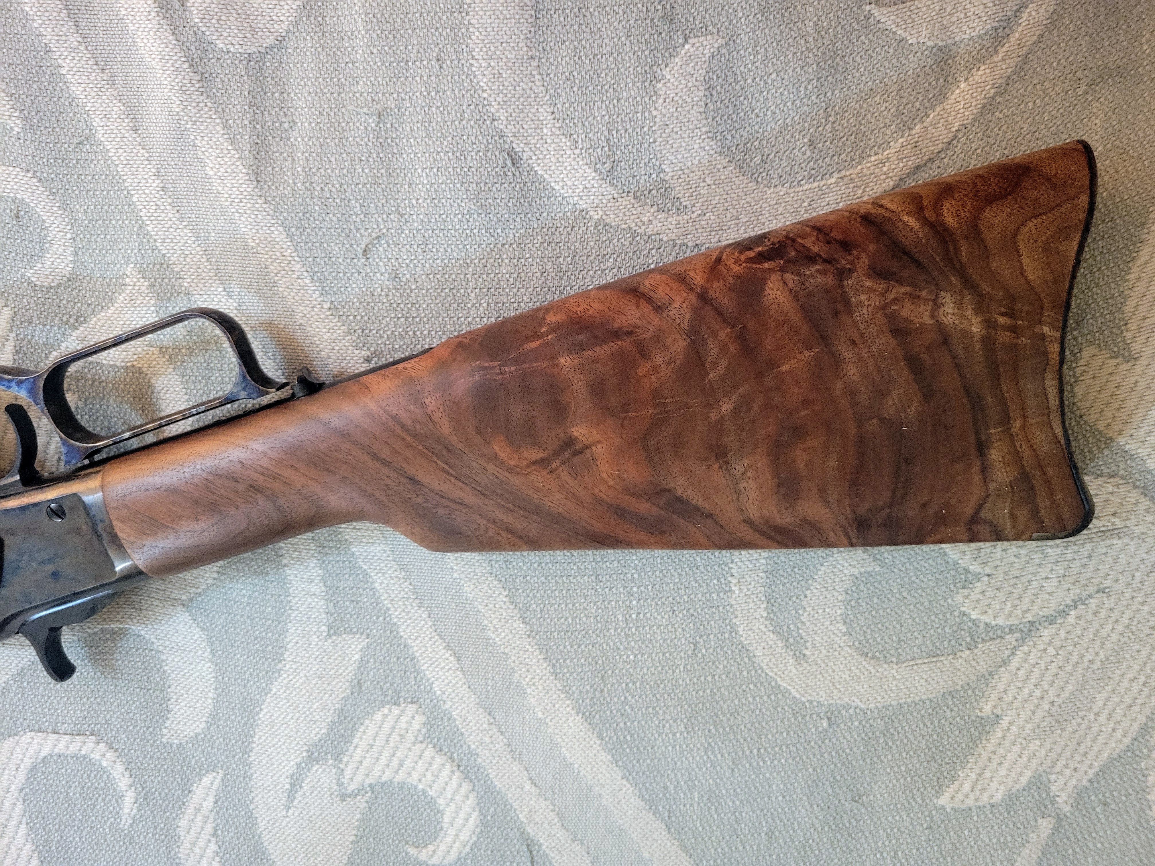

The thing that is a jarring note about the Walnut is it is flatsawn sapwood and at least one cathedral of grain shows. Of course, Winchester never wasted anything but my impression is their 19th Century wood was riftsawn heartwood, when they could get it. [CHUCK, if you see this, please comment.]
Of course, this gun’s d.o.m. [per Bert] was 1929 when the kitchen sink was likely being used for material, so maybe a sapwood stock is semi-authentic?

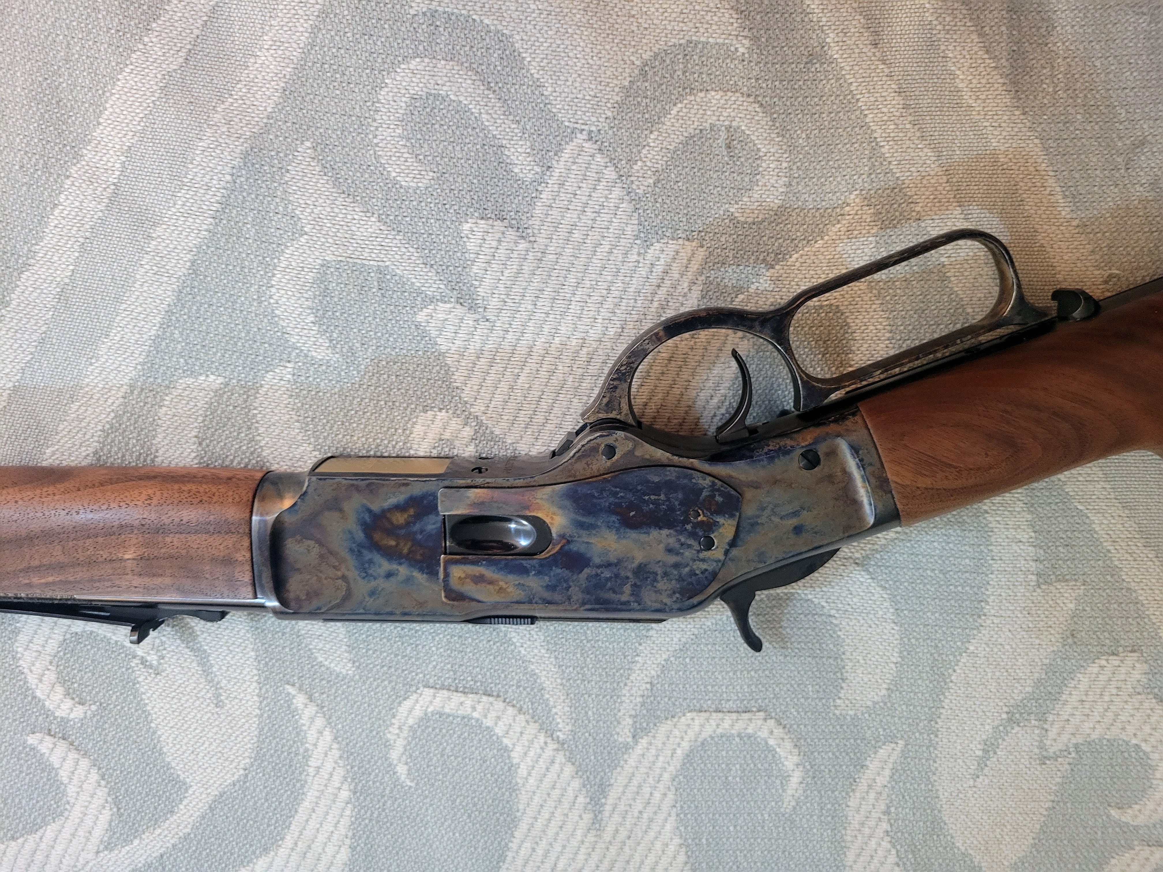

Well, the current production 1873 is not cheap but it is the most bone stock original of the line. No rebounding hammer and no tang safety. Don’t ask me why. Manufacturing quality, fit and finish is top shelf. Here’s the 357 carbine. 20240508_101316.jpg20240508_101321.jpg20240508_101312.jpg20240508_101512.jpg20240508_101517.jpg20240508_101342.jpg20240508_101231.jpg
