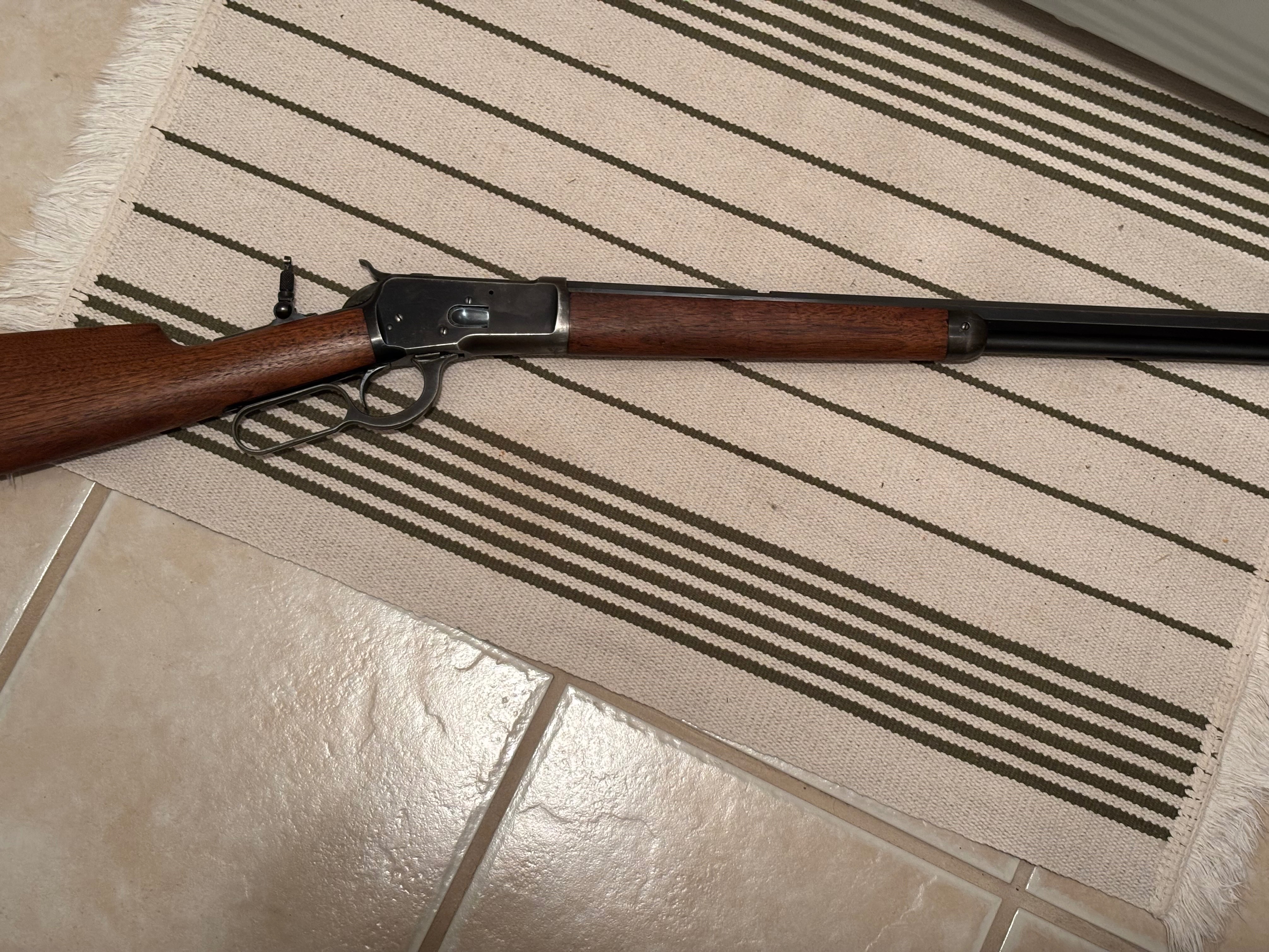

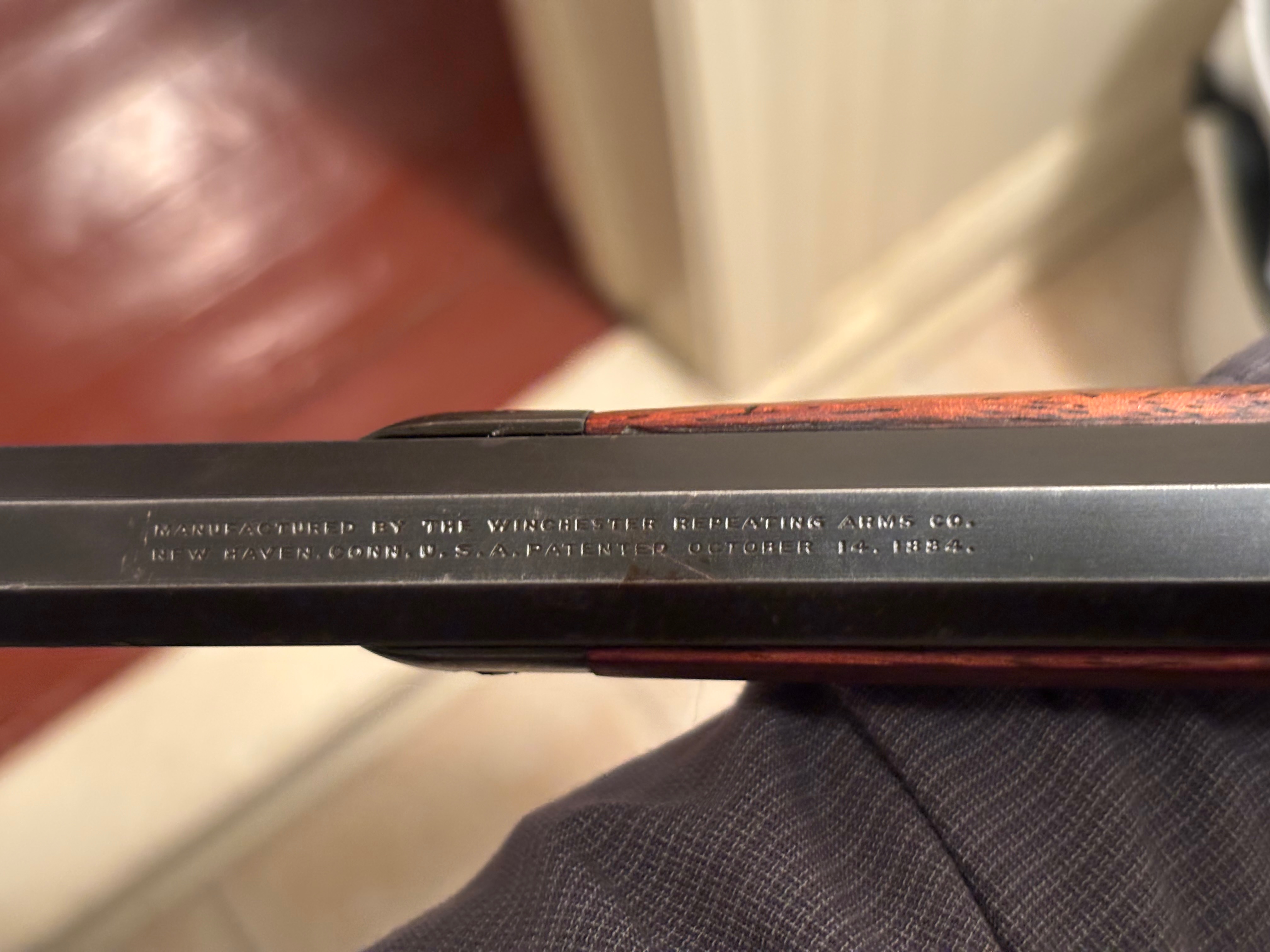

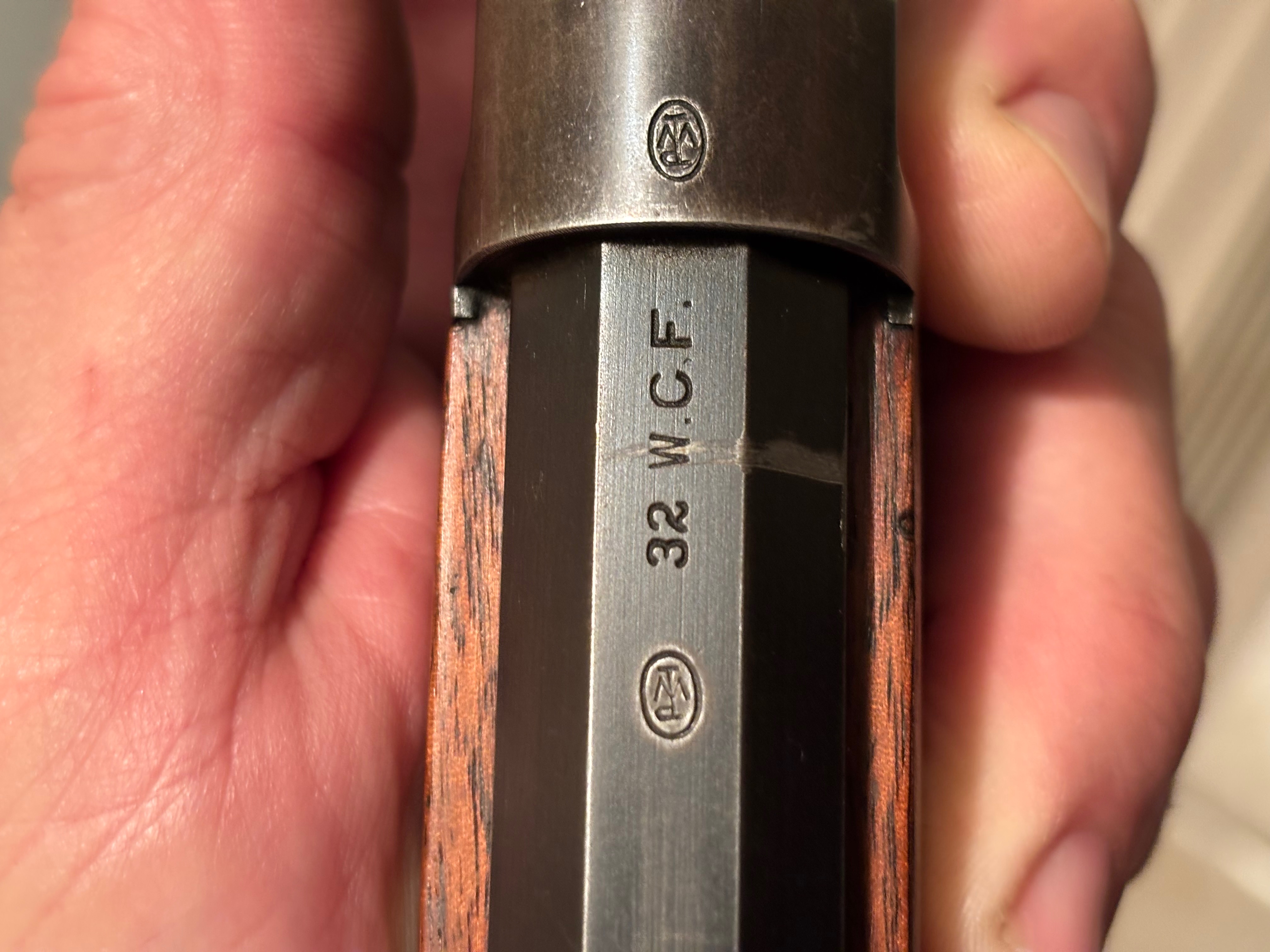

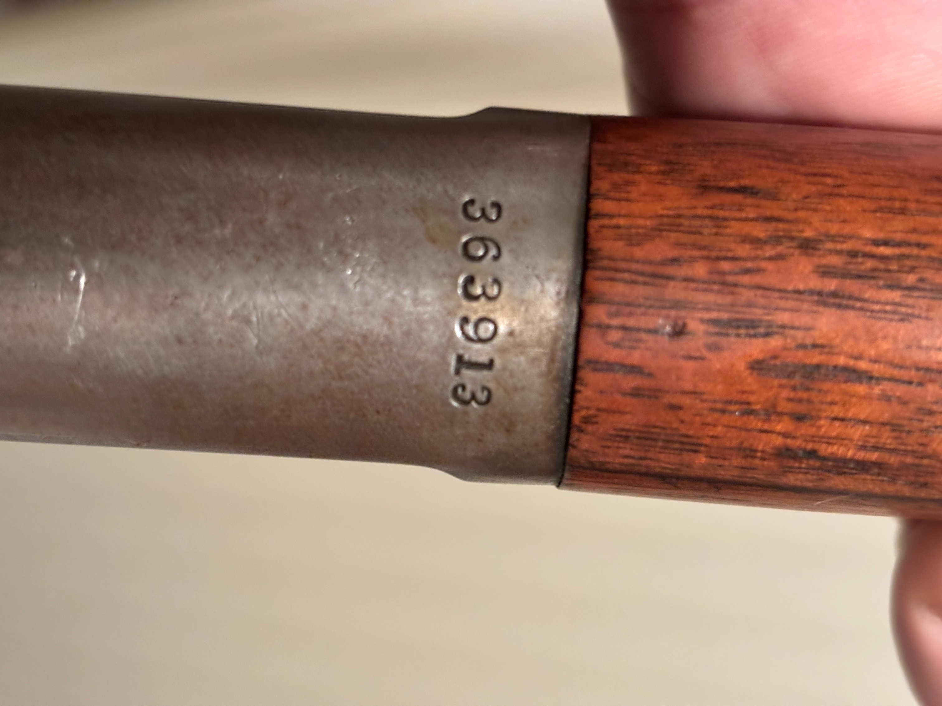

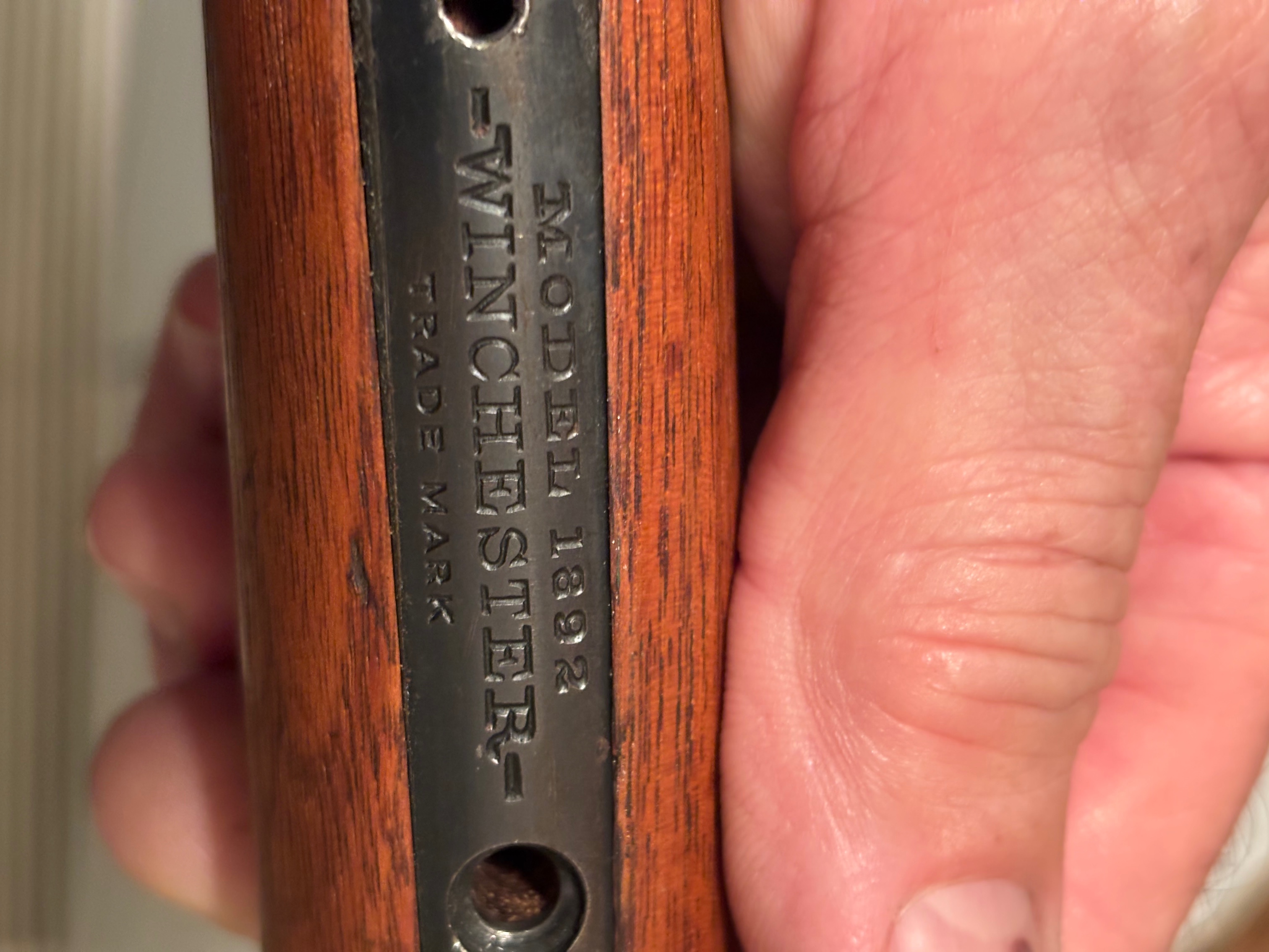

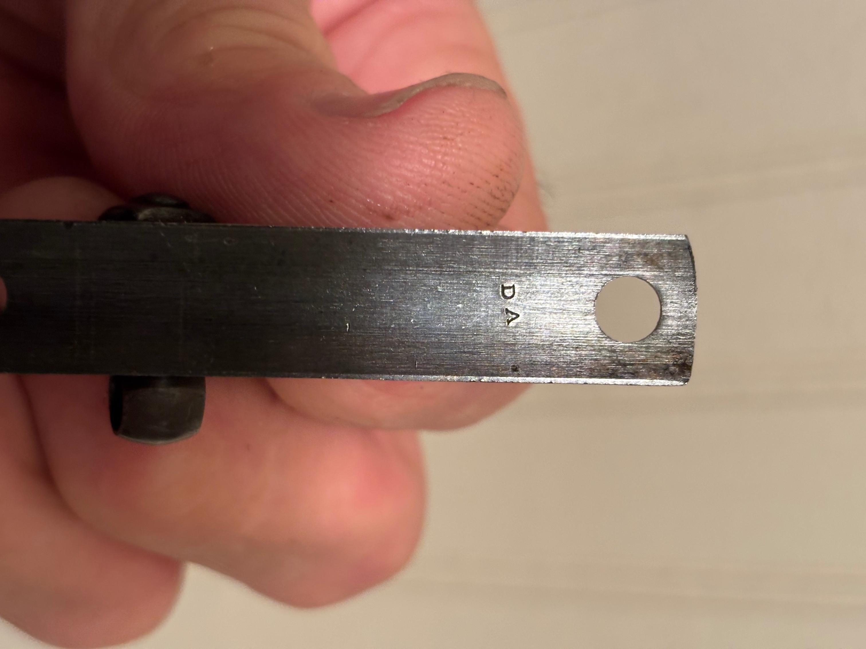

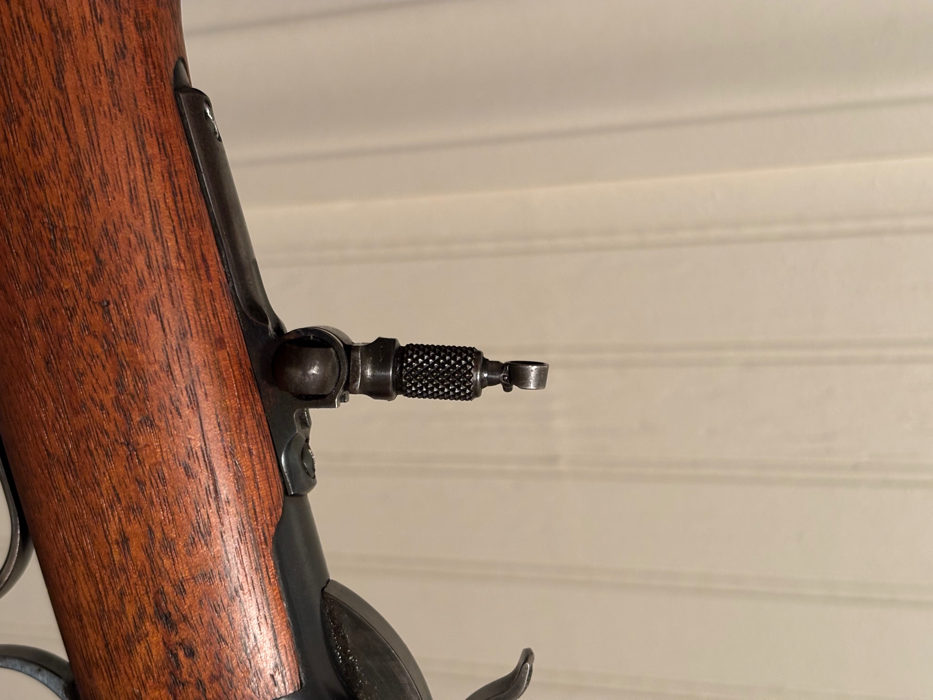

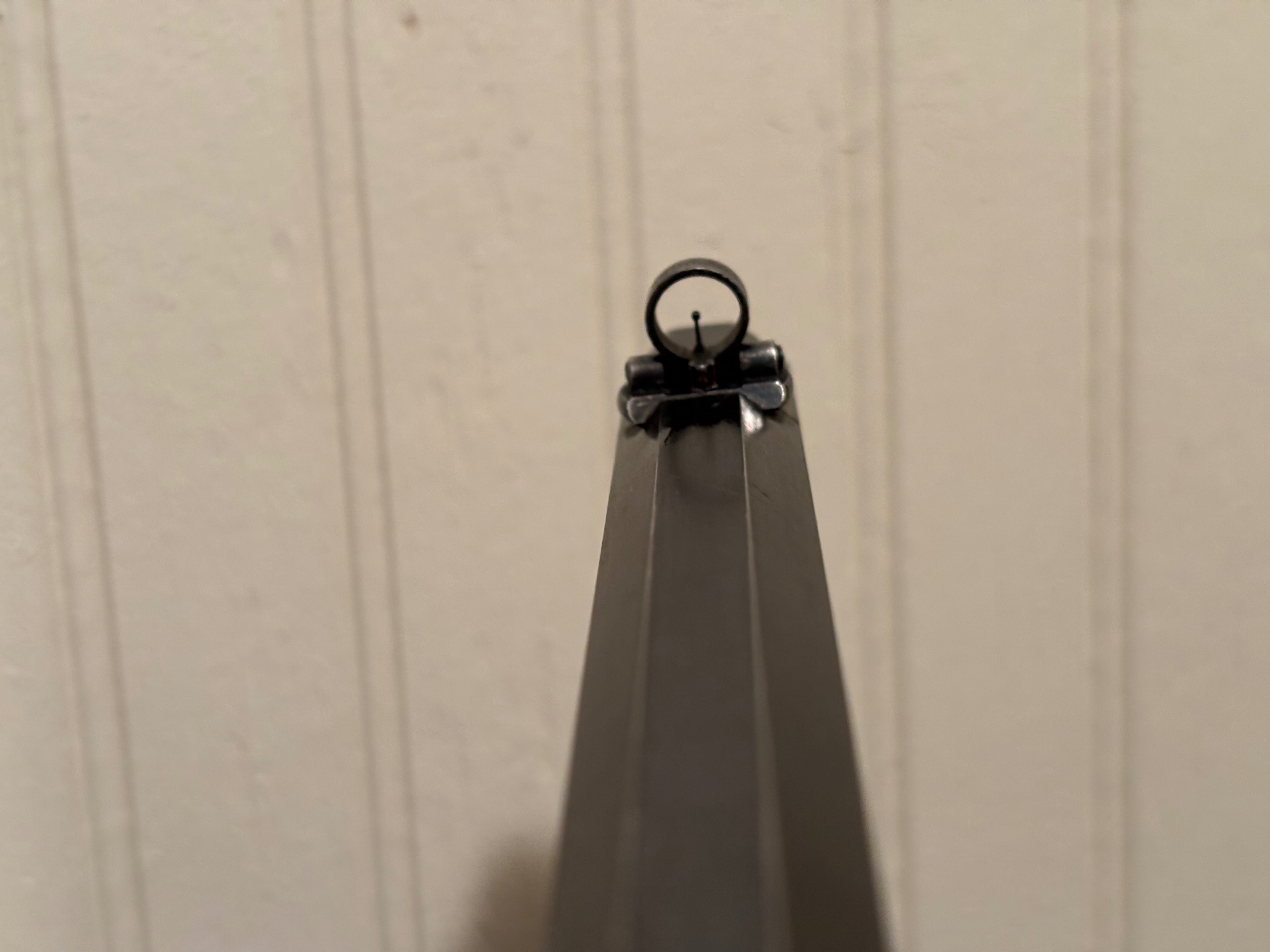

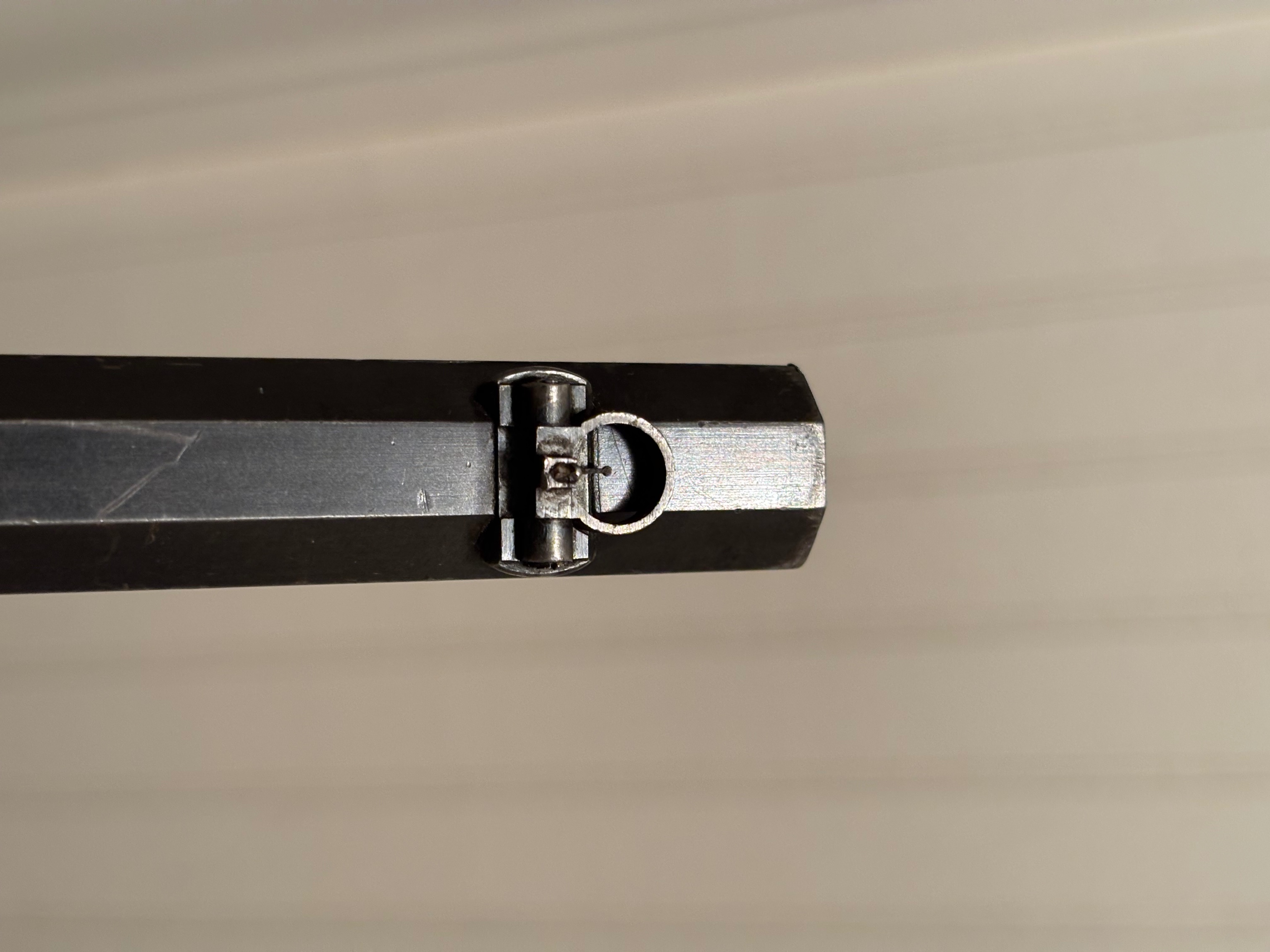

Hello Bob
Could you please post several images of the rifle so taht I can add it into my survey of the 1892’s.  Please include the areas of stamped writing on the barrel and the upper tang.

Hello Bob
Could you please post several images of the rifle so that I can add it into my survey of the 1892’s.  Please include the areas of stamped writing on the barrel and the upper tang.

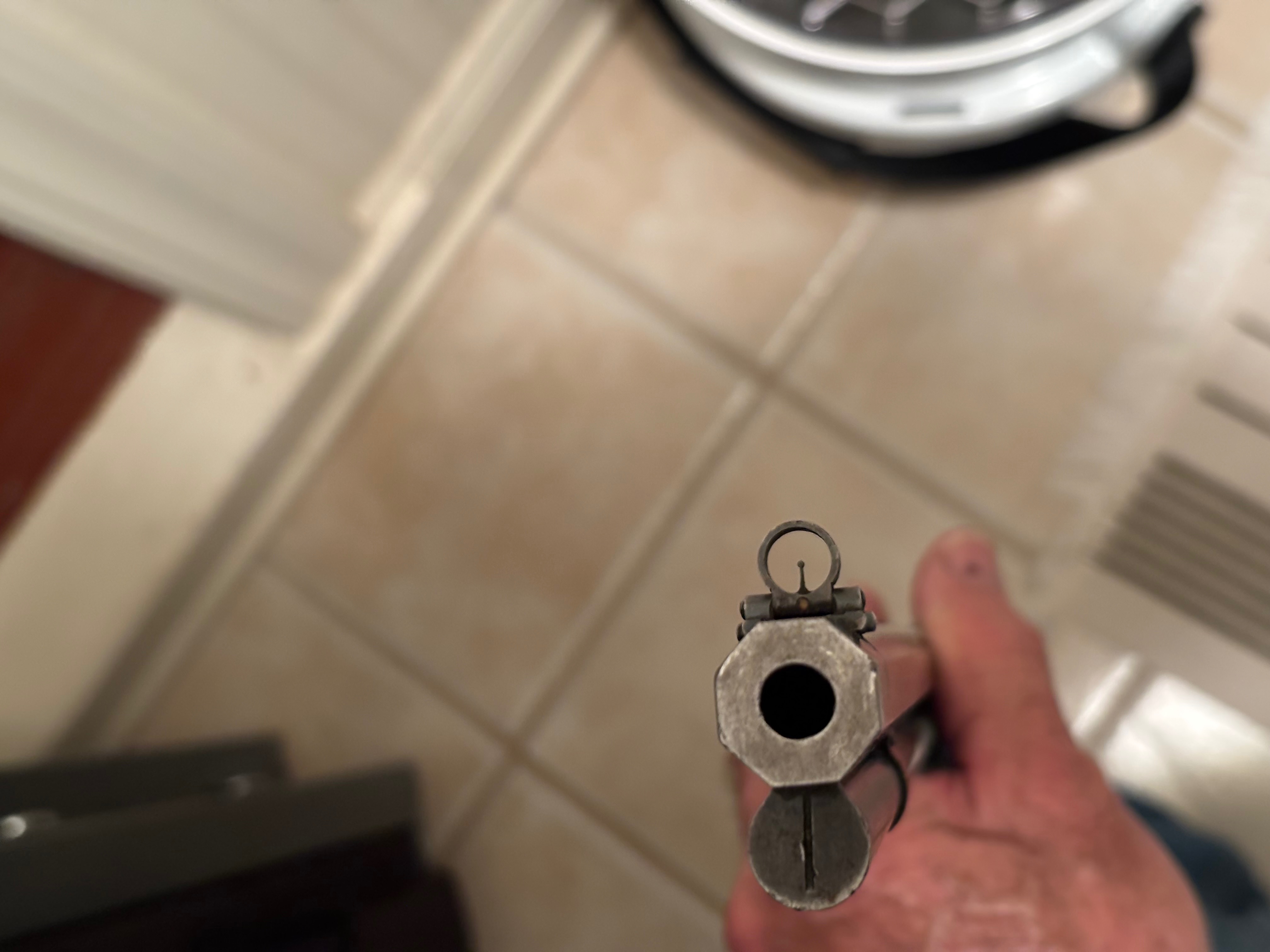

Robert Jambrosic
Forum Posts: 17
December 30, 2023
July 25, 2025 - 12:01 pm

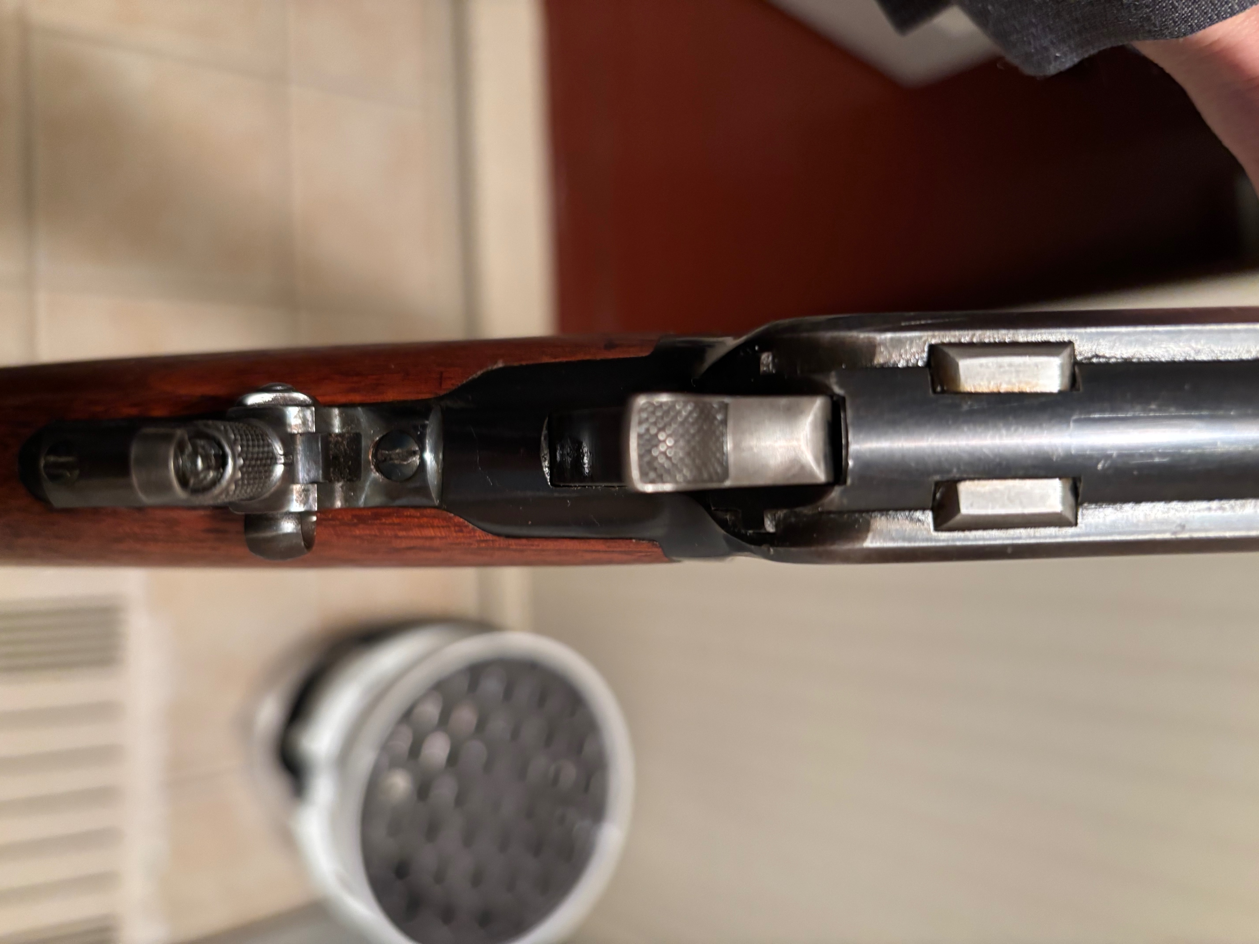

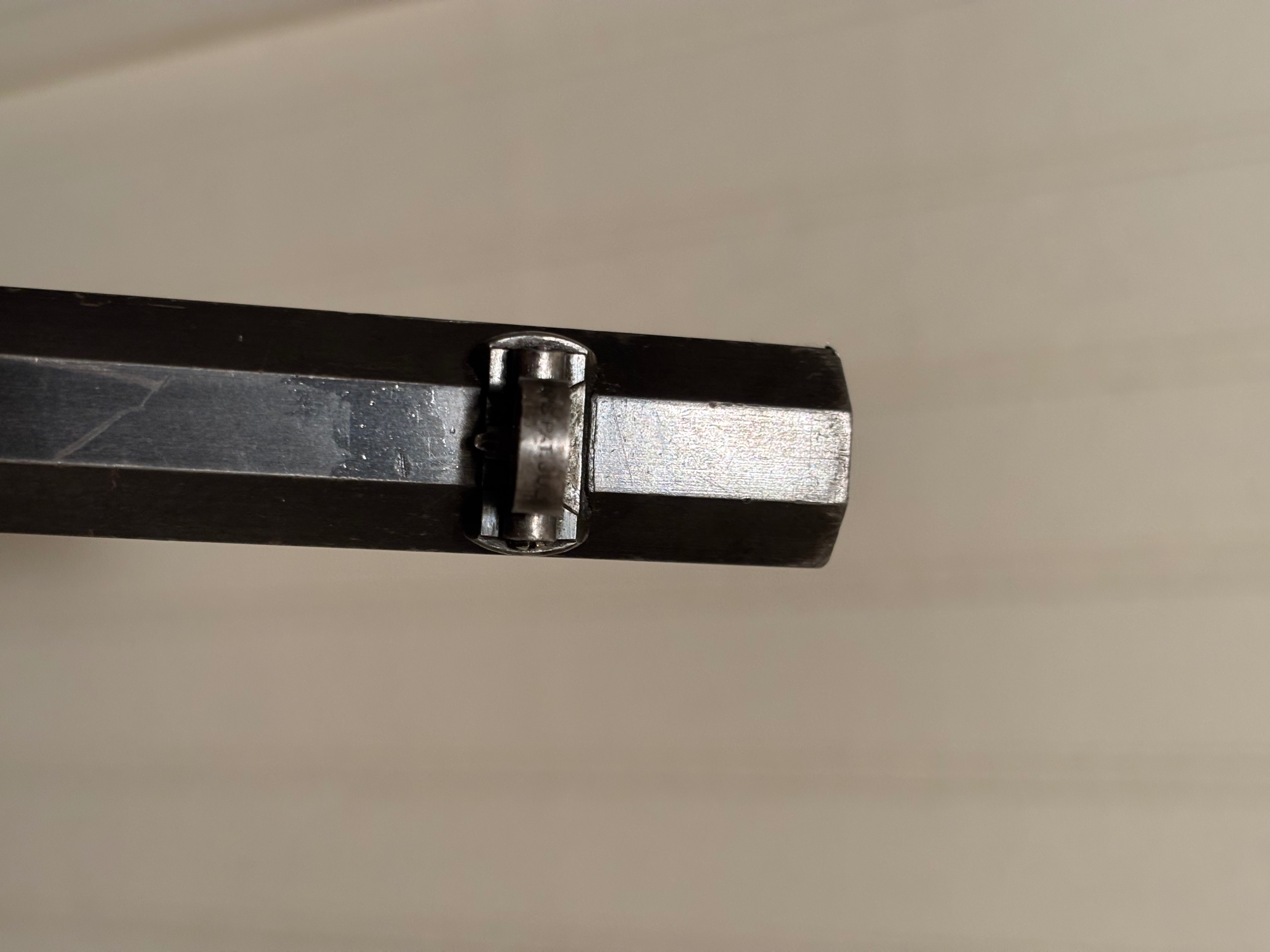

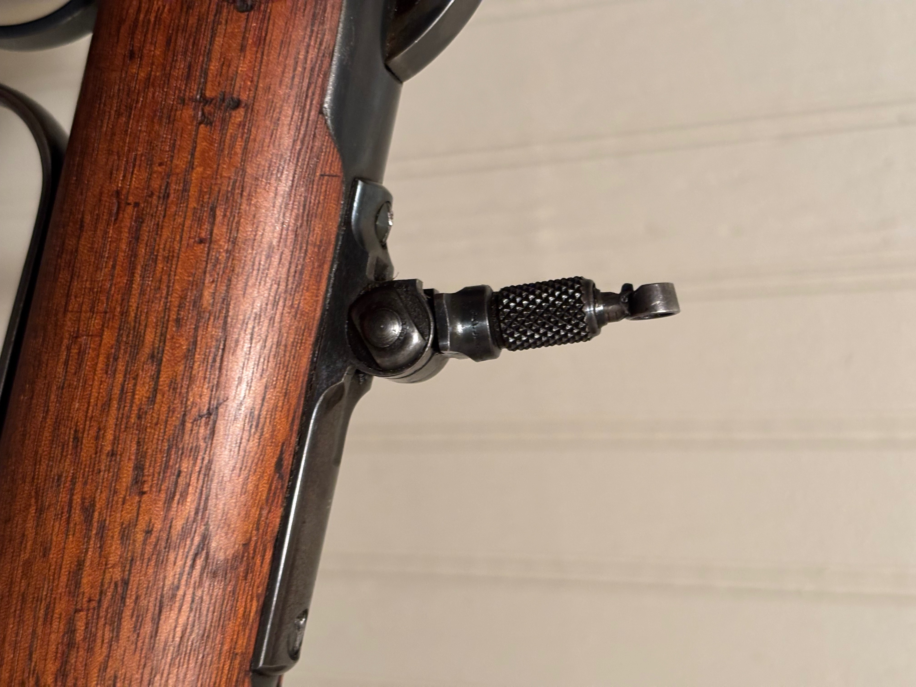

Michael, Here are the pictures of my rifle you wanted for the survey.
IMG_0607.jpegIMG_0605.jpegIMG_0604.jpegIMG_0603.jpegIMG_0602.jpegIMG_0601.jpegIMG_0600.jpegIMG_0599.jpegIMG_0598.jpegIMG_0597.jpegIMG_0596.jpegIMG_0595.jpegIMG_0594.jpeg
