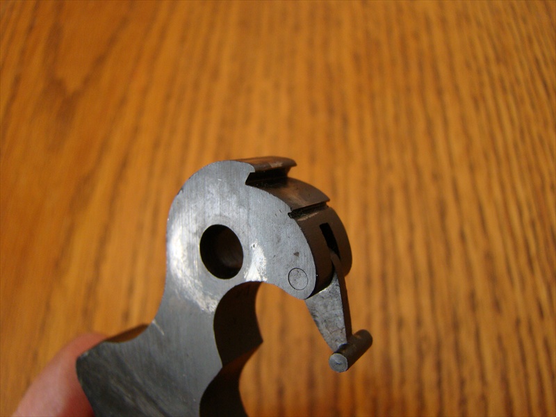

Problem #1, in my experience, is usually due to any part or combination of the following:
The hammer and sear aren’t mating properly when the hammer is cocked.  You didn’t mention whether the hammer will stay cocked when done so manually.  Usually this is caused by the surface of the full-cock notch on the hammer has worn down or been filed down in an attempt to produce a hair-trigger effect.
Good safety notch and cocked notches should look like this.
This hammer shows the safety notch broken and the full cocked notch filed down.
Hope this helps.
