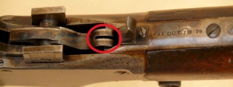

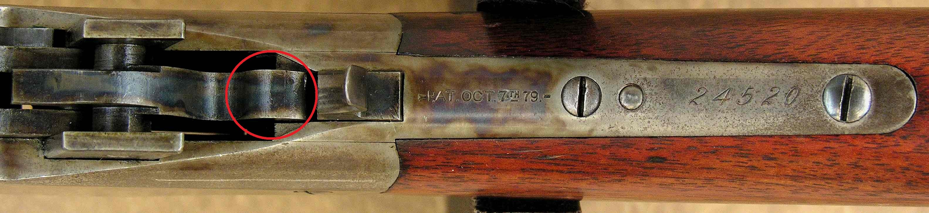

Ordinarily, the tapped 5-56 threaded hole directly behind the trigger indicates a single set trigger.  However, some early production Single Shot rifles are found with a trigger made for a set trigger rifle, but do not have the requisite associated parts. In addition to the trigger itself, the hammer for the set trigger is different.
This is a hammer for a plain (non-set) trigger;
This is a hammer for a set trigger;
As you can see, the bottom lobe of the hammer is milled with a longitudinal groove to accommodate the set trigger fly, whereas the plain trigger hammer is not.

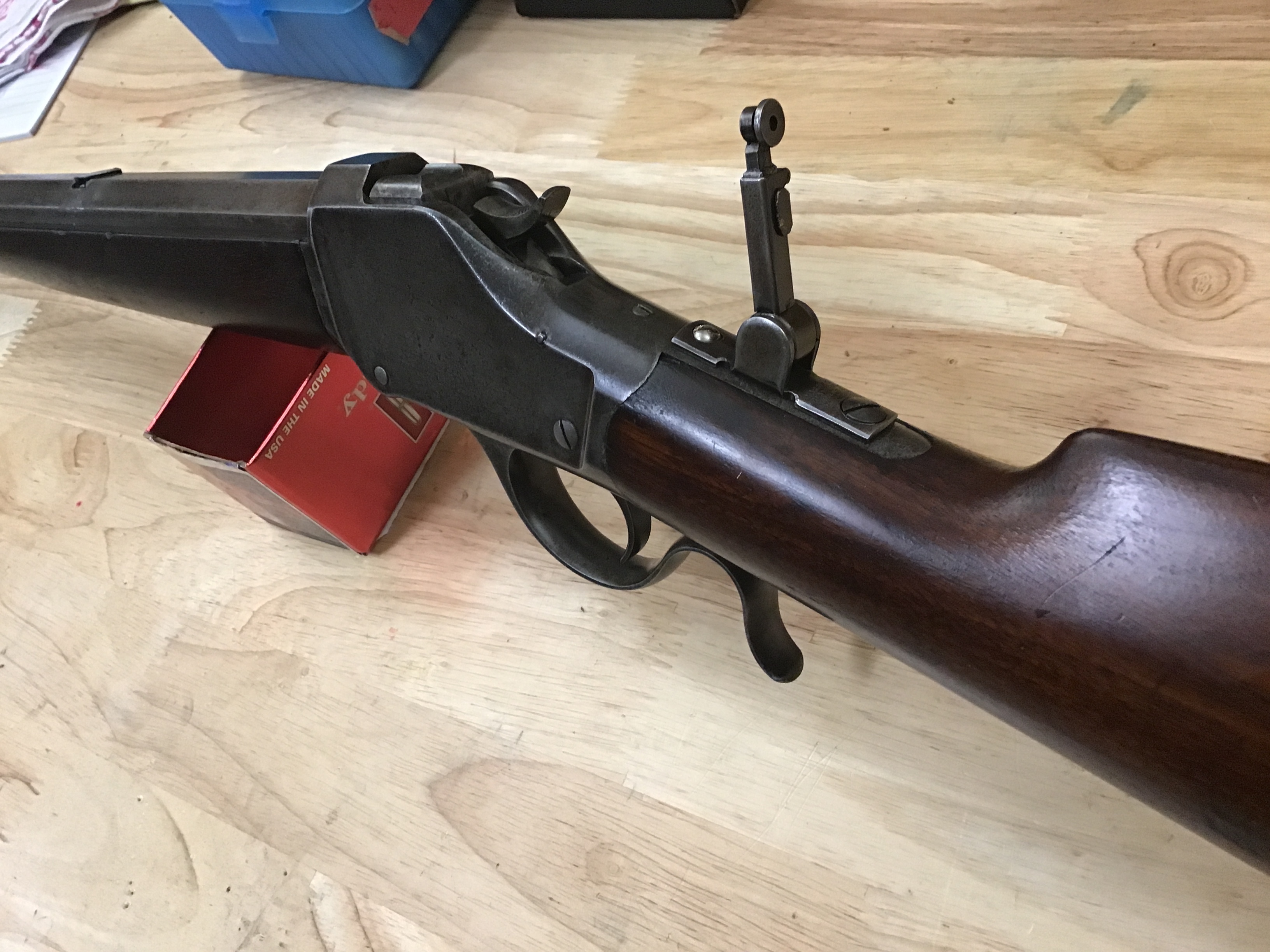

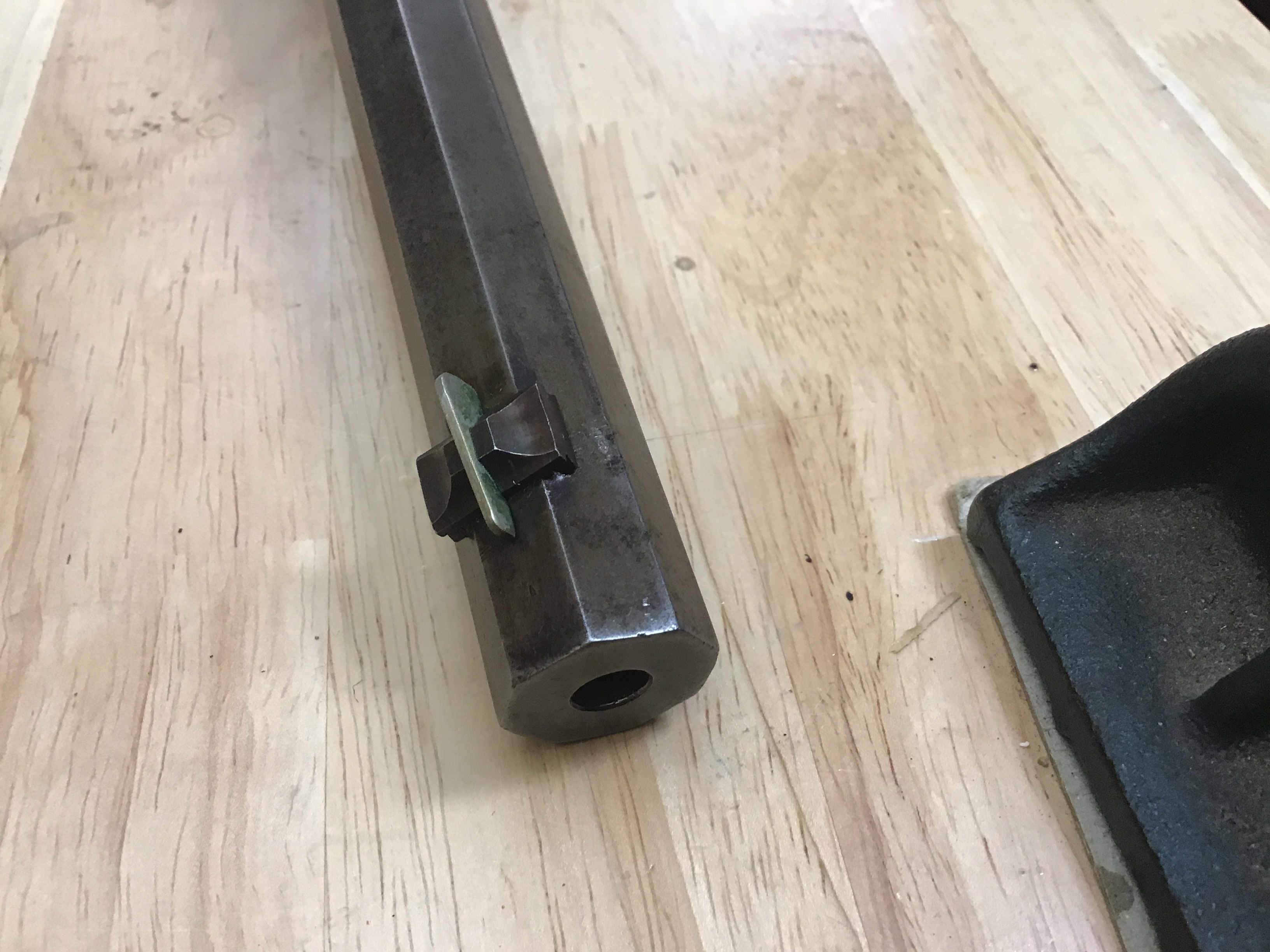

Can any of you gents tell me anything about the Marble Tang Sight? The hole spacing seemed unusual to me as the front screw doubled as the anchor for the top tang spring. Is that unusual or am I just learning new stuff? Is the front sight original? The buckhorn rear sight is AWOL.
yours,
Jon
Forum Posts: 2103
August 15, 2026 - 12:06 am
Jon,
Nice find! You don’t see too many with the octagon top of the receiver, vs. the round top. We’re careful in using the word “rare”, around here but they are not seen often.
Thanks for sharing and posting the pics!

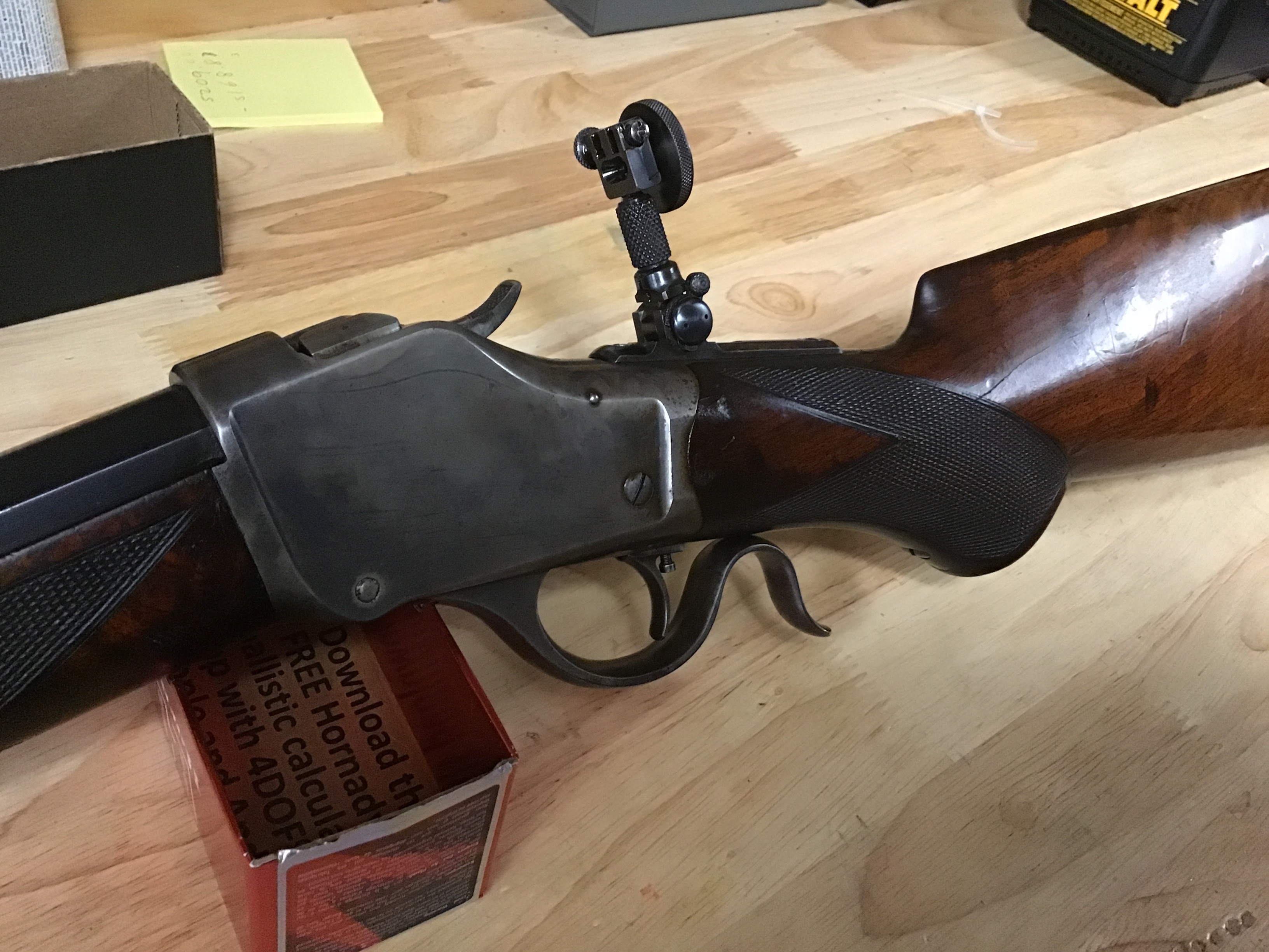

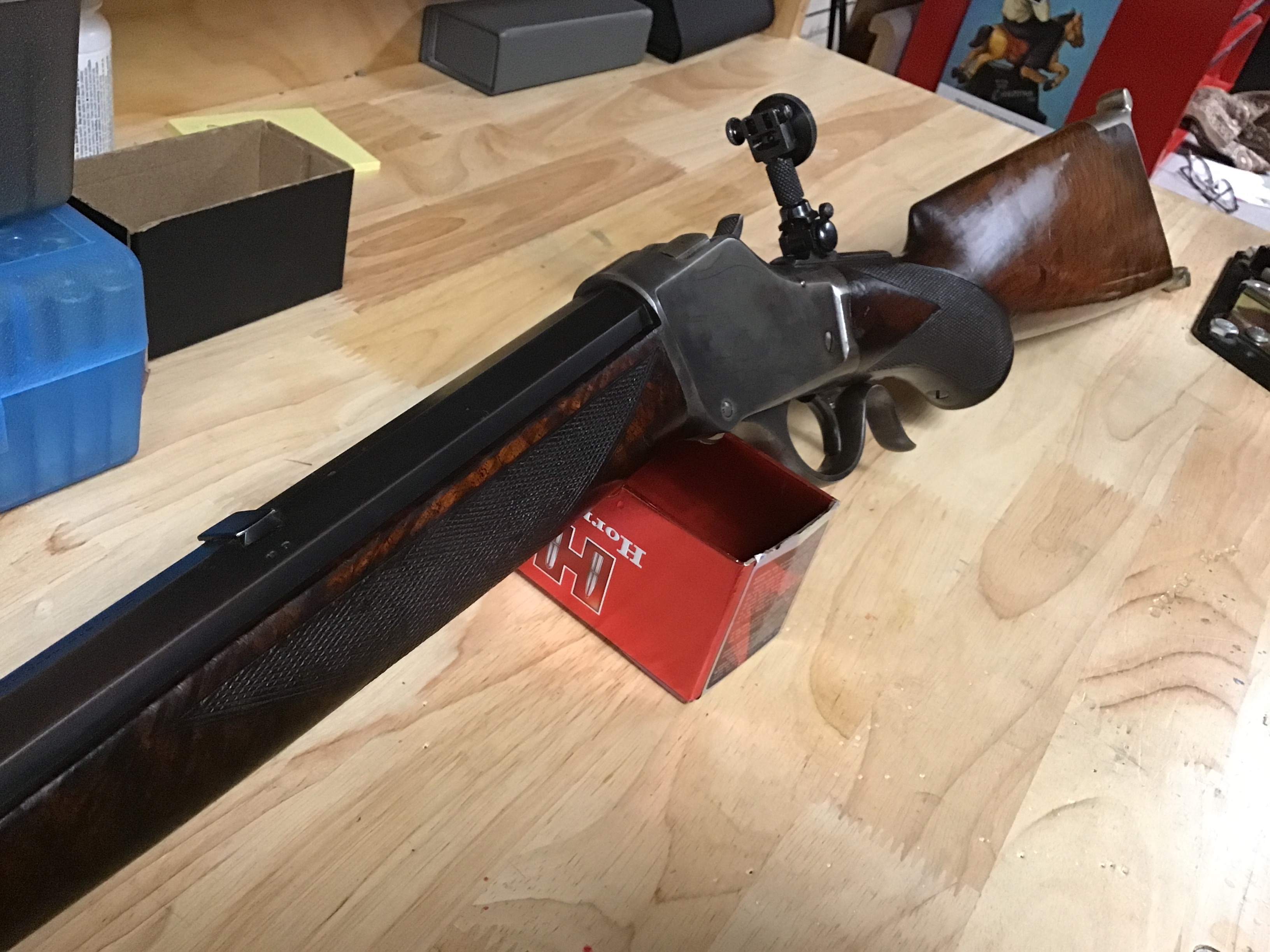

Another from the same auction in 32-40. 35561 for Bert. Nice bore too but couldn’t get it sighted as the front sight (.321 height base to center) with a combo lollipop/aperture flipper. Nice sight but won’t work with this tang sight. Is this a Lyman #103?  Adjustments are really stiff but I like the idea with windage. Maybe it will loosen up a bit. I doubt the rifle has been fired in several decades. Once again, any advice is appreciated.
Jon
Honest Jon
Forum Posts: 39
July 7, 2026
August 15, 2026 - 12:23 am
Last post not very clear. The front sight is too low. Still shot about a foot high at 100 yards.
Jon
Forum Posts: 14975
August 15, 2026 - 1:32 am
Jon
The Lyman wind gauge tang sight is a No. 52A, and it is not original to the rifle.  Ordinarily, that tang sight was paired up with a Lyman No. 5B combination front sight.

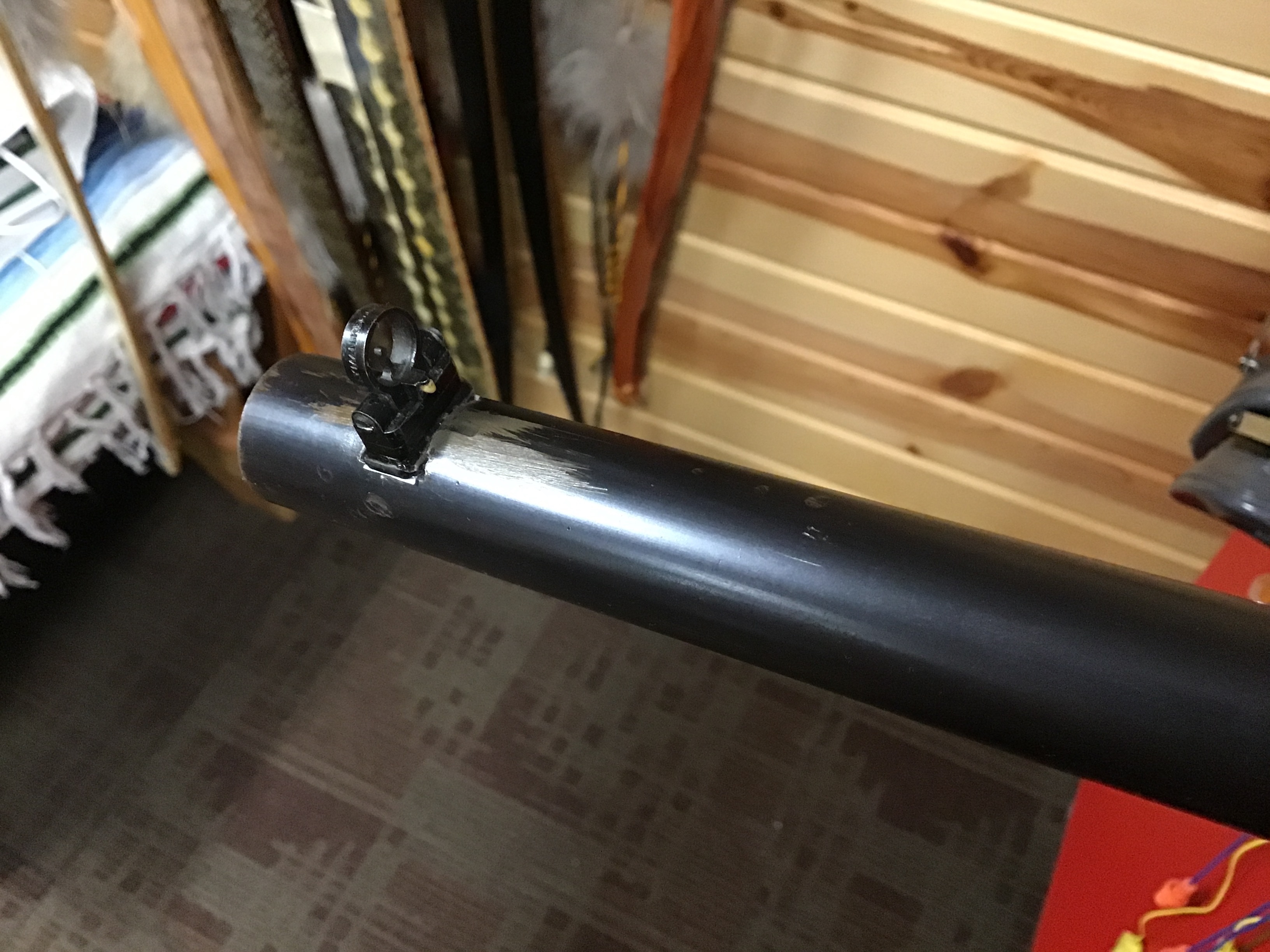

Thank you once again Bert. Late this afternoon I slid an ancient Beach folder sight to match up with the wind gage sight.  The Beach measures .494 base to center post.  It got dark here tonight so didn’t have time to try it.
Would that be similar to the Lyman 5B in height?
Jon
Honest Jon
Forum Posts: 39
July 7, 2026
August 15, 2026 - 3:03 am
Hold the phone Bert! The sight I put on late this afternoon IS a Lyman 5B. I always thought it was a Beach but it has the two threaded screws as the pivot for the post and ivory. See below.
Forum Posts: 14975
August 15, 2026 - 6:01 am
Jon
Yes indeed, that is Lyman No. 5B combination sight.

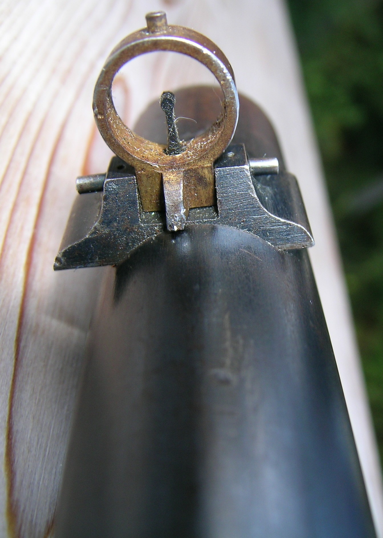

This is a real Beach sight;
Forum Posts: 1649
August 15, 2026 - 1:50 pm
I believe that is a Marbles “Simplex” tang sight, and without seeing the code on the back, I wouldn’t know what it’s for. I have one for a 1894 with a W9 code. Bert, ain’t that Beach front sight pretty far off to the left of center on the barrel.
Forum Posts: 14975
August 15, 2026 - 4:04 pm
It is a bit left of center… and dirty too!
