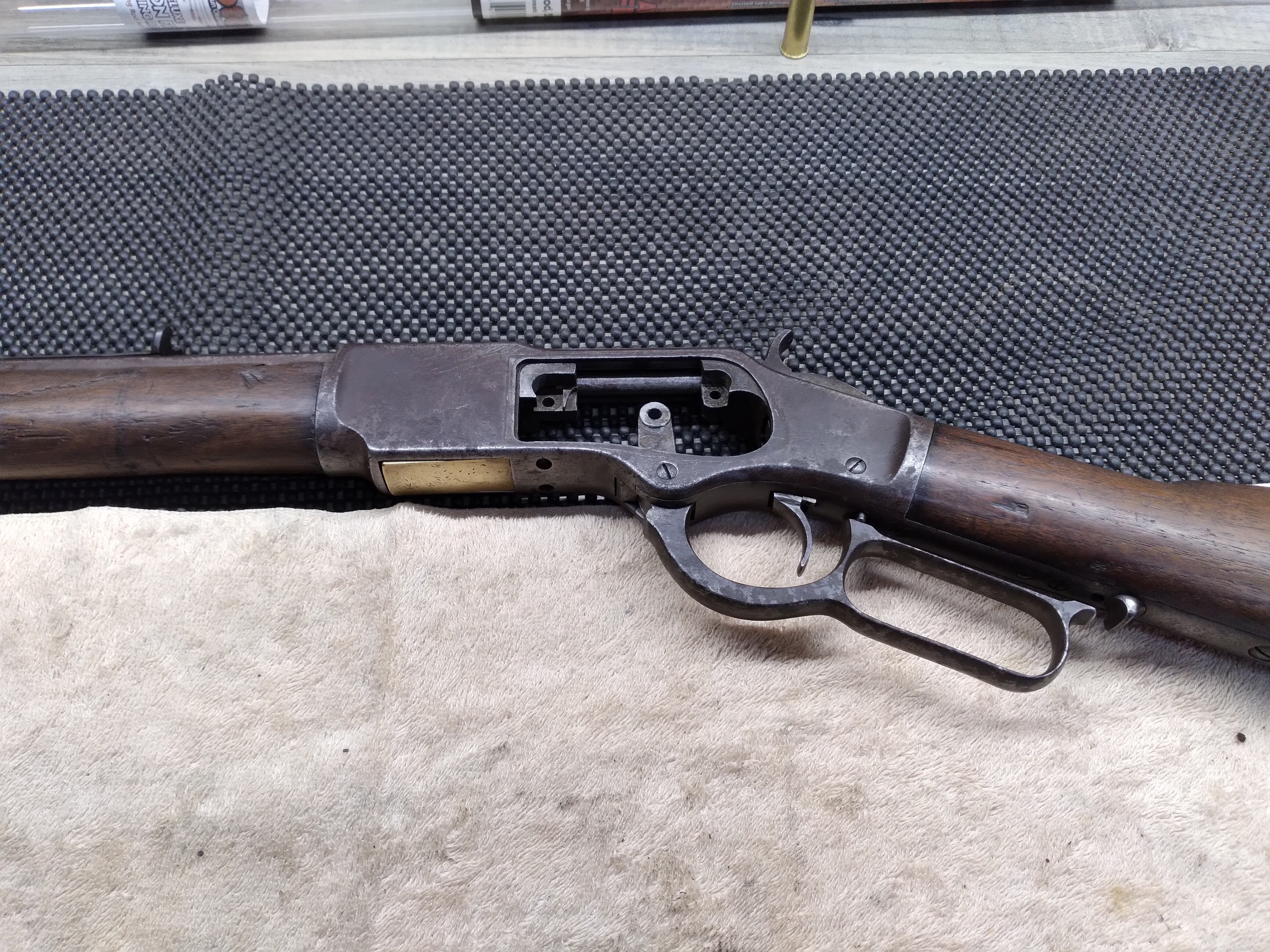

Hello., got some pictures of the73,  I bought it on a online auction. Wasn’t as great of shape as described . But trying to work a few bugs out. Will try and post the pictures for you Bob. Don’t know what I will do with it yet. Problem is that when I cycle the action the firing pin hangs  up on hammer. Havent determined  yet if the hammer is not going back far enough and the firing pin is  getting hung up on the hammer, or the  lower tab on the breechbolt is going past the carrier and sticking  in front of the reciever. Have a few picture I might have to send them to  Bob. If I hold the hamme back when I cycle the action, it works fine.

20210406_090900.jpg20210406_090857.jpg20210406_090610-1.jpg20210406_085747.jpg20210406_085444.jpghere are some photos
Forum Posts: 4993
April 7, 2021 - 3:45 am
Rob
Figuring out feed issues is very hard without the gun in hand. What I can do is give you some thing to look at and some things to try. When you try to lever the action closed and it locks up, look at the bolt face to see if its hitting the elevator. If its not then you need to remove the firing pin and look for a notch in it where the hammer rides on the pin.

Thats what I think is happening Bob.  It looks like there is a slight bevel on the rear notch of the firing pin that hang  up on the hammer when I cycle the the breech carrier closed.
