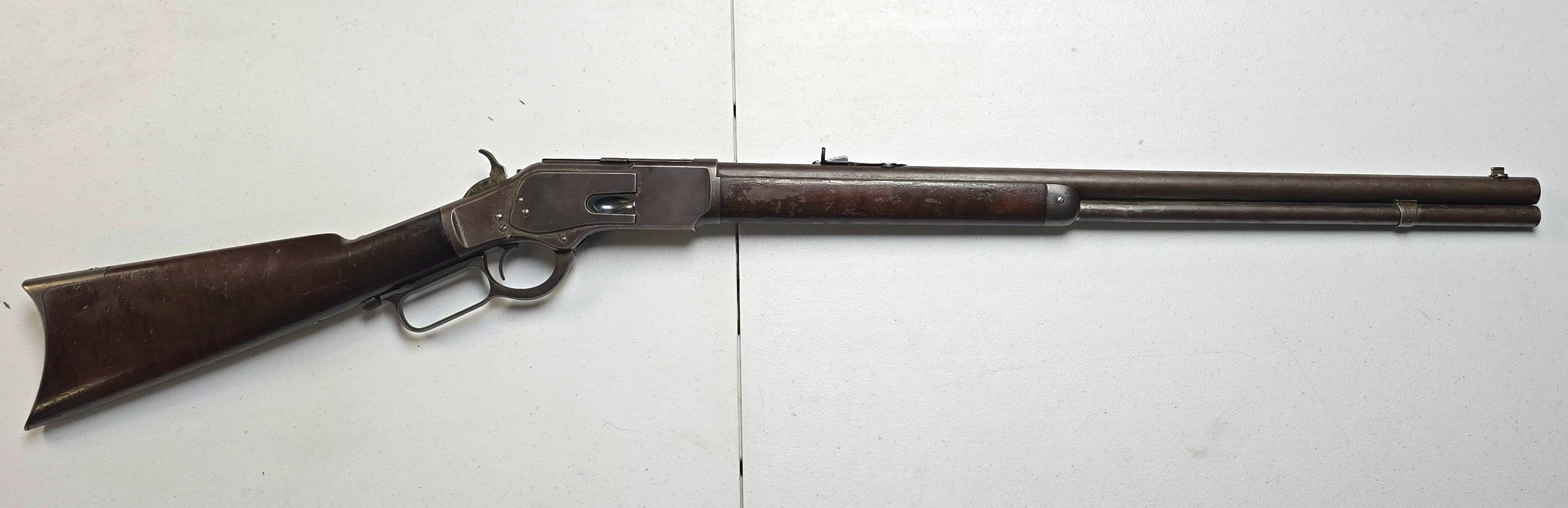

Thought I’d post and get you guy’s thoughts on my 1873 2nd model. This one won’t win any rewards for remaining blue, but mind you I am young guy operating on a beer budget.
Always enjoy doing finish work and refinished many pairs of Smith and Wesson grips. This is the first of likely many Winchester refinish projects for me as I just really enjoy the work.

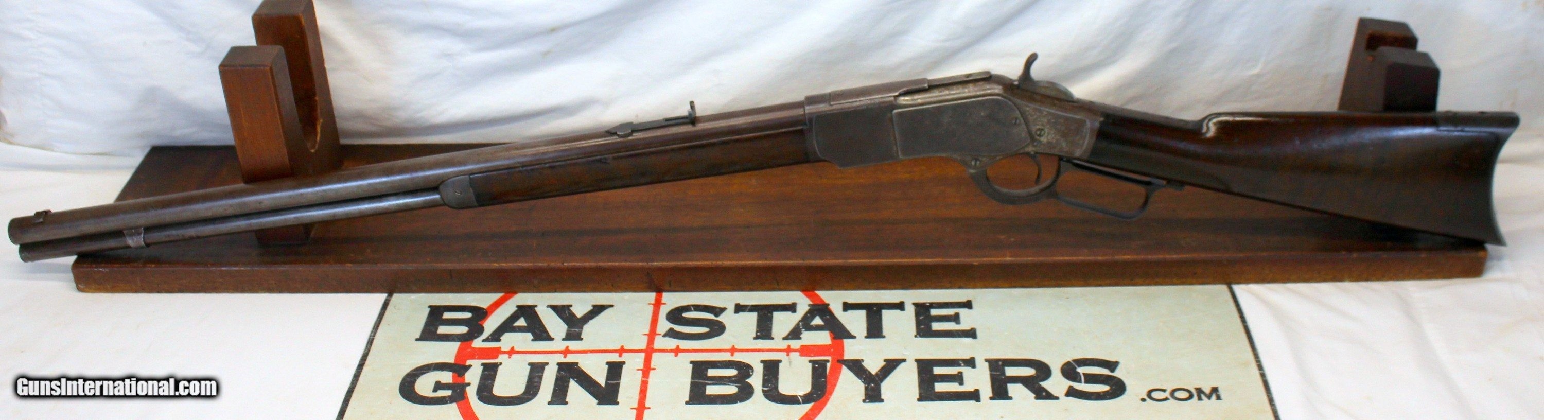

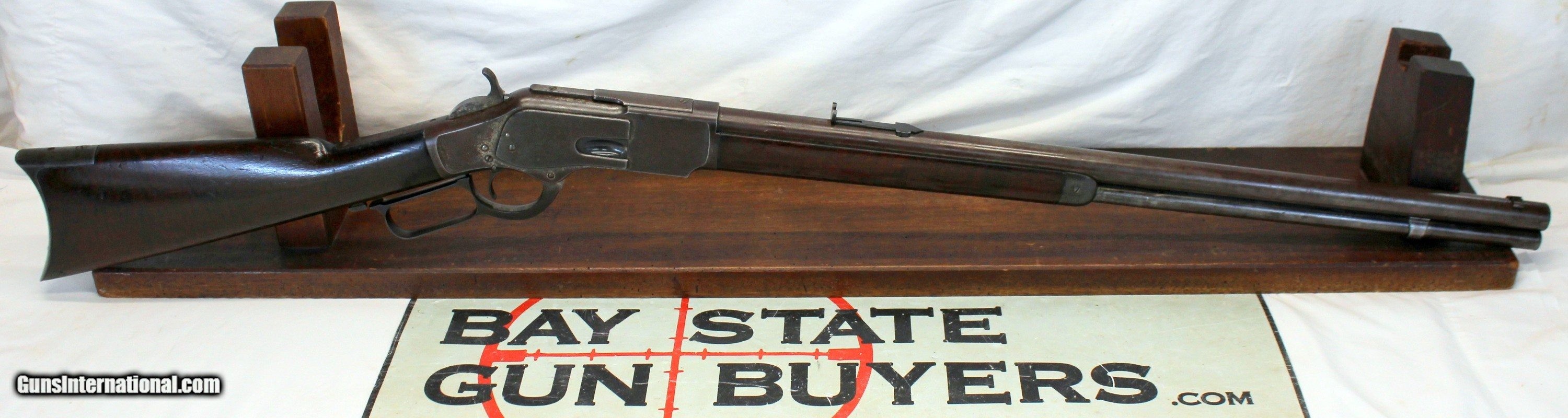

The gun came to me having been poorly refinished at some point, or atleast refinished so long ago that it looked real bad when I got it. It had a very thick clear coat on it that was heavily tinted or oxidized to a greenish hue. It took a good bit of soaking in acetone and scrubbing to get it off. I could tell it had decent wood grain underneath, but the finish was so green and dark, I honestly had no idea that the figure was as prominent as it is, even looking at it in decent light.
Because it had already been sanded and refinished once, I did not want to remove any more material that would affect the wood to metal fit as it was already close to being shy of the tang. I didn’t attempt to steam any dents either. In my opinion, a perfect stock would look weird on a gun with approximately 1% remaining metal finish. I don’t love an inch of clear coat over a deep ding in a stock either. For these reasons, I elected to do an oil finish regardless of historical accuracy (I honestly don’t know what the wood finish was on 73’s of this era. If somebody does, enlighten me!).
Im happy with how it has turn out so far. Managed to keep a little bit of the patina/hand oil at the wrist, and some of the grime near the buttplate as well. Maybe I am a weirdo for liking that.
Few questions for the forum:
Should I keep building up coats of oil, or call it quits here? Aside from being first Winchester stock I have redone, this is the first tung oil/soft oil product I have used, as most of the time I used a laquer or tru oil on smith grips and filled the grain entirely. In general, it seems like most old oil finish rifles don’t fully fill the grain and always look a bit dry hence why I stopped here and assembled. Looking for thoughts and opinions.
Question number 2: How do you feel about what I have done, and is it a kosher respectable take on cleaning up an old low condition gun?
Question number 3: If you saw this on a gun show table, would you look it over and haggle with the guy, or is it too low condition for your taste?
Attached are before and after photos.
Before:antique-Winchester-MODEL-1873-Lever-Action-Rifle-44-40-cal-24-Mfg-1880_103278400_43795_626DD7FFE72ACDEB.jpegantique-Winchester-MODEL-1873-Lever-Action-Rifle-44-40-cal-24-Mfg-1880_103278400_43795_1D98437507DC8BA7.jpeg

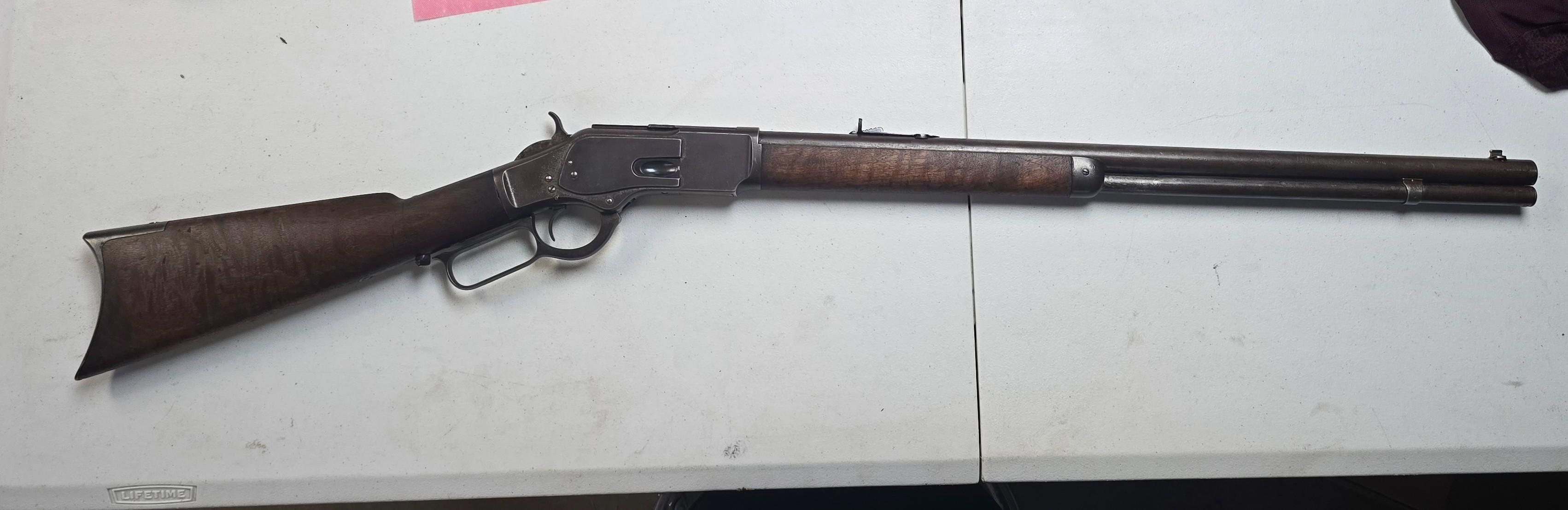

After: 20251105_1013361.jpg20251105_1015471.jpg

  It might be just the pictures, but I really like the before pictures, not the after. An antique gun that shows it’s age looks nice to me. The before pictures seem to show an old gun with sealed wood and sealed wood to metal fit like an old original well used gun would look. The oil should not be thick. T/R

I like your refinish a lot better than the oxidized and failing prior refinish.  I don’t pretend to any expertise about the Model 1873 and base my opinion of what an original finish would have looked like on a pair of 1873 rifles in “like new” condition in the Cody museum. They were displayed as a crossed pair in a walk-around vitrine, with a placard saying they had been sunk in a harbor during shipment and then completely refinished by Winchester.  I cannot say the wood finish was oil or varnish but it had a low gloss shine rather than a matte finish, the same finish I’ve I’ve seen on Winchesters made for foreign military service.
I believe Winchester’s in-house subcontractors used a drying agent when applying an oil finish. Otherwise, to get an oil finish cured out hard enough to sell would take weeks. I think some used pore fillers on particularly open-pored, flat sawn blanks of Walnut.
I admit to a bias against old blackened wood finishes on Otherwise sound  Century-old guns. Winchester 1873 rifles were never cheap and many owners did not want to let the wood go to hell – for good or for ill, they refinished the wood. Some were professionally done and are difficult to distinguish from original – not all refinishes sand the wood to perdition, or at all.
My own opinion is once an unexceptional antique rifle gets in the condition yours was in — already refinished badly – there is no ethical or practical reason for leaving it in its “original” condition – because it doesn’t have one. Assuming the rifle is mechanically sound with a shootable bore,  I would not hesitate to restore (or replace, in the case of the wood) wood and metal, as accurately as feasible and affordable. Otherwise, the parts market is an alternative.
Others recoil at the notion. You pays your money and you takes your choice.

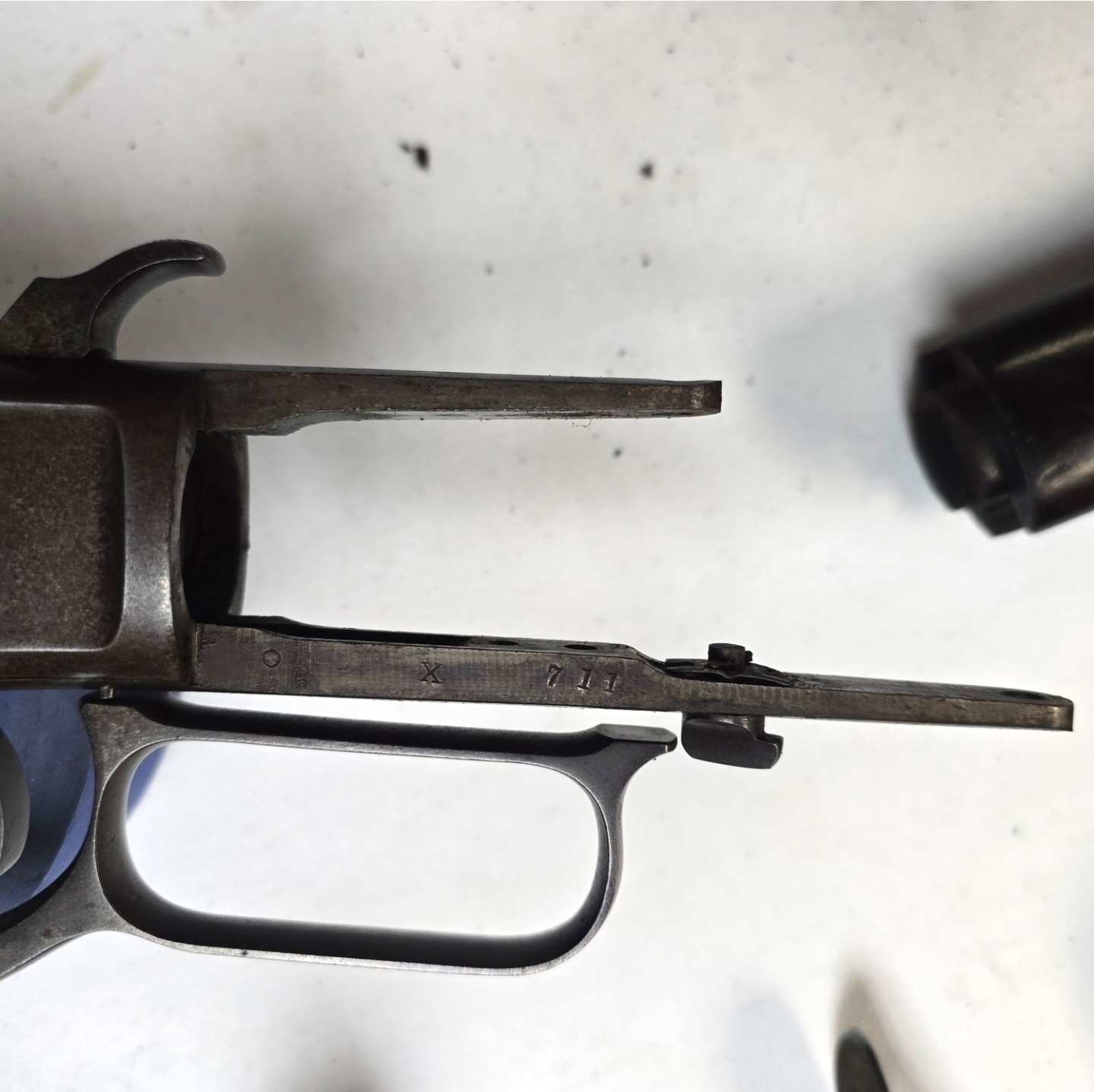

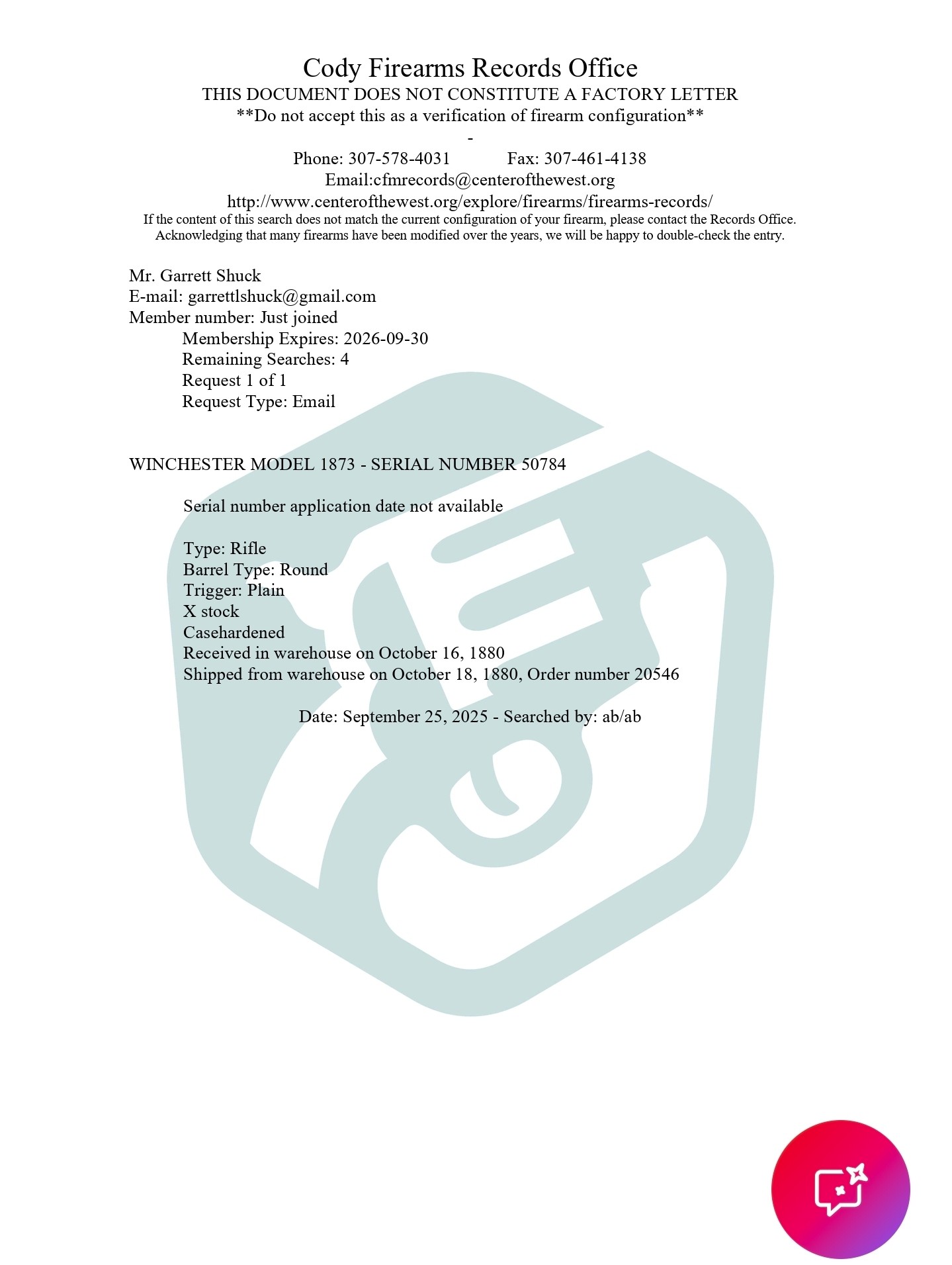

It is indeed a case hardened reciever gun, and letters with X wood. The tang is marked X, with what I am assuming is an assembly number, 711. The stock is also marked 711 confirming original to the gun. Attached is the Cody lookup.
It took me a good while to figure out it was a case gun. I couldn’t figure out why the protected areas on the reciever had silverish flaking instead of faint traces of bluing. Made complete sense when I found out it was case.
Attached are a few more photos of the gun, including a before and after on the same table I worked off of. There is definitely an aspect of age and patina that was lost to the refinish, but I genuinely tried to keep some of the character in it. Maybe these photos do a better job of showing what character is left comparatively to my other indoor shots. As a tradeoff to losing some degree of patina, it went from not being able to see the wood grain, to being able to see a relatively nice piece of figured wood.

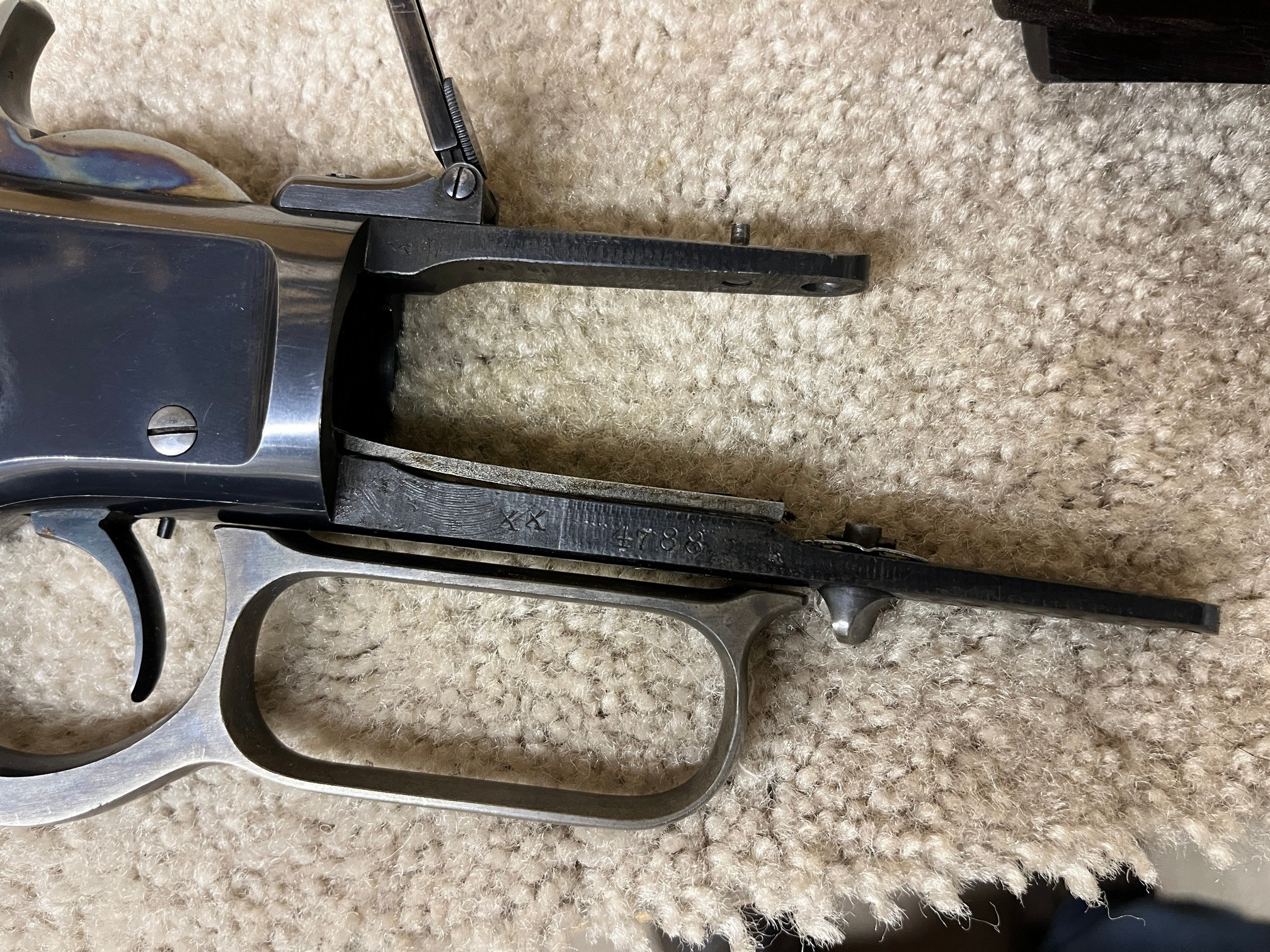

 Here is one of mine that letters X wood and set trigger and is blued and it has varnish finish. The tang is marked 2X. Your probably was varnished.
