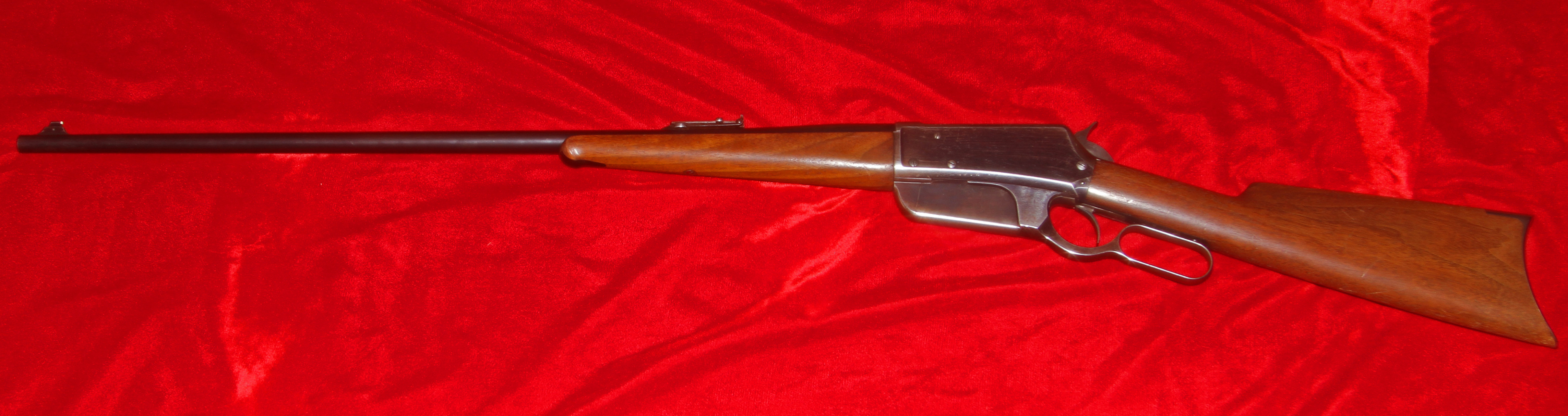

October 18, 2021 - 4:39 pm
Here is a picture to zoom.  This was a 4 mb picture but when posted here it was reduced to 1.3 mb.

Its still a 5.56 mb picture just that the upload process compresses the file so its quicker to upload and download.

That’s a very decent looking flatside.
