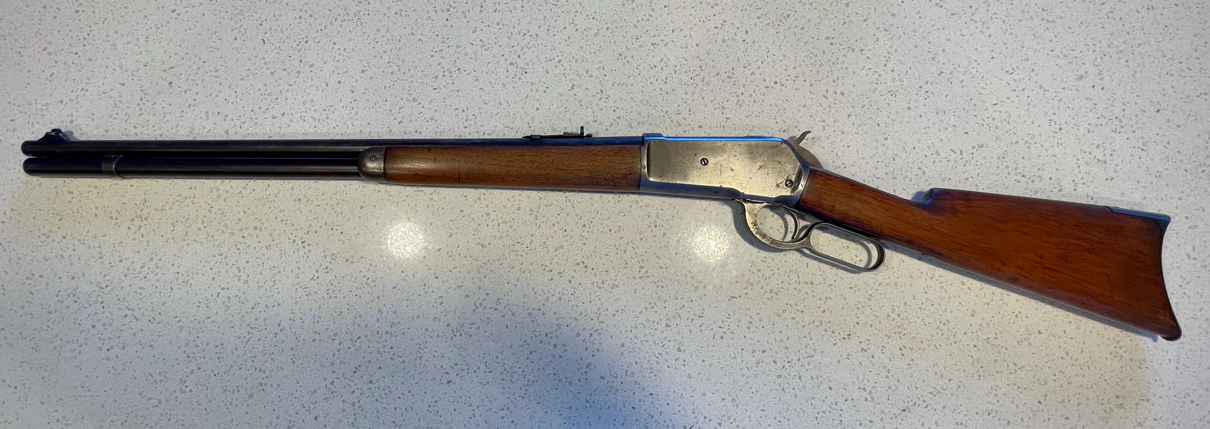

Hello Gentleman,

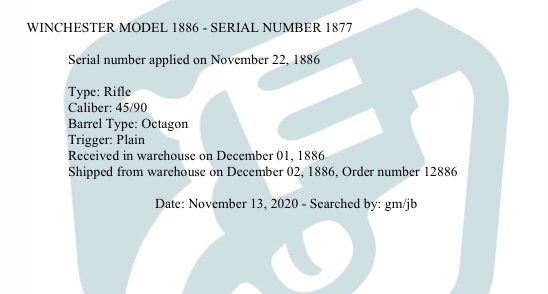

Looking for some input on what you think the valuation of such a gun is worth. It is a first year production 1886 (I have the letter it was originally a 45/90) that was at some point changed to a 33 WCF. Gun is a shooter, good shape and seems all original besides the barrel of course.
I understand the unoriginal configuration makes it considered a non collector, but it is still an interesting firearm due to its manufacture year. I just got another nice 33 WCF from 1903 now so figured I would release the first year from my collection.
Any ideas on how much the barrel change damages the value? It shoots well enough that at a certain price point I would just keep it for that reason alone.

Does the factory letter indicate a “R&R” after 1902 ?  Was the original 45-90 barrel octagon ?  Can you provide pictures of the rifle ?

Sure, I’ll DM you the letter. Give me a minute to take pics. Appreciate all the help!

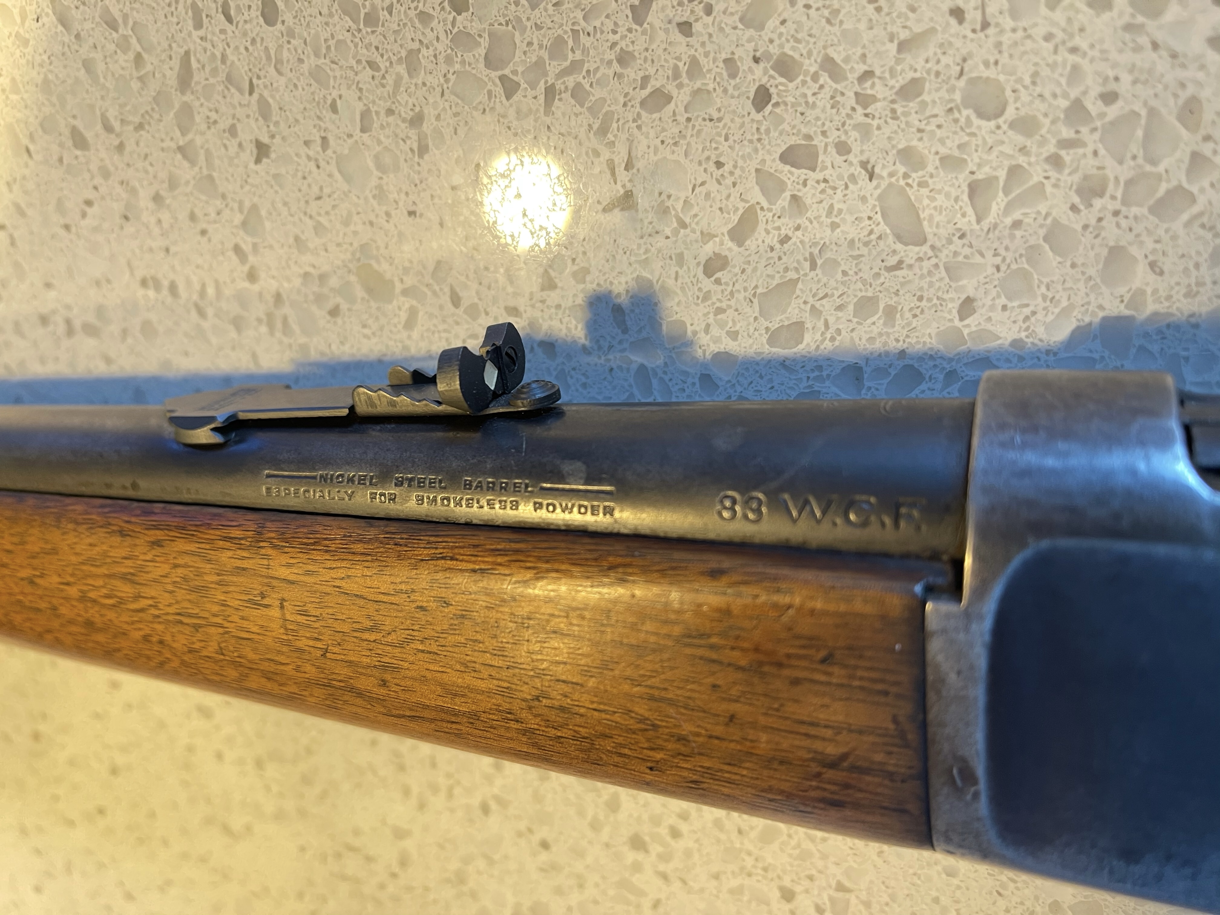

I have a fondness for .33’s so it would be fun to see some photos.  With the possible exception of factory work, any way you slice it, the rebarreling turns this rifle into shooter status vs. collector status. However, as far as value, condition comes into play.  A large amount of original finish vs. a hot tank reblue, for example, impact desirability by a large measure.  I’m also wondering if it is just a .33 barrel that was added or the .33 front end was added.

Steve,

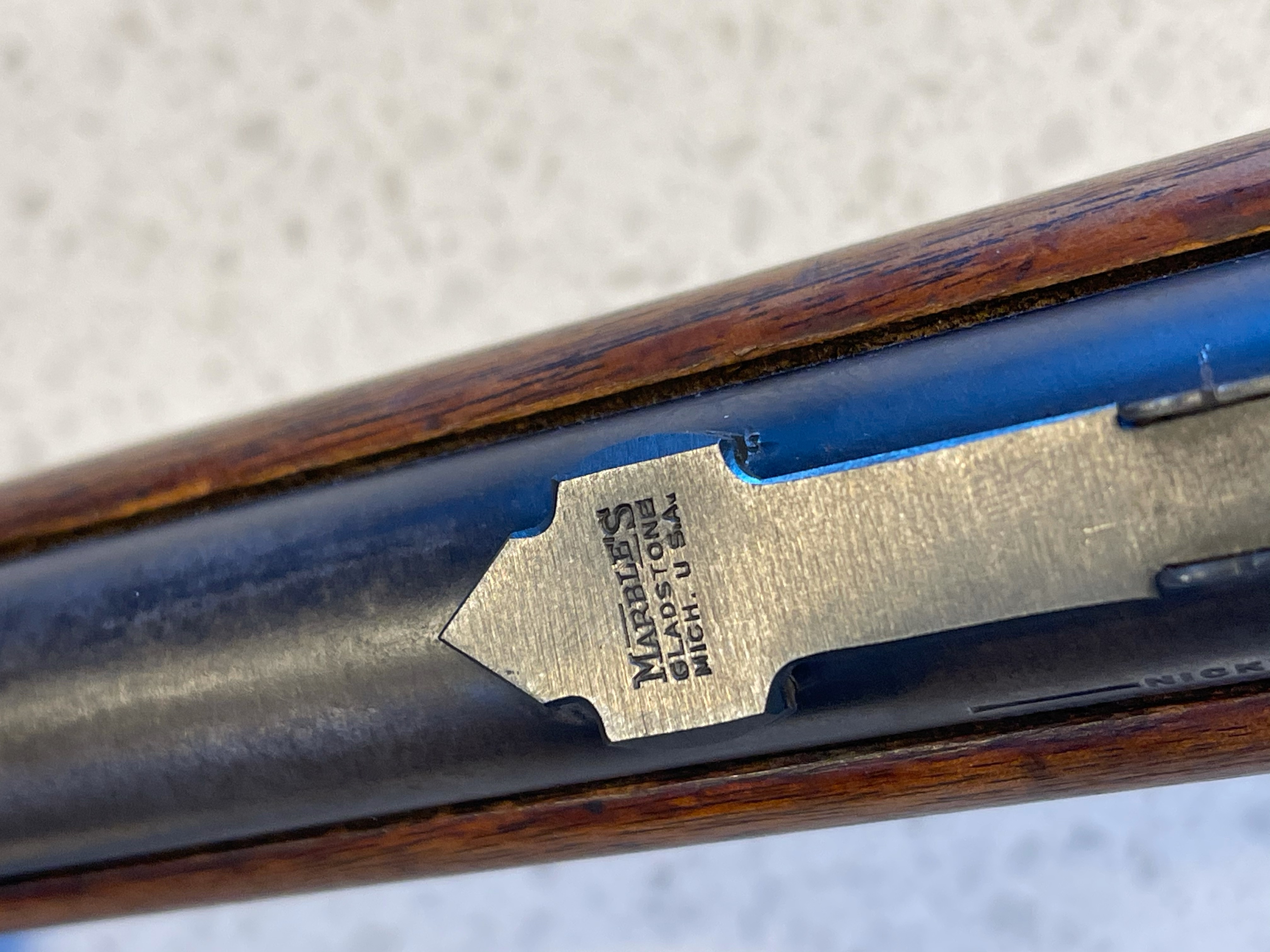

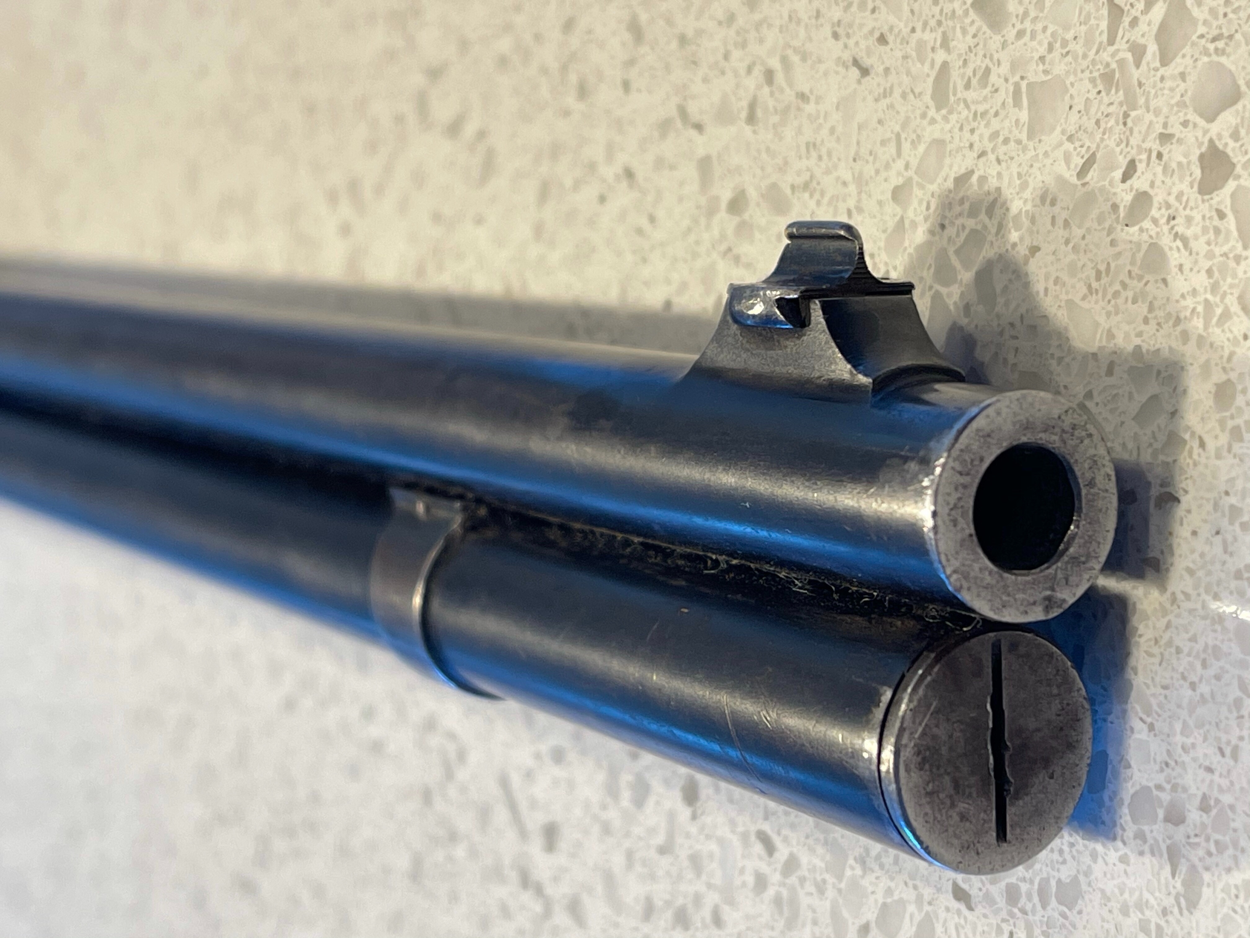

It was the entire front end… originally it was a 45-90 WCF with a 26-inch octagon barrel, full mag.  Everything forward of the receiver had to be replaced to make it a functional 33 WCF rifle.  The condition of the rifle today relegates it purely as a “shooter”.

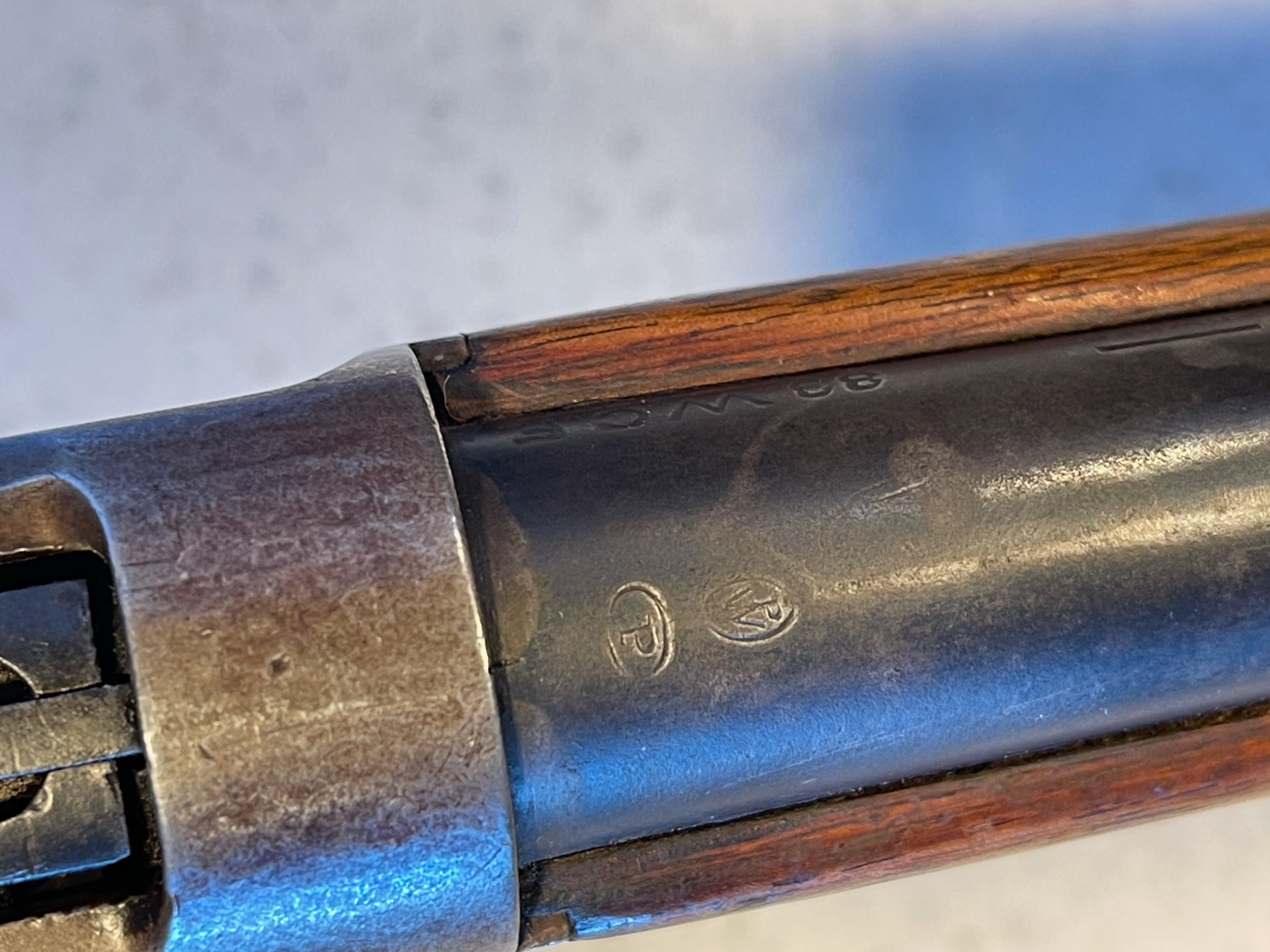

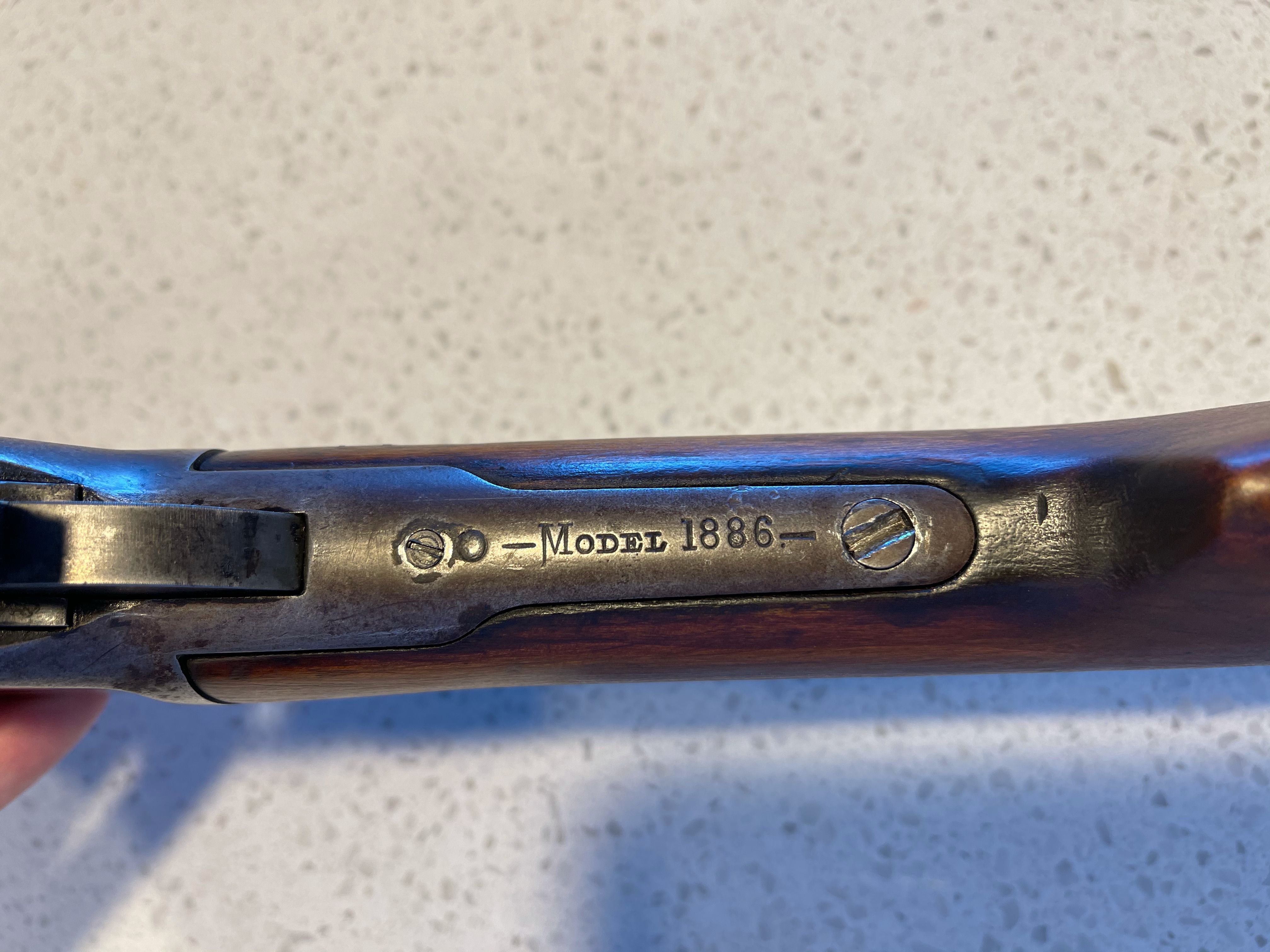

It’s probably a fine hunter and shooter but nothing here for a collector.  The only value is as a shooter.  The buttstock has been sanded and likely other problems.  The receiver has some roughness and the stock screws are quite the sight.  None of which would interfere with it as a solid using rifle.  In my opinion, the first year production serial number adds no value.

A project gun. Needs a donor rifle with a 45-90 oct barrel, mag tube, & forestock.
