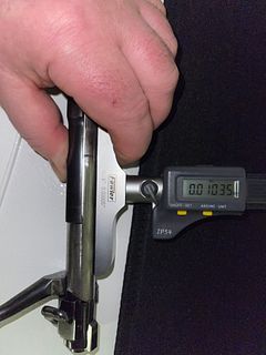

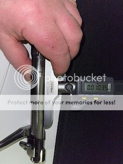

seewin said
The Hornet bolt print shows .055″ for depth.
Steve
Well this is crazy.  I am getting around .010 with my depth mic.
seewin
Forum Posts: 503
March 12, 2008
March 15, 2023 - 1:50 am
I’m sorry, I misunderstood what you were looking for. I thought you wanted the depth from the bolt face to the end of the bolt.
Steve
Steve
Ah, No problem.  Still, in person and on my photos of the bolt grind it looks much deeper than it is.

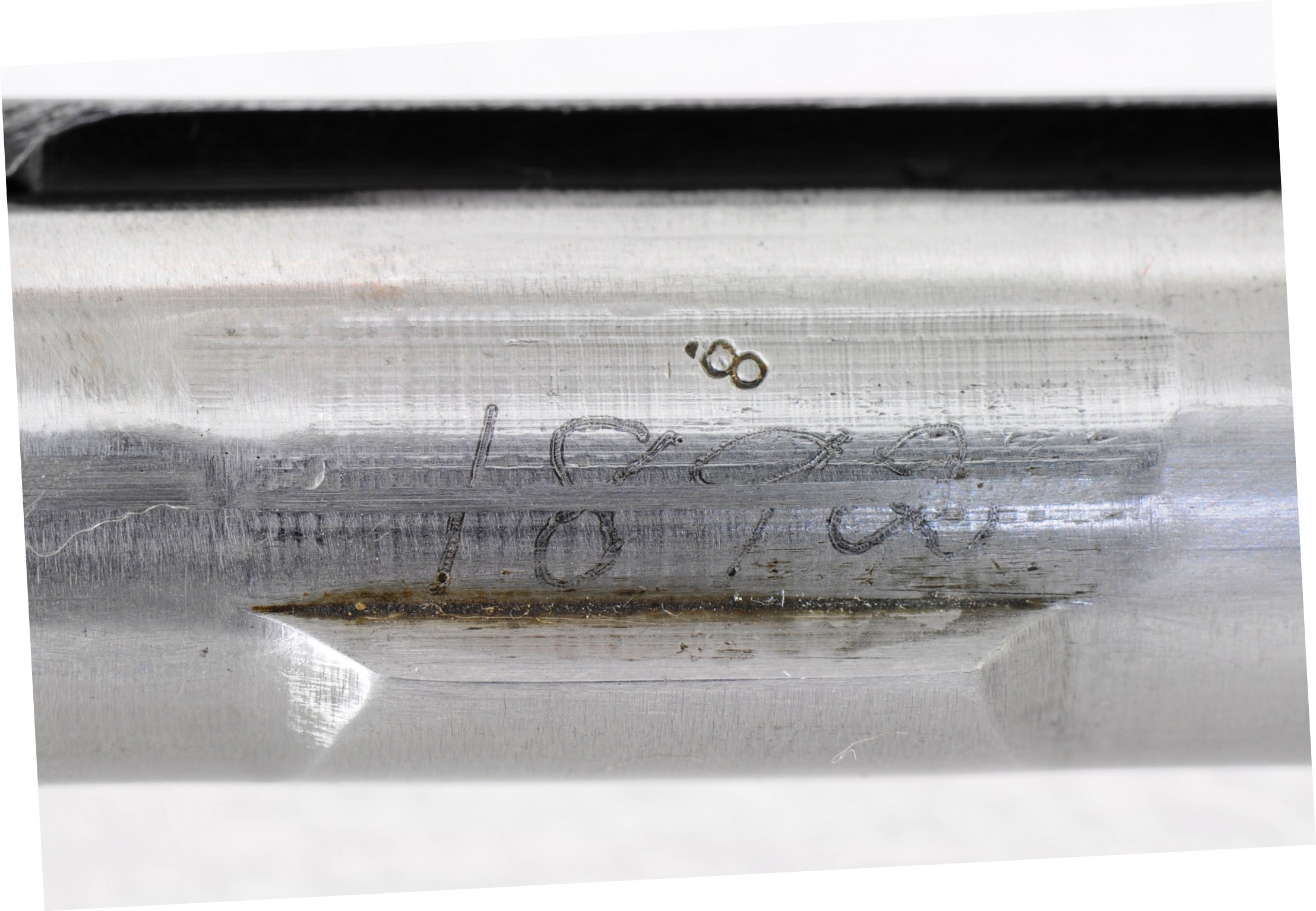

Here is one of my pre wars up close. They all vary a bit. Some very rough, some not so much.
Steve
Steve
Thanks for the reference, that’s an early serial! Based on this and the input in this thread I think I have the original bolt. Tomorrow I’ll remove the action and see what lies inside.
Forum Posts: 1962
March 15, 2023 - 12:26 pm
Steve
 I wonder if the grind area is simply a way of protecting the electric pencil numbers from wear by making the area lower. Maybe it removes surface harding and allows the marks to be deeper? T/R

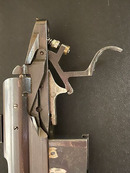

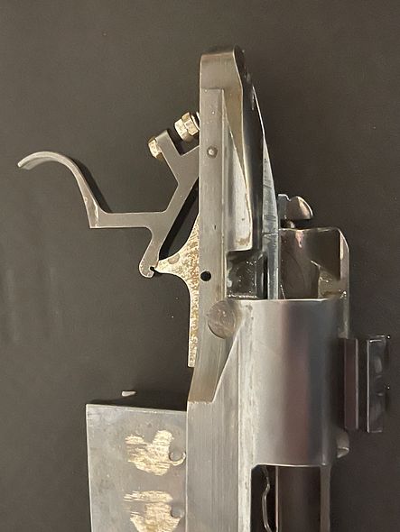

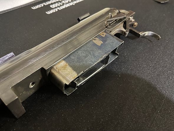

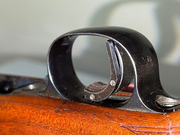

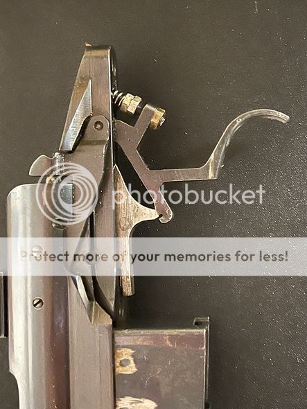

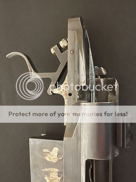

Action is out!  First lets look at the trigger.  Fortunately this is just a shoe (is that correct?) with setscrews on one side that clamps onto the trigger.
IMG_1838
Its hard to make out the first letter of the marking ?enshaw? The number is 52.
Trigger assembly pics:

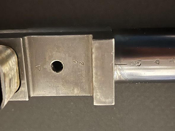

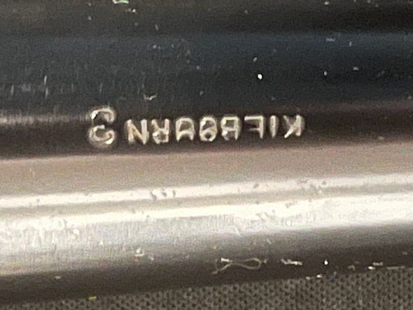

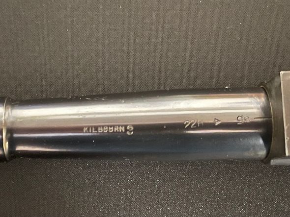

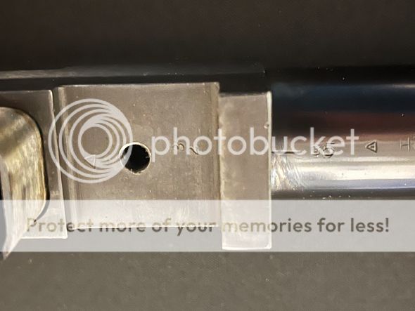

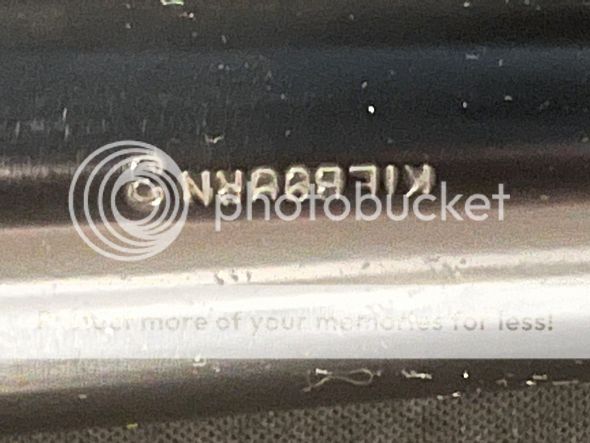

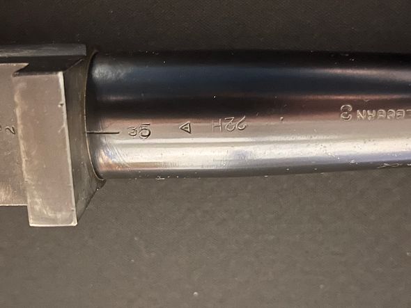

Now here is an interesting find.  At least I think it is, I am relying on the wisdom of the collectors here.
The bbl is stamped 35 meaning 1935 bbl manufacture, although they didn’t do a great job striking the 3.  What Surprised me is that Kilbourne is stamped under here too! Actually “Kilbourne 3”

March 16, 2023 - 4:11 am
IMG_1838
Yep, that is a factory trigger with a Harvey Henshaw trigger shoe. That is the reason it looked odd in your 1st pictures.
Steve

March 16, 2023 - 4:18 am
seewin said
IMG_1838
Steve
10-4.  What do you think about the bbl markings?
Marcus
seewin
Forum Posts: 503
March 12, 2008
March 16, 2023 - 4:21 am
The 35 does look strange, definitely done with 2 different stamps. It appears to me that the rifle was actually chambered by Lysle Kilbourne. That’s neat.

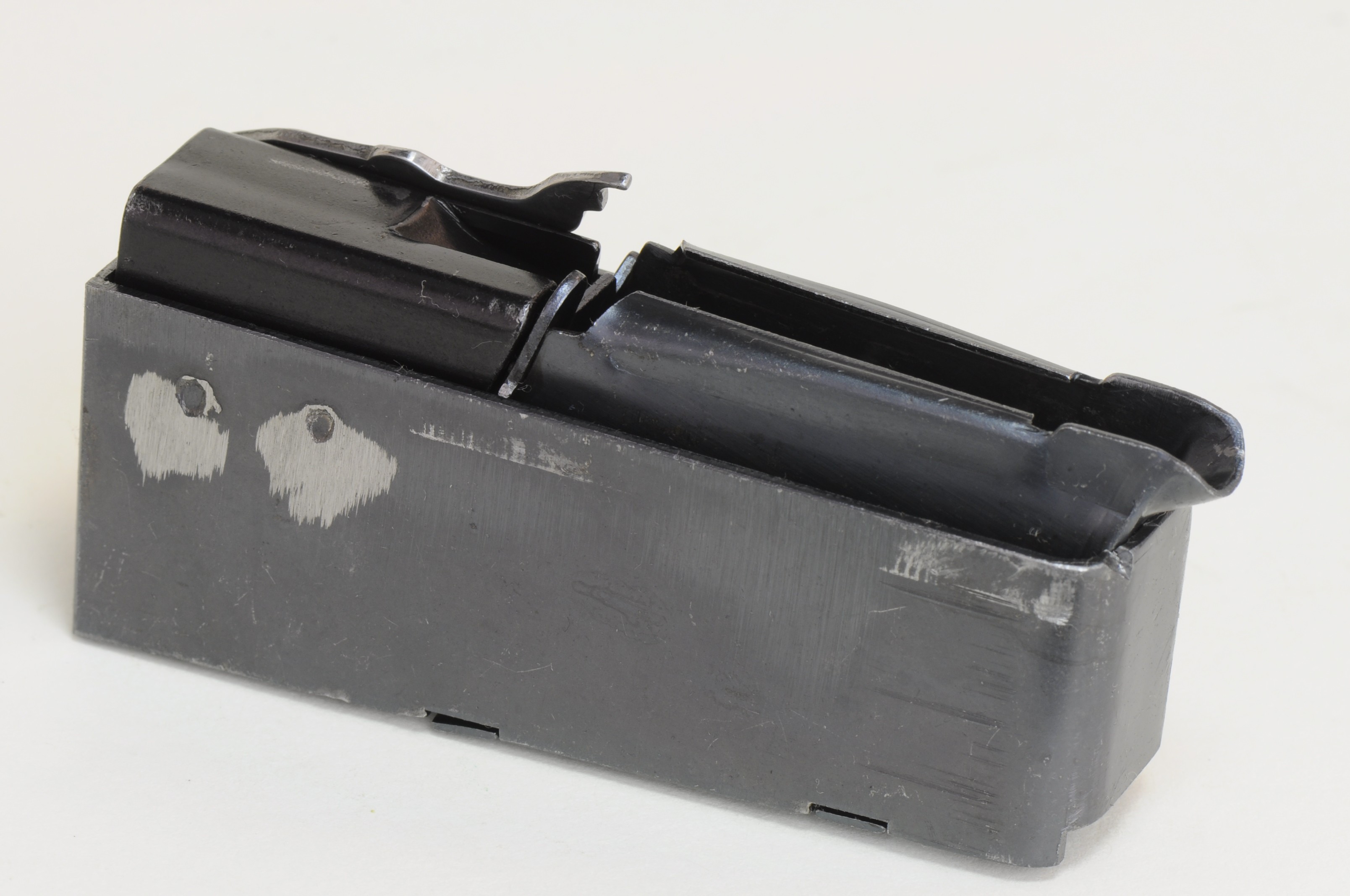

Magazine Sheet Metal question.  was it typical in the factory to grind the spot welds and front of it after bluing it?  I’m not surprised that they ground the excess expulsion from the spot welds prior to fitting, but not sure about the front, and if this was done during fitting.
Marcus
seewin
Forum Posts: 503
March 12, 2008
March 16, 2023 - 1:31 pm
I’m don’t recall seeing one ground on the front like yours, but have seen lots of them with the rivets ground. I wouldn’t be surprised if Winchester didn’t grind the front as well. That was a pretty complicated magazine with all the various parts in it.

March 16, 2023 - 2:49 pm
Steve
That is awesome!  I am thinking that too.  Is there any reference to Kilbourn that I can research?  I’m inferring that this is #3 of a group of original wildcat hornets but I’m not coming up with much on the internet.
Marcus
seewin
Forum Posts: 503
March 12, 2008
March 16, 2023 - 3:19 pm
There is tons of info out there on the K Hornet as well as the multitude of other Hornet wildcats. Seems like everyone had their own idea bettering the little gem. I know American Rifleman ran several articles on the K Hornets and Kilbourne in the 40’s. I have several vintage books as well on the cartridge and its design, but very little on the man himself. As I recall he was from New York and developed some other K cartridges as well. There were actually 3 versions of the K Hornet, the Junior and one other that I don’t recall the name.
Steve
37
March 16, 2023 - 4:30 pm
Marcus Tillius said   Is there any reference to Kilbourn that I can research?
Short chapter on K in Practical Dope on the .22, by F. C. Ness, but no bio.  Lived in Whitesboro, NY, but he was only one of many wildcat gunsmiths “improving” factory cartridges during the ’30s & ’40s, so really no great “celebrity.”
